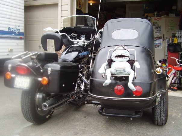

your rig looks very good,..and has more "getty-up" then my little 800cc twin,..enjoy it and don't be afraid to use the gear box options when not on the open highway,..it should work well for ya,..those ol 4cyls are bullet proof...very nice, crawf.

Thanks craef, I'm working the bugs out and it's running stonger all the time. My last bike was a vtx 1300 and it's been a while since i've ridden an inline four engine. the inline four gets it's torque at much higher rpm range.
BTW, I see your running a friendship one sidecar. I have the same top but I'm missing the support bar.

thanx, my poor ol girl needs some love tho,..the support is simple tubing 16" high, by about 20.5" wide,..could be fabd from counduit quickly enough...good luck, crawf.

looks good, thanks for the dimensions Crawf.

no problem Jim,..if need be , e mail me privately and I'll have the wife take some better shots and post them to you as and my new computer/camera situation is still being learned,..as mentioned 1/2" conduit in a u shape is all it is,..cheers, crawf.
