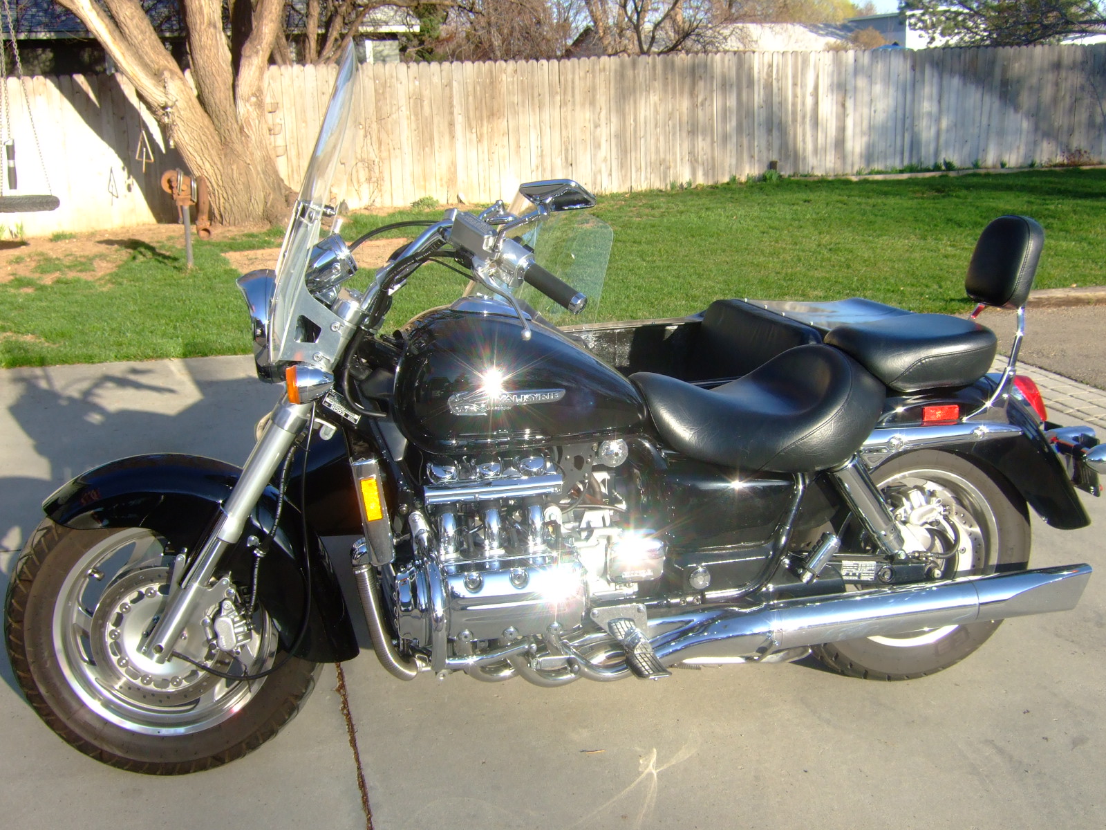

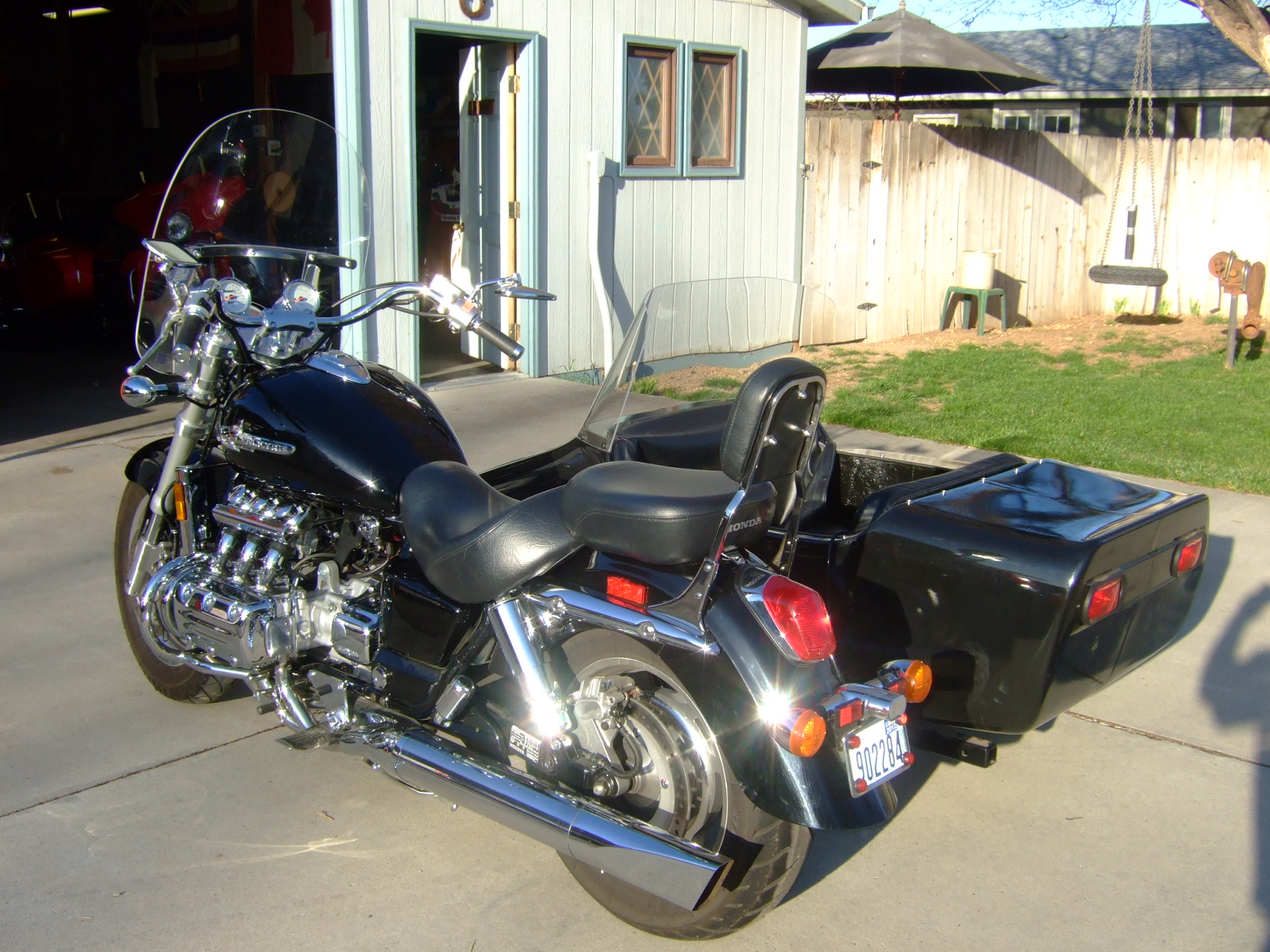

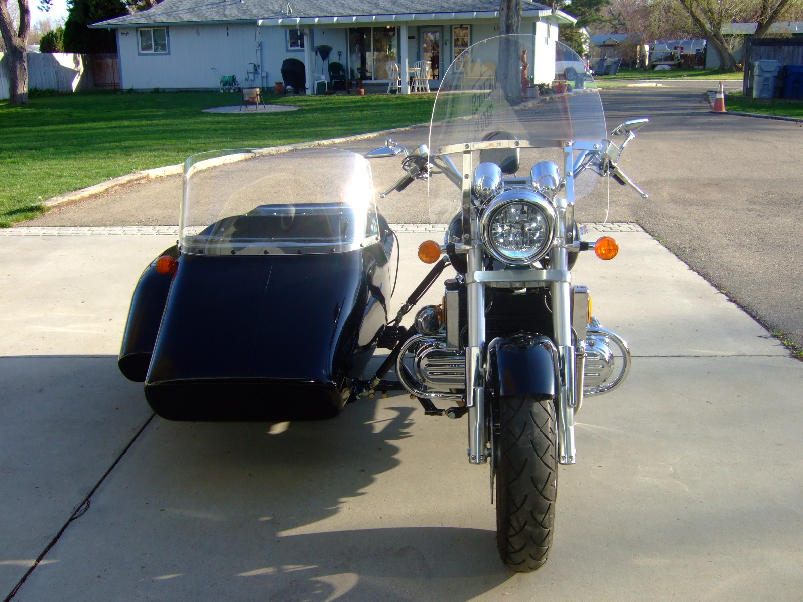

A 1500 Valkyrie would fit the bill for a big strong naked bike. I just mounted one with a Kenna Doublewide and I'm very impressed with the raw power that's available.

Lonnie, I have had several Valks. Put 82,000 miles on one of them in a year. I'm in the Deep South and a Valkyrie gets mighty hot in the summertime. It also has a very large amount of trail. Used ones are beginning to be affordable, except for the gas mileage. Some sort of steering device with the sidecar is almost mandatory.
Ray
Posted : May 16, 2012 4:58 pm
I didn't notice a steering difficulty with the wide bars, but I would definitely have reduced trail if I owned one with a hack. And they are gas hogs.
