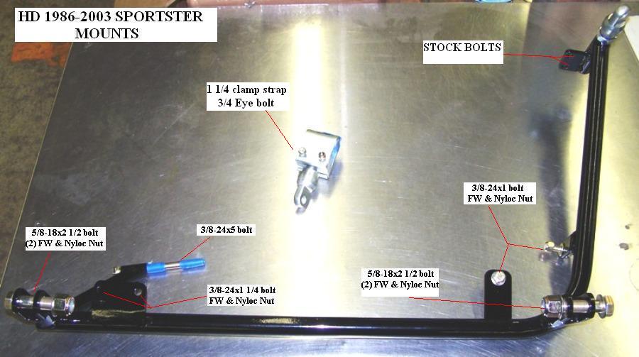

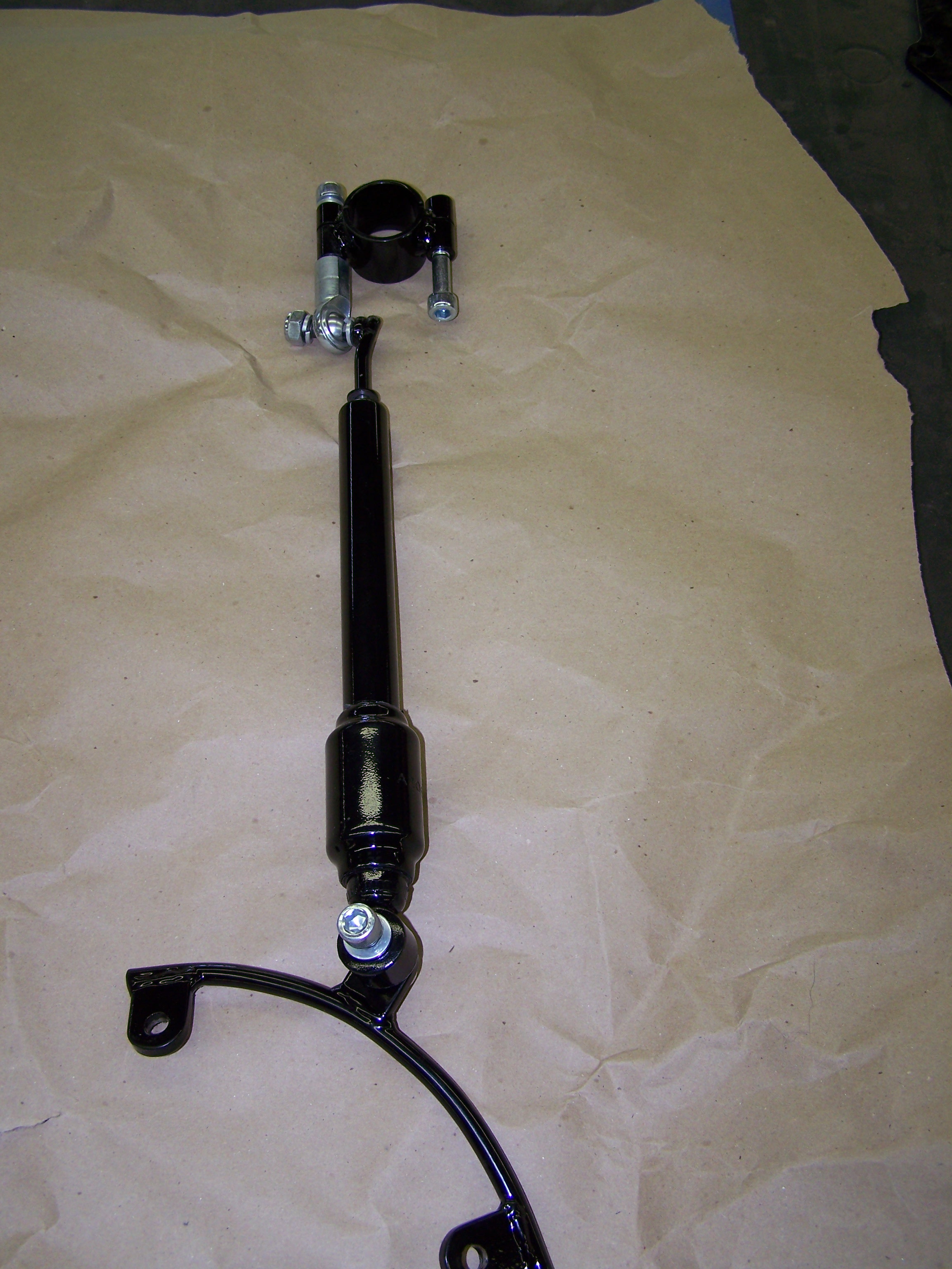

We make a mounting kit that will give you all 4 mounting points on the bike. We also make a damper kit for your bike and sidecar.
Posted : August 8, 2012 12:30 pm
Here is a photo of our mounting kit. The main sub frame attaches to the bike at 7 points. We also have "raked" triple tree's for your Sportster.
Posted : August 8, 2012 12:36 pm

Hello Jay.
Thanks for the info about your sidecar mounting hardware kit for my neighbor's '03 Sportster.
I printed the pictures of the kit for him.
With expenses in mind, he is interested in an off-the-shelf item as opposed to a custom build dedicated kit.
Are there any modifications to the bike in order to adapt your hardware kit?
Will your hardware kit readily accommodate and align with the Liberty frame and its mounting components?

The mounts on most bikes require no changes to the bike. Harley it would seem has a couple of different frame jigs. One hole may or may not be 1/2 a hole off due to this. If it is you will need to drill out one hole other wise nothing else is done. We have not used these mounts with the Liberty Sporster sidecar, We have only had one of these sidecars in our shop in the past and we mounted it onto a BMW. The one we had used 5/8 inch hiem joints on the bottom and had enough adjustment to line up with out mounts.
