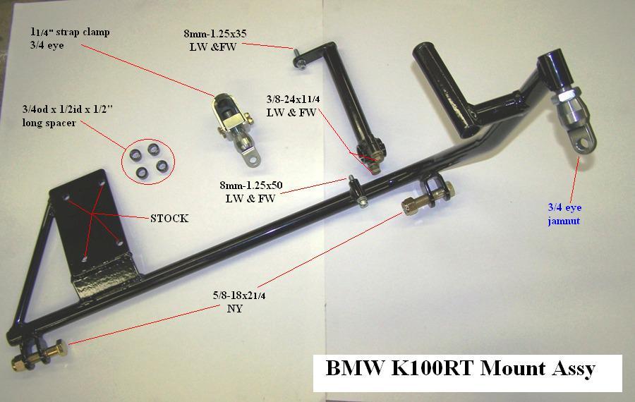

We make a mounting kit for the K100 that gives you all 4 mounting points, We also make a leading link front end for this bike. The mounting kit replaces the center stand and attaches to the engine as well as the upper crash bar mount.
