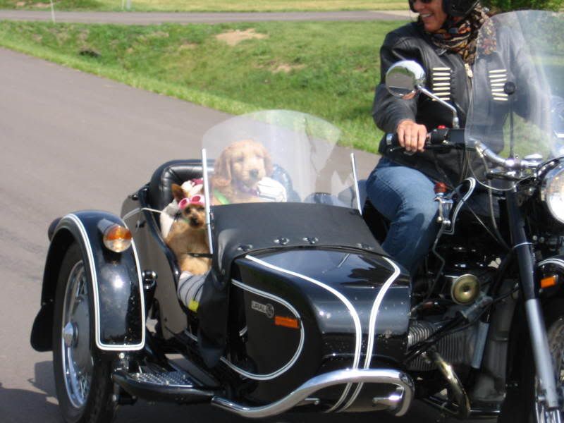

Hi there! I'm a new rider too, and we're doing the sidecar thing for my daughter who is disabled AND for our dogs! LOL My husband thought the sidecar thing was a temporary obsession, but he's now realized once he gives me an inch, I'm going 100 miles. LOL
We haven't gotten our sidecar yet, (it's in the works) but we'll have a 5 pt harness in it for my daughter. We'll use that to attach a harness for the dog(s) as well. The same one you'd use for your dog in the car. And don't forget doggles!!!! Eye protection for your dogs is really important.
I breed dogs, and one of my puppy families sent me this picture the day after they picked up their puppy. The little one is a yorkie rescue, and the bigger one is the 8 week old pup they bought from me.
Photo Sharing and Video Hosting at Photobucket
