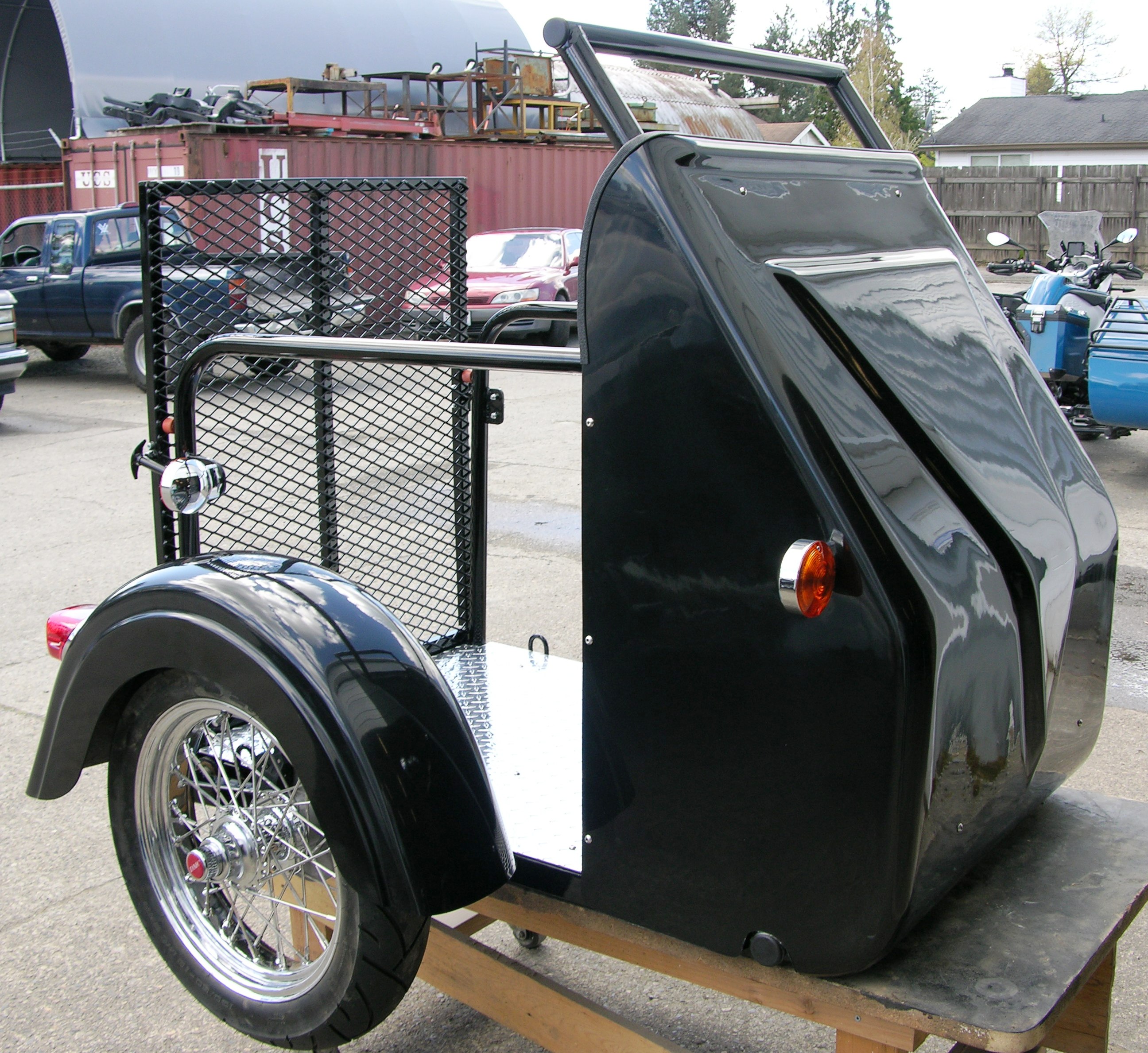

Also, you have to set the rigs differently due to the crown of the road being backwards to normal. We only do left side mount sidecars when we are doing wheel chair sidecars where the person will be operating the motorcycle from the sidecar. We do make left side mount sidecars that we ship to the UK, Japan, Australia and New Zealand.

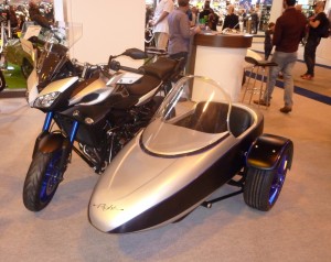

I dialed up the Watsonian UK site and saw the news release posted last fall for a new model introduction. And, well, imagination overcame reality.
The model is called the "Flight". It's low sleek and simple. They offer a specific mounting to the Yamaha FJ-09; mounted on the left.
The left hand mount would be hard to live with, even in town.
I have become tired of the complexity of the Old Wing tug for the California I. I've enjoyed the rig around town more than on the road, preferring to ride two wheels long distance.
This looked like a nice combination of middleweight and style. Perhaps a right hand option will be available someday.,

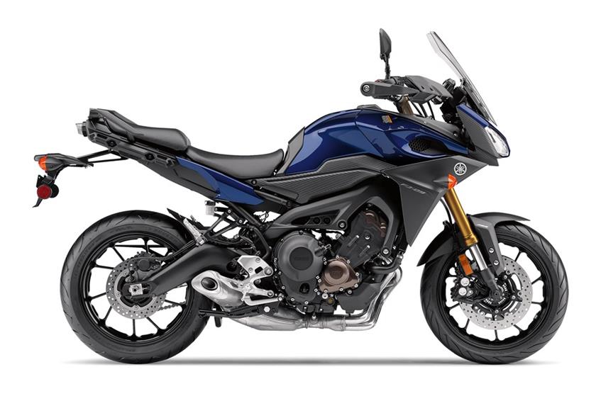

Looking over the combination of FJ-09 and the Flight I find one other issue.
The FJ-09 has the exhaust low, centered, and on the right hand side. It would blast noise and fumes directly at the passenger in the hack.

We make a wheel chair sidecar that we can add hand controls to.
