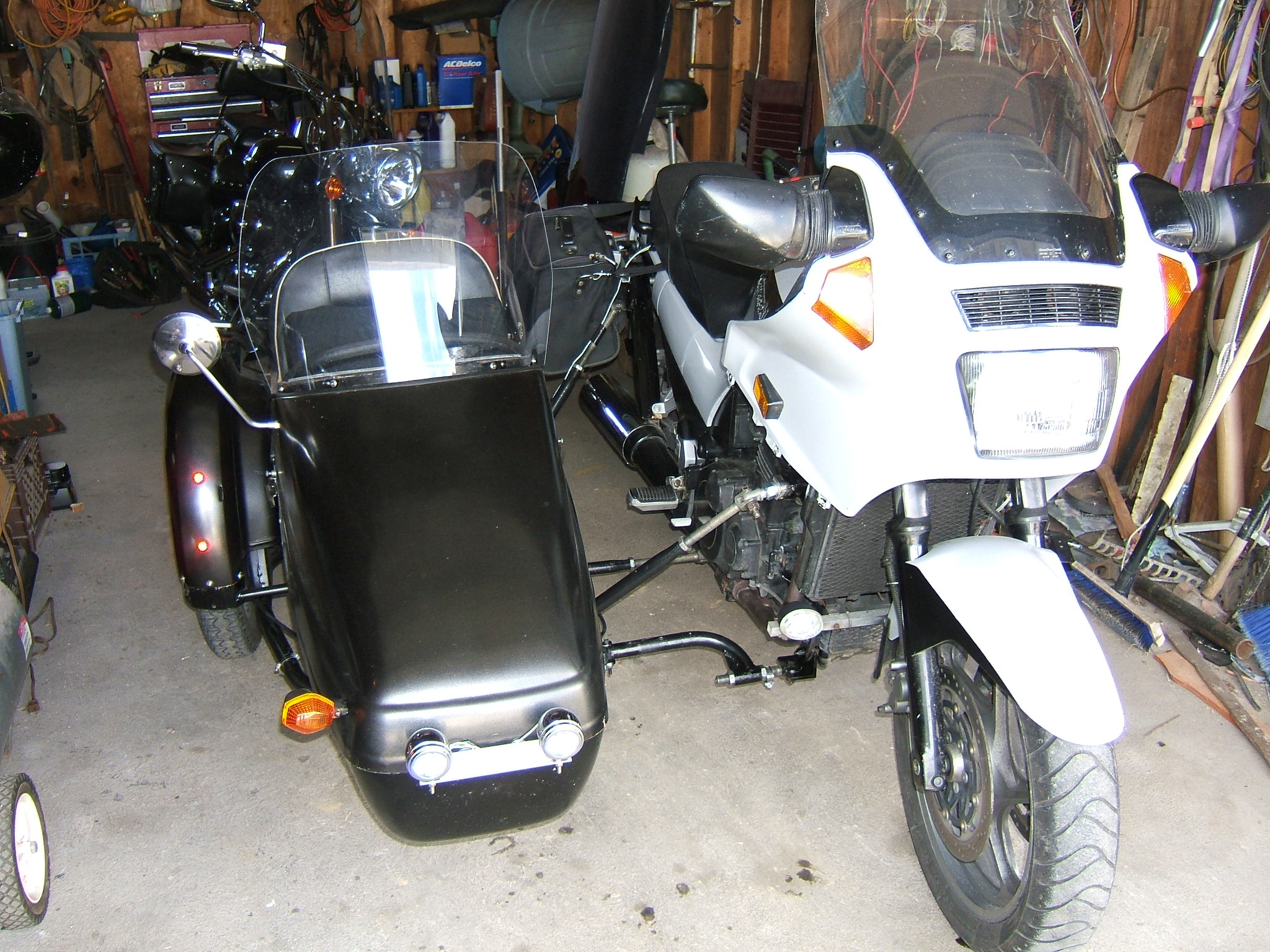

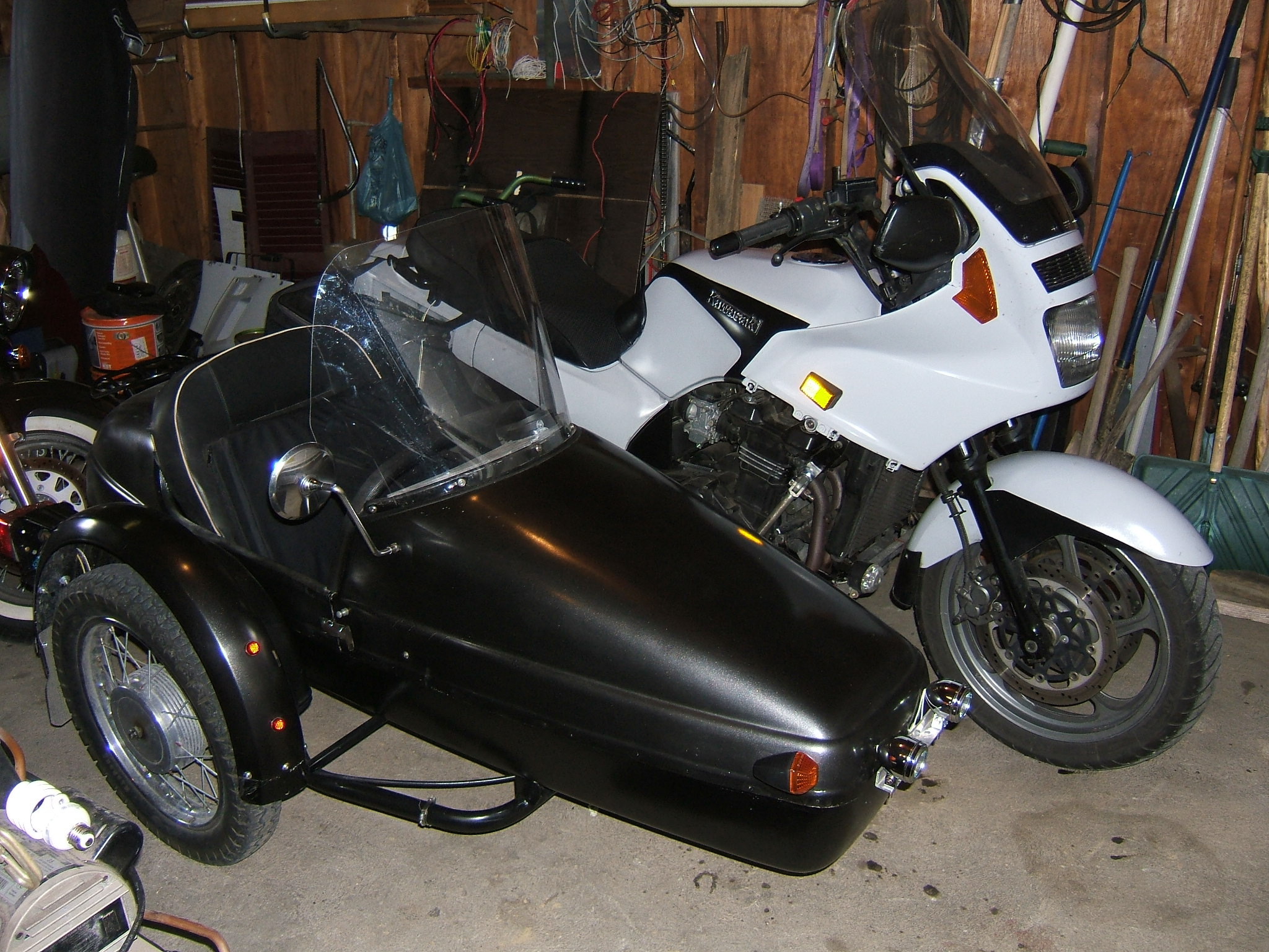

Added/moved from Suzuki cruiser to my Kawa Concours C10
I like the sitting position much better on the C10 not sitting on your tailbone all day.
May need to address the heavy steering, but otherwise it handles fine.

As with most, if there isn't weight in the car or on the frame it will come up, especially on right hand turns. Doesn't seem any worse than the cruiser it was originally on.
Right now the front suspension on the Connie is too soft. I get quite a bit of lift when getting on it pretty strongly. I'm going to go to a heavier fork oil until I maybe get a leading fork. Otherwise it runs true and straight with 12 inches wheel lead (more than I wanted, but location of rear mounts caused that) and 2 1/4 tow in.

This car is way to small and light duty for a safe match up on this bike. 12 inches of wheel lead is far to much and 2 1/4 inch toe in is way, way to much. It is handling "ok" only as it is scrubing tires bad. Just becouse you can put a sidecar on a bike does not mean you should. It might go down the road "OK" but what happens if you have to manver hard, you do not have much if any saftey margin. Safety must come first, In this case safety came last. "universal" mounts usualy are a bad idea, Having to run 12 inches of wheel lead due to not having adjustment in the mounts does not mean go ahead and run 12 inches of wheel lead, it means you must modify the mounting hardware to get the wheel lead correct.

When a sidecar is to light duty for a bike, It does not leave much of a saftey margin should things go bad on the road. I know of at least one person who is now dead as a dealer installed one of these sidecars on an 1100cc Moto Guzzi. Yes you can add ballist but the frame, wheel and axle are only are not really up to a heavy bike, remember these sidecars were developed for a 350cc two stroke Jawa. Yes, Velorex did come out with some heavier duty sidecars and up graded the axle from a 15mm which is known to fail to a 20mm axle . They did add a stiffener to the frame but did so in a stupid mannor so that they could keep their know to slip "universal" rear frame clamp. They have gone to a stiffer shock which all helps. This assumes that your sidecar is one of the up graded "heavy duty" ones. They still only have a small drum brake that does not play well with modern disk brake bikes so most people end up not hooking up the brake. I feel that it is dumb not to have a brake on the sidecar when ever possilbe. Even if a brake only once gives you better control over the rig and keeps you from hitting some thing, that one time is worth all of the cost and effort to have a brake. As Velorex insists on going with "universal" type mounts rather then developing bike specific mounts their mounts are known to slip and as such people end up riding rigs that are out of aligment. Also as they do not provide a proper way to adjust wheel lead as you found out as such more often then not you end up with the wrong amount of wheel lead so you also end up with a rig that does not handle as well as it should and as such, if the rig does not handles as good as it can or should, you are riding a rig that is not as safe as it could or should be. For not much different money a person can buy an American made sidecar that does not have "universal" type mounts for any of a half dozen or so American companies and end up with a much better handling rig made on a much more robust frame leaving a much larger saftey margin.
The Velorex is a great little sidecar for LITTLE bikes, if you do not use the scrap metal they call mounting hardware they work out fine. I owned one my self for a while, loved the rig, it was a factory built MZ silverstarr Gespan which is a 500cc single. The Velorex was a good match but still even on this rig required 50lbs of ballist.

The Tour model sidecars are not like the one shown in the first post. Triple tube frames and many upgrades, different suspension with correct leveraged swing arm 20mm axle with wide spoke Italian chrome wheel and a 130/90/16 tire. They still use the old over engineered sliding rear lower clamp though. They must still have a lot of them in the storehouse. At 174# this is still a lighter sidecar and not a match for the dressers or heavy cruisers.
The one pictured in the frist post? That is an early 562/03 The Economy model (562E) with 15mm axle and super light suspension a 154# unit built for the JAWA 350cc and 500cc models. 300# plus bikes.
