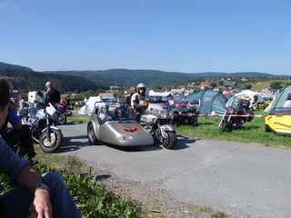

I agree with you completely. I have changed my red GL 1800 / 01 after 75.000 km solo driving into a stream-silver
GL 1800 with an EML GT 2001 sidehack 2 years ago and have proved it now for nearly 35.000 km riding thru whole Europe.

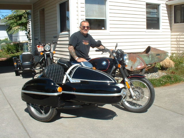

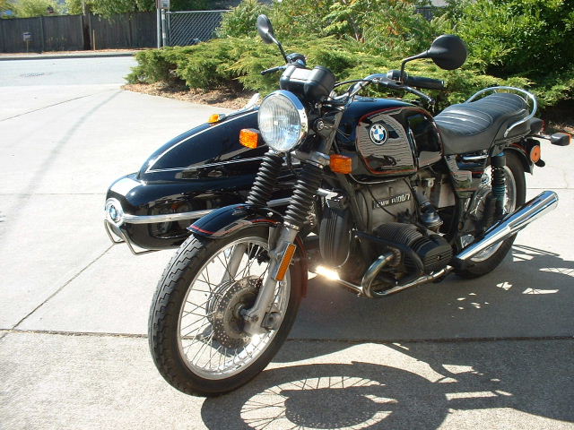

BTW: It is very interesting to see you from the other side of the pond sitting on a BMW sidecar but it fits you very well. What type of rig is it ??

Arrival at EGT 2008
My arrivial on the camp ground at EURO SIDECAR RALLEY 2008 with my wife Nanny and grandson Elias in the sidecar.

The sidecar combo you mention is a 1977 BMW R100/7 with a 1971 Jawa 560 Velorex sidecar. After completion this rig was shipped to a member of the US Army Corps of Engineers in Seoul, Korea.
FYI: Our page on the Sidecar Industry Council site is informational only.
