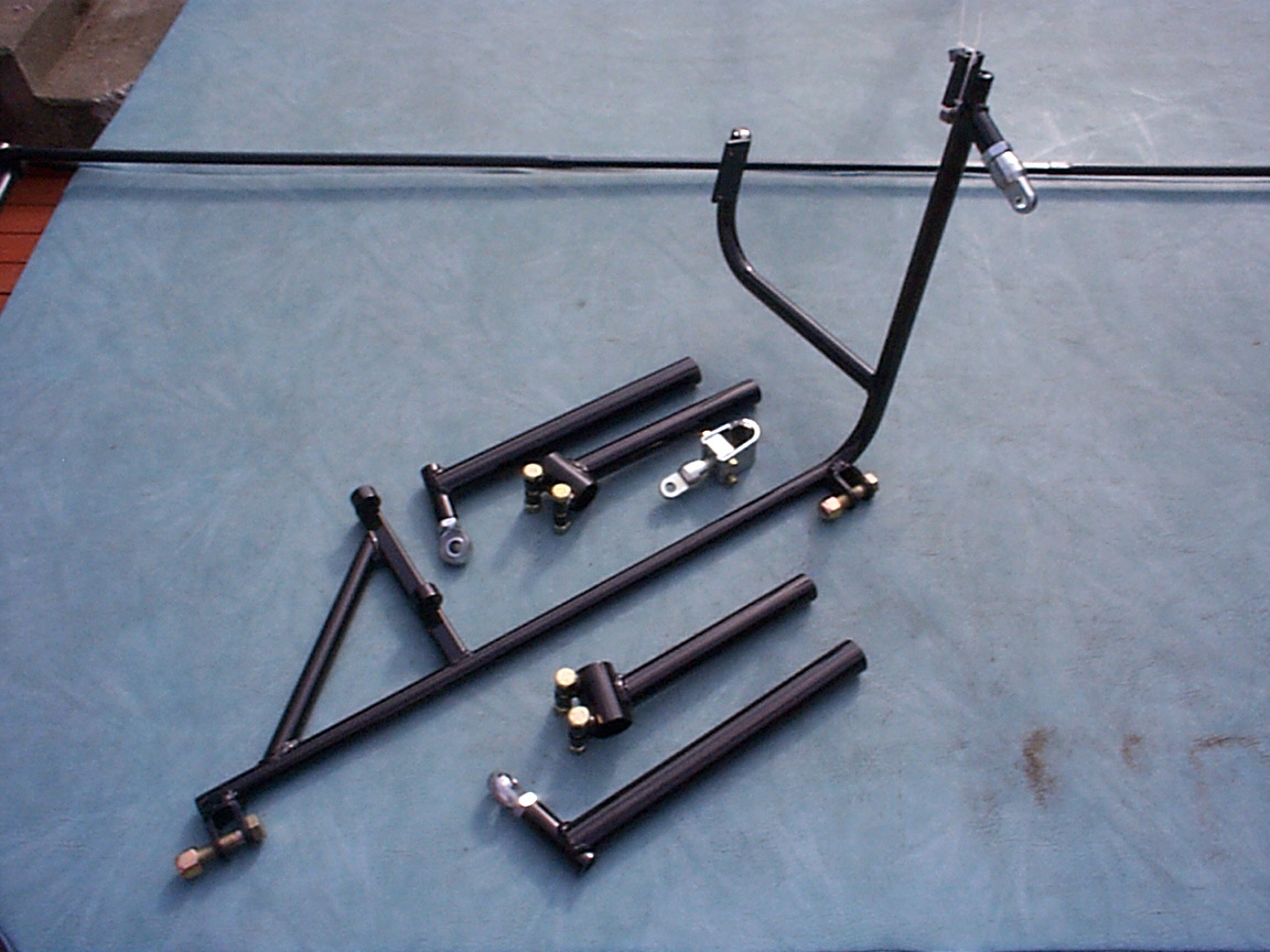

Your 600 Shadow will work fine with the hitchhiker. We've mounted several URALS and Dneprs to them with good results and the HitchHiker is about 100# lighter than the URAL Classic.

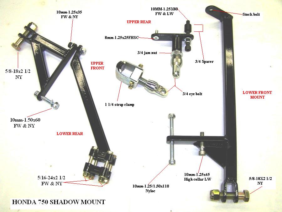

Sorry, I do not have photo's. I would recomend not using a bunch of "universal" type frame clamps.
I have attached how we do it on the 750 shadow.
