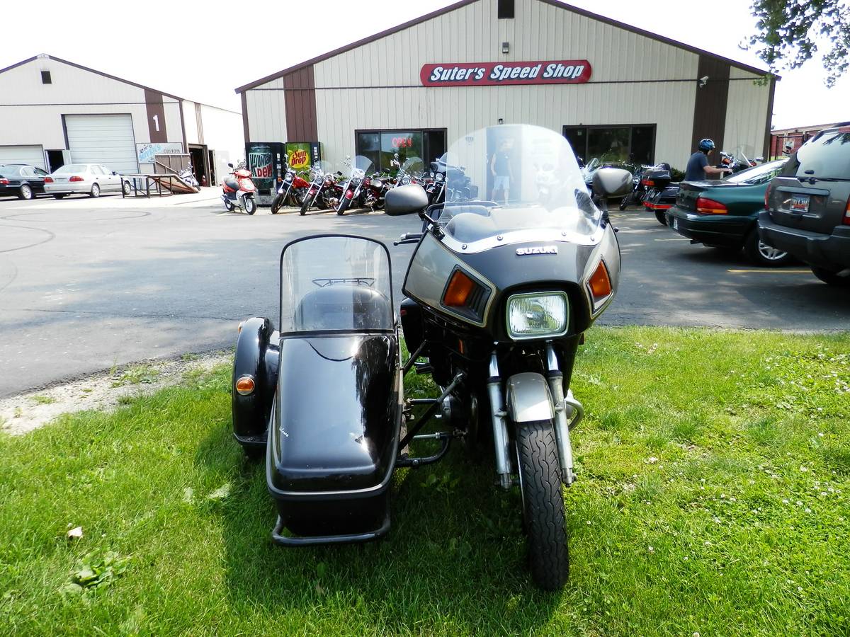

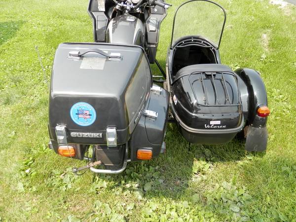

The 2nd is a complete rig - 1984 GS1100 Suzuki w/ Velorex car. They know nothing about the car, the bike has only 35K on the odometer. The blue book on the bike is about $1800 - he's got a $4K price on it. Can anyone tell what year the car is or model from the only 2 decent pics he had w/ the car? Assuming the car is in good shape - what's a decent price for a 32 year old rig? My thought was to get the old bike as a "trainer" and if I like having the sidecar, and don't kill myself learning - put one on my Venture and sell the Suzuki. Assuming I don't wreck it learning to drive a rig w/ car - what's a decent price I could re-sell it for? Pics of that included, too - I hope. (not sure how to insert pics on this forum)

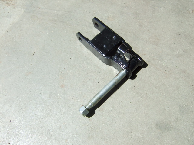

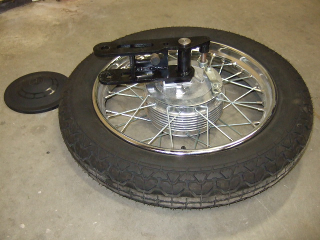

2005 was the changeover year for the suspension. Most all of the 2005 models had upgraded suspension designed to support later model cruiser bikes.
They had a longer swing-arm with modified shock position and 20mm axles (I'm attaching a pic of the new factory HD suspension).
The earlier models had suspension designed to support the 300#plus Jawa and MZ Motorcycles (Attached pic of early swingarm and 15mm axle).

The Velorex mounted on the Suzuki is either a 562 Standard or a 562 Cruiser. The Standard has the short swing-arm and 15mm axle, the cruiser has the upgraded suspension.
Attachments are available for most bikes.

Great info, thanks for the help. Looking at the pic of the 20mm - I see a bolt behind the axle (r of the axle in the pic) - is that where the shock attaches? So could look for the shock attachment as a quick way to distinguish the between them?
