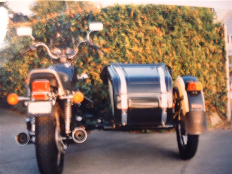

Mark makes some good points. Many bikes out there that will serve the purpose very well as a good dirt road runner without being a full on dual sport machine. Many of these can be upgraded to handle even rougher stuff if the need rises. To run dirt roads and just about anything short of the real knarly stuff a full on dual sport bike for a tug is not needed.
The rigs based on true dual sport bikes are nice for what they are but are not the best handlers on many surfaces.
Many an off road rig has been based on various street bikes and they do very well. I know our one XS1100 based rig probably saw as many miles on dirt as it did on pavement. It was a terror on typical fire roads and loved to be slid around at apeed. No way would a typical dual sport bike based rig come close to running with it under those conditions. There are many other examples of these type rigs and they do very well.

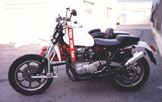

See attached for picture of a clean full tilt XS650 based rig.

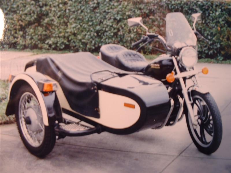

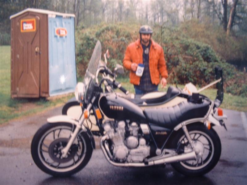

Here's a rig that worked very well for me a few years ago.
A 1983 Yamaha XS650 with URAL Bavarian Classic sidecar. With me (180#'s) and a 140# monkey aboard we ran the Bonehead Enduro out of Snoqualmie, WA which uses newer and older forestry roads, creek beds and trails (fit for solo bikes) and ends as far above the snow line as any of the participants can go. My rig (Oldest driver) got up into the snow zone about 50 yards farther than any other sidehack rig including several URAL Patrols with 2 wheel drive and knobbies all around. Two of the URAL outfits were piloted by the URAL, America team.
On the Bonehead Enduro there are 5 "bones" to be picked up to complete the run . You get loose directions to the first "Bone", which is located in a hidden place off road and must take the one that has your registration # on it. That "Bone" has the directions to the next "Bone location and so on.
This event is sponsored by the Vintage Motorcycle Club and has loose rules that state that the bike must be pre-1970 or the rider must be pre 1946.
This bike was bone stock with better rear shocks and higher viscosity fork oil and Metzeler street tires. The only drawback was the smaller fuel tank and 29mpg range. I added a 10L gas can later.
Pix show the rig, my monkey "Scotty" at the Loo and muddy me going in for a cold beer after the run.

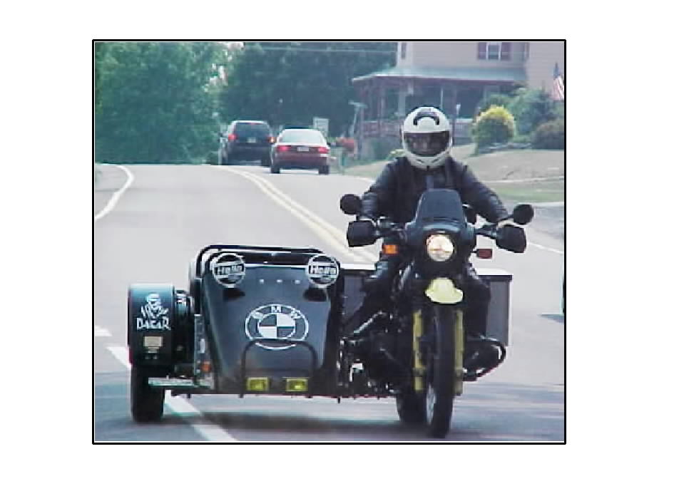

Attached in a picture of a rig we did from scratch a while back based on a R100GS. This one was a double wide to carry two kids in it but was still a lot of fun.
Posted : November 29, 2007 11:06 pm

Awesome Claude. Do you have any more photos? Who made the car? Have you had any experience making a Dneper or Ural wider? My 7 year old boy and his friends are getting too big to ride side by side.
Posted : November 30, 2007 3:36 am

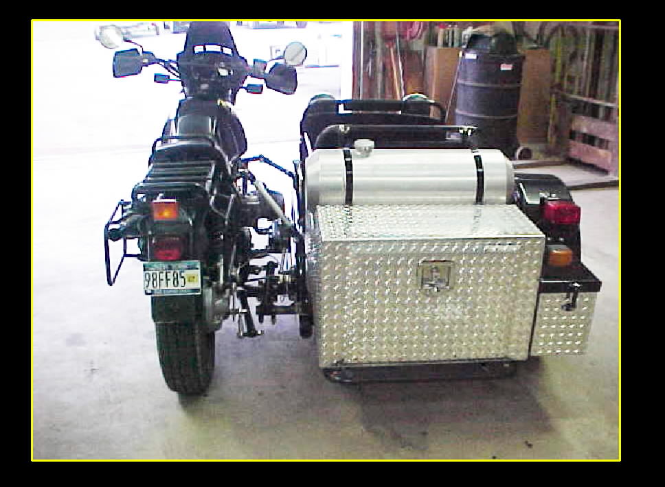

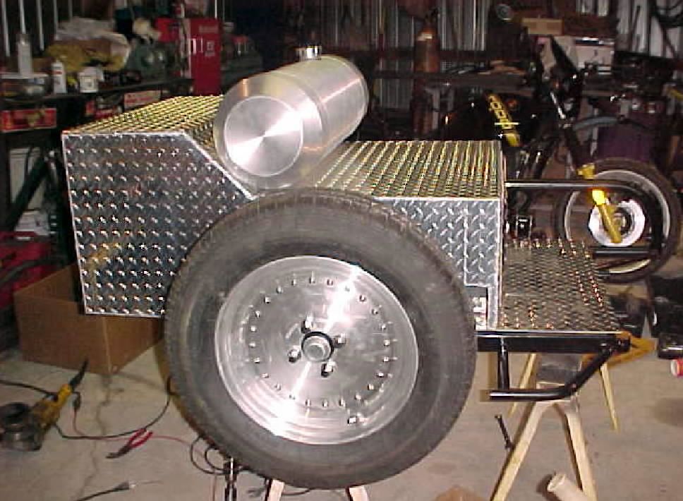

We made the sidecar in the shop from scratch. It had a swaybar, torsion bar suspension , braked sidecar wheel linked into the rear of the bike. (The bike had to be converted to a disc rear from a drum brake), 10 gallon auxillary fuel tank. mucho storage under seat and a few other things.
I have attached a picture of the box and fuel tank mentioned above when under construction.The seat sits on the box in front of the fuel tank.There is also a rear view of the rig. The box had a lockable door in the front and rear of it.
Oh, please excuse the clutter in these pictures. They were taken in the 20 x 20 shed we worked in prior to moving into our present 40x100 shop. Yes, we still have clutter though...lol.
Thi stype of rig can also be done in a single wide version which is probably more practical under many conditions off road.
As far a widening a Ural or Ural type sidecar it could be done with minimal effort. The Ural would be mor einvolved due to the trunk than say a Dnepr.
You may be ahead by just fabricating a new body though..or maybe not.

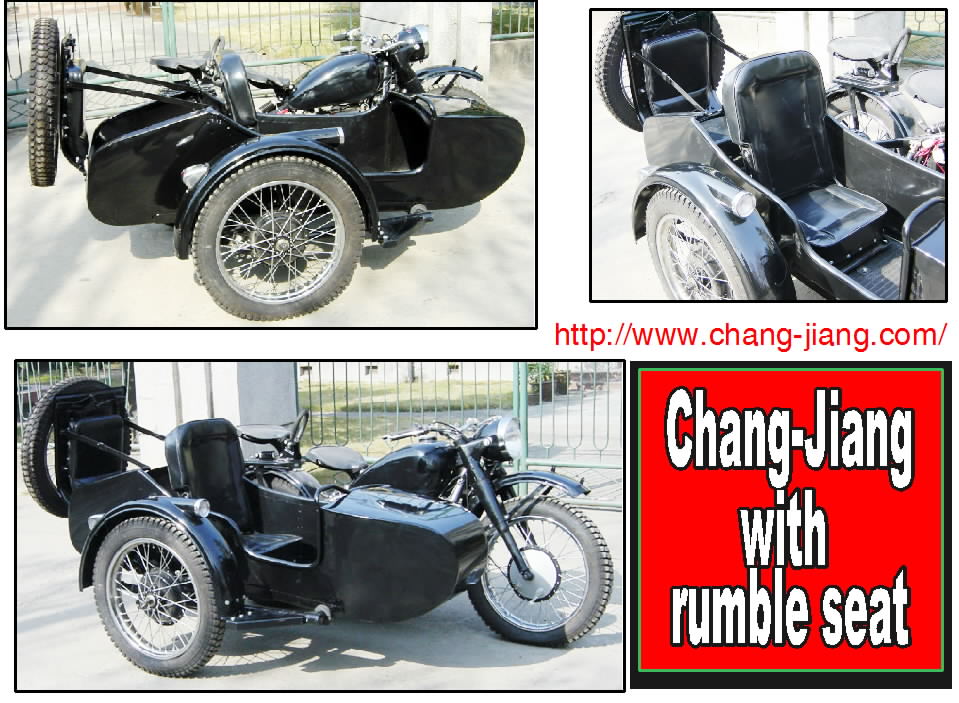

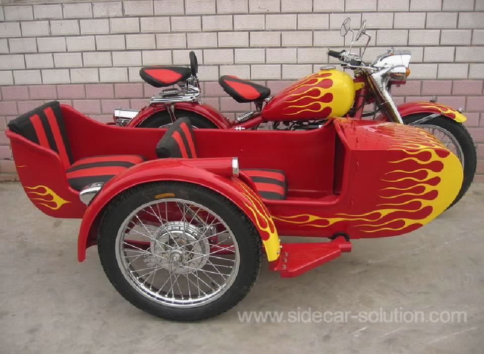

Another option would be to lengthen the body and put one seat behind the other. Note that more body support WILL be required either internally or externally. I have attached a picture of a chaing done this way. No we didn;t build that one :-).
Posted : November 30, 2007 12:57 pm

As far as the rumble seat idea it has been done. See attached picture of a Chaing conversion. Pretty tight quarters i'd say.

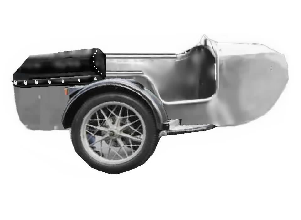

I have also included a mockup picture of a modified Dnepr sidecar body.It has a tonneau cover on the rear. The idea was to have the option for a seat back there of just storage.
