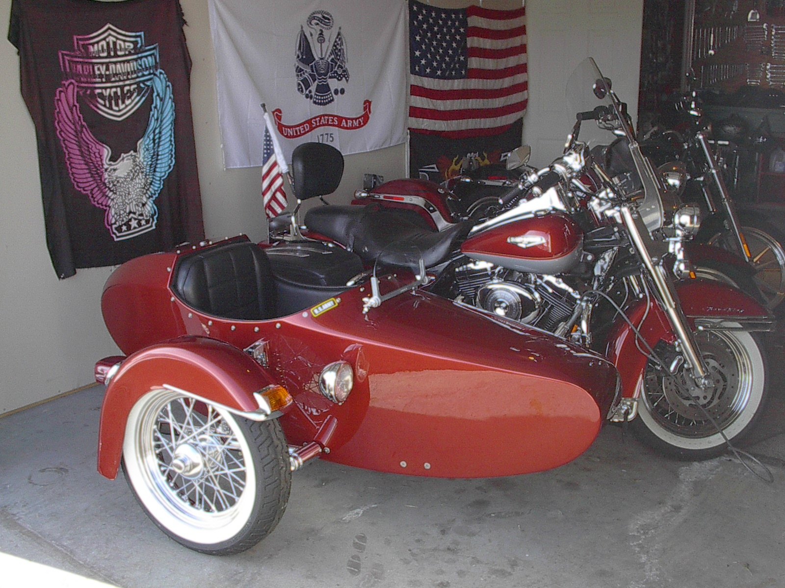

Good day, I installed a Motorvation Spyder on my brothers 2000 Road King a couple of years ago. The combination made a beautiful and pleasant handeling rig. My brother also has some physical limitations that dont allow him to ride his new fat boy all the time so the Road King gets a lot of use. Talk to Mary at Motorvation, she is great to work with and will send you literature very quickly. I will send you pictures of my brothers rig. Send me your e-mail address
