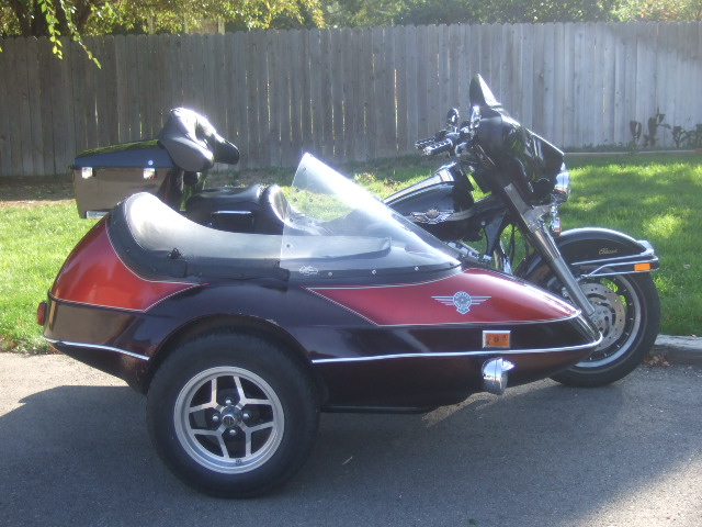

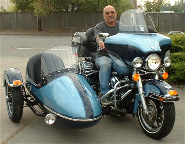

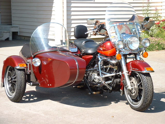

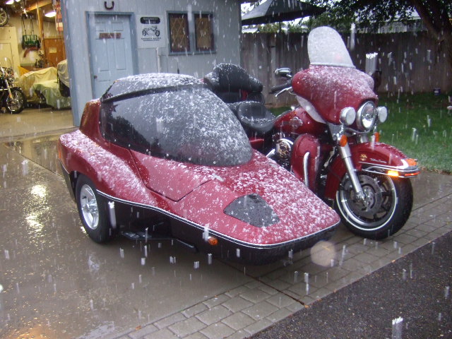

Attached are a few options.

Lonnie, your attachment 03FLHT-EARLT FSI4 sidecar looks like the California Sidecar (different paint and no right side headlight) attached to the rig we bought last year. When I contacted CSC for information with the serial number (CSC101038) to find out the year, specs and anything else they had, they claimed until 2001 the VIN # were randomly assigned numbers and could not provide any info. From what I have seen posted, as well as my own experience, apparently CSC does not have the best after sale cooperation. Do you know what year the unit is in your photo?
