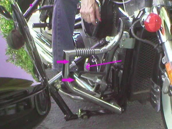

Well I picked up my new rig on Monday, trailer still wasn't big enough for the set up (it is the same size as a compact car for sure) so it had to be removed from the bike angled on the trailer barely fitting. Got her home, dear son in law hooked her back up. Yesterday Gail and husband Larry came over, they got it adjusted so the steering is a little easier, it was very stiff. Gail took me for a ride, boy does that gal hit it.. Hold on for dear life...LOL just kidding, kinda, I'm not much out of second gear yet, rig is ver comfortable. I have to make one big change, taking off my engine guards and change the angle of the front top arm, it is in the way just enough to get my foot caught on the back brake, a safety issue for me for sure. But it is just a blast, the grand kids love it. Huge rig, makes my bike look like a little toy...LOL More to come as I practice practice practice, those right turns are messing with my head, as expected I suppose. I put an album of photo's out there under OlBroad.

I agree for different reason though, I like hanging my feet up there on long rides,pricey- well they used my bike as their prototype, so they cost me nothing...LOL My Sampson pipes as well same thing.. Lucky me. LOL I was thinking maybe a shorter brake pedal, is there such a thing though?

If you're thinking narrower pedal, there used to be a "Lollypop" (round) rubber brake pedal we used back when. Had to drill a hole through the metal pedal and bolt it through. looked cool and worked well. Kinda like a Model A brake pedal.

See where my foot is getting stuck, think your idea would work? Saving my bars?? LOL

A smaller pedal placed further inboard would sure give you more foot room.
