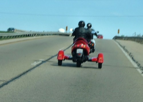

Good topic--sometimes on "sidecar side" turns, I wish I had an out-rigger wheel on the other side of the bike, just in case...
Posted : August 14, 2008 8:34 am
You mean like these? 🙂
Posted : August 14, 2008 10:24 am
.....LOL...
....and this is over 100 lbs. of ballast combined with chick magnet! Women want to know me just so they can get close to Rusty LOL!!
Posted : August 14, 2008 11:39 am
