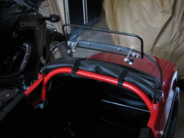

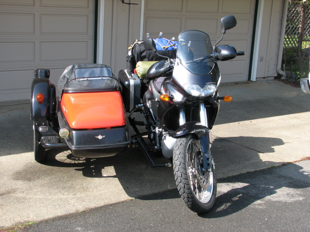

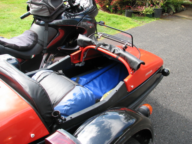

Next time I ride the beast to breakfast take a look at the folding screen I fabricated for the Sputnik. I expect you can easily make your own using a similar approach. This is the second version, the first one made out of acrylic is somewhere on a fire road above the North Umpqua. For this version I used Lexan and so far it seems to be holding up. I bought most of the hardware at True Value in Bandon, the rest was made from bits & pieces of scrap metal, etc. Should be interesting to see if it survives the trip to Alaska.

Very cool larrylarry ...looks great.
