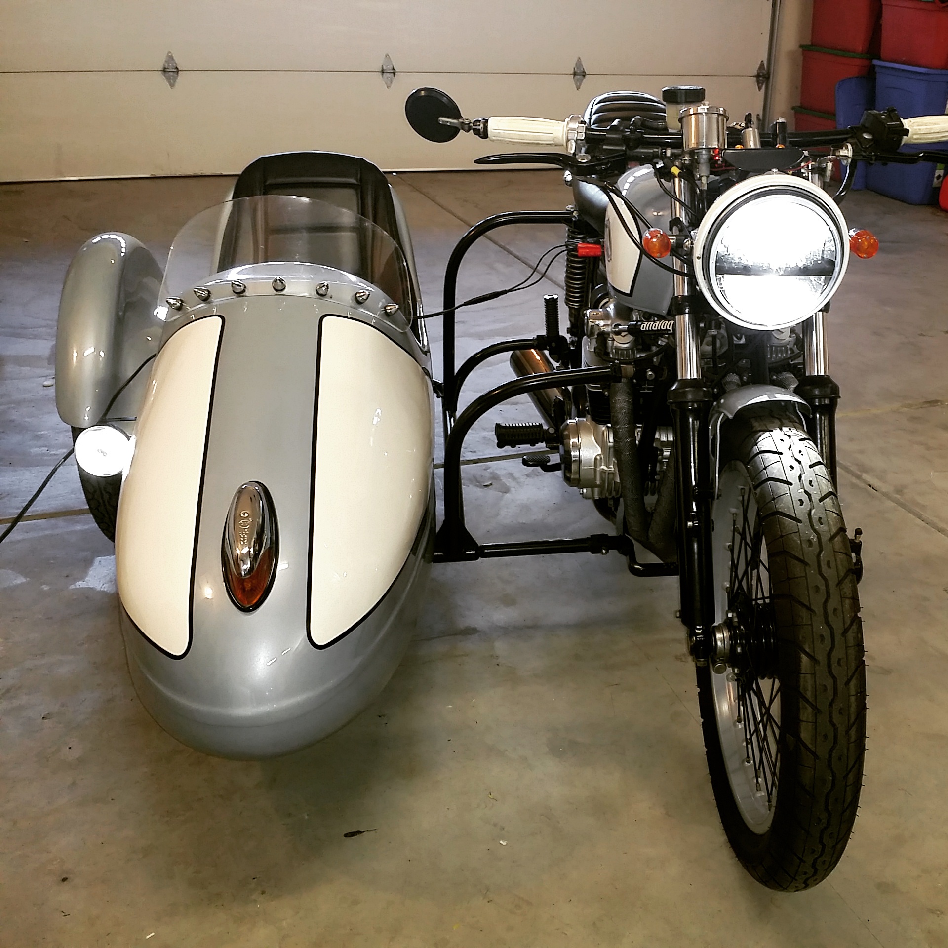

(@b5rider)
Posts: 53
jaydmc - 6/12/2015 7:34 AM
If you look into what it takes to make frame clamps by the time you make them and plate them, you could not hope to do your own with any kind of quality this cheaply. Our frame clamps run $110, They are less likely to slip or damage the frame of the bike then other brands of clamps.
BUT clamps are not the proper way to go when attaching a sidecar, one or perhaps two clamps used in a manor where they are not trying to rotate work out fine but seldom work for lower mounts as they end up putting the mounts to close together on most bikes and often the lower mounts end up different distances off of the ground which can make alignment a bit more difficult, When ever possible go with bike specific mounts.
You have not said what bike and sidecar you have. In any event, you life and the lives and safety of every one you share the road with depend on the sidecar being attached firmly in all conditions. Cost should not be the deciding factor as to how you attach a sidecar. Safety must always come first!
I have a late 70s California Eagle sidecar attached to a 1978 CB550. Mounts are custom made for aesthetics, then function. I am trying to make them more sturdier and add some adjustability. I'm taking the bike to the gentleman who set up my previous rig and did an awesome job (Felony Fabrications-recommended by the forum) so I am going to try and not spend a bunch of money on clamps which will be replaced by welded, specific mounts placed by a professional
