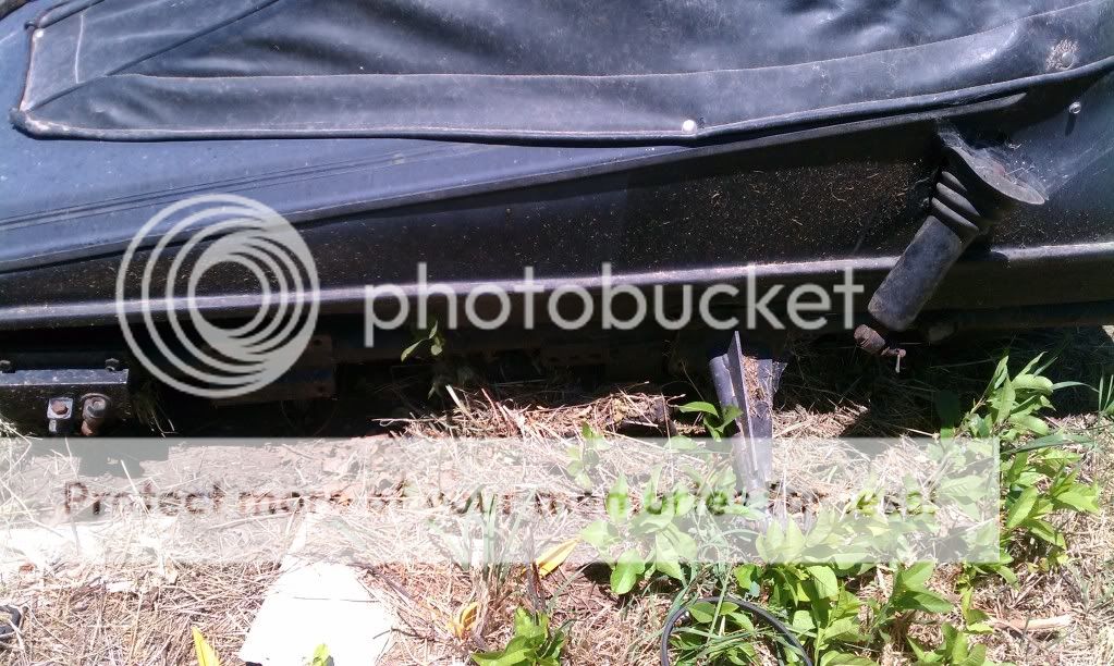

I've run across this old Terraplane, and have a feeling that I can bring her around. She looks to be pretty complete, but I would love to have some input from the rest of you pros before I jump in head first.
Here's just a few quick and dirty pics:

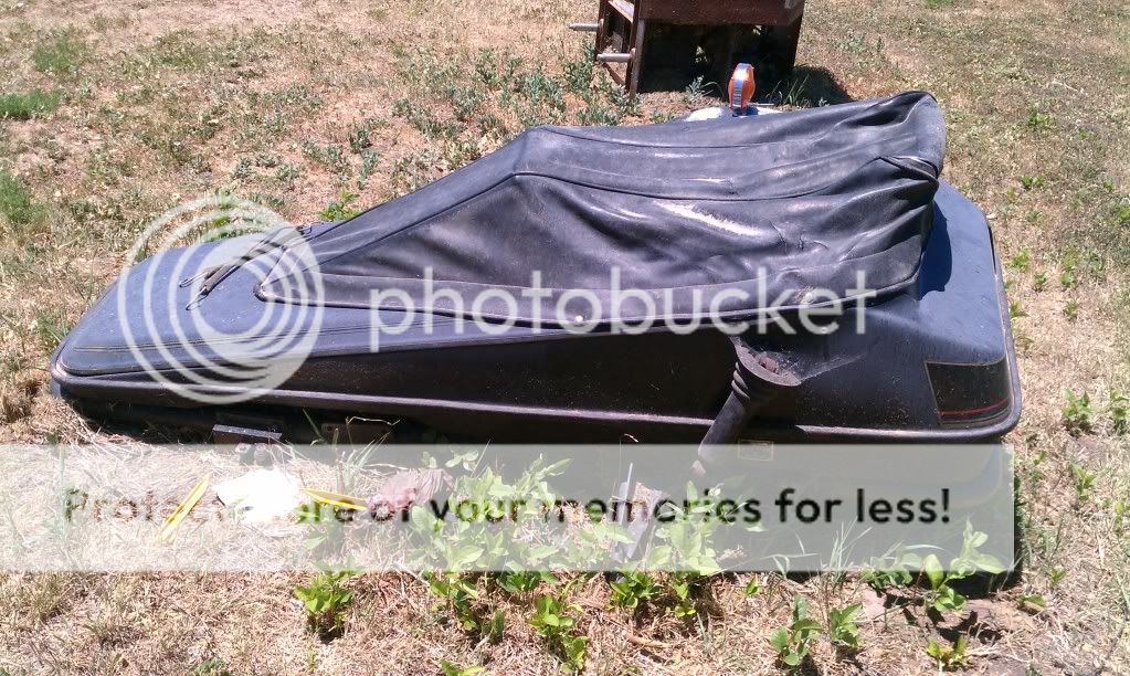

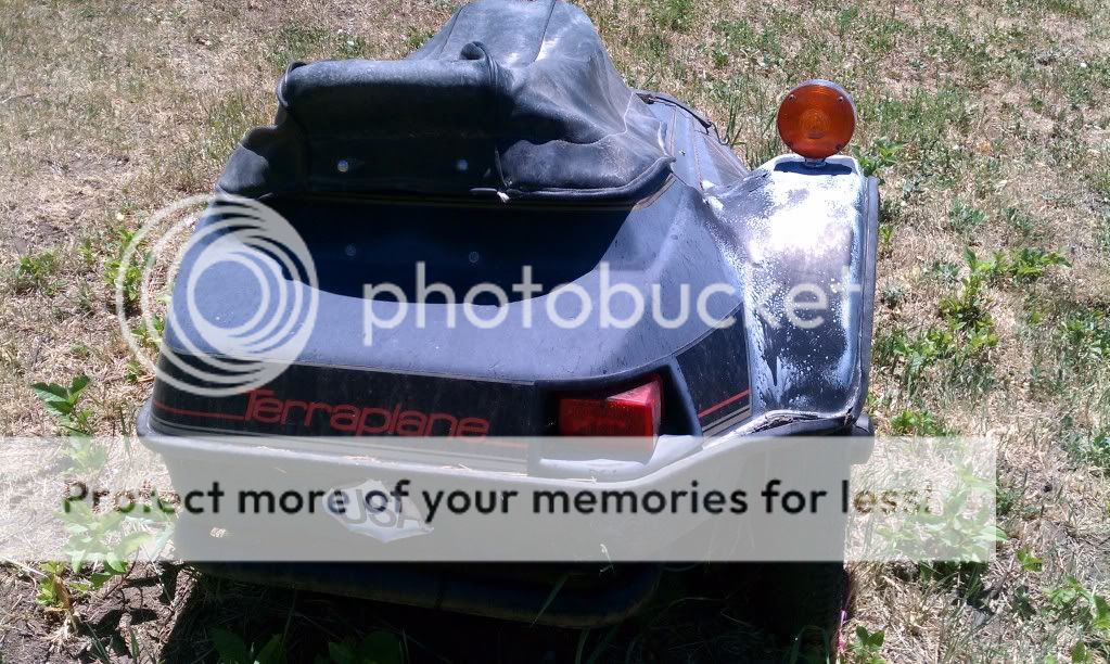

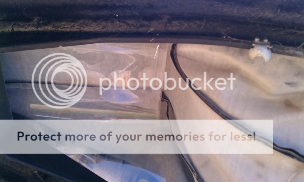

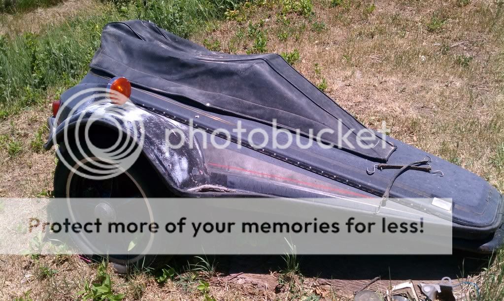

See anything glaringly obvious that I'm missing? Side trim/moulding is coming off, but otherwise, everything looks to be there. Plexiglass screen is in decent shape, but not perfect. Cover is worn, but could be patched or used as a pattern to make a replacement. Tire is weather-checked and will need replaced.
What else can you all discern? See any major red flags? Any strong feelings about the Terraplane?

That looks like a good starter if the price is reasonable. Seems to be all there and no significant body damage.
I have a new 16' length of the body edge moulding to replace the damaged part if you get the rig and a brake control ass'y. if it has/had brakes.

Hard to say what it's worth to you. Does the owner have aprice number. It obviously been neglected, needs TLC and a lot of work to be in top shape. It doesn't look like hard rust is apparent but the chassis could use sandblasting and repainting. The body sorely needs paint ( pricey these days). New tire and mounts for your bike. If it's free you'll still be in it maybe $1,800. It depends on how much you can do yourself and how far you want to go with it.

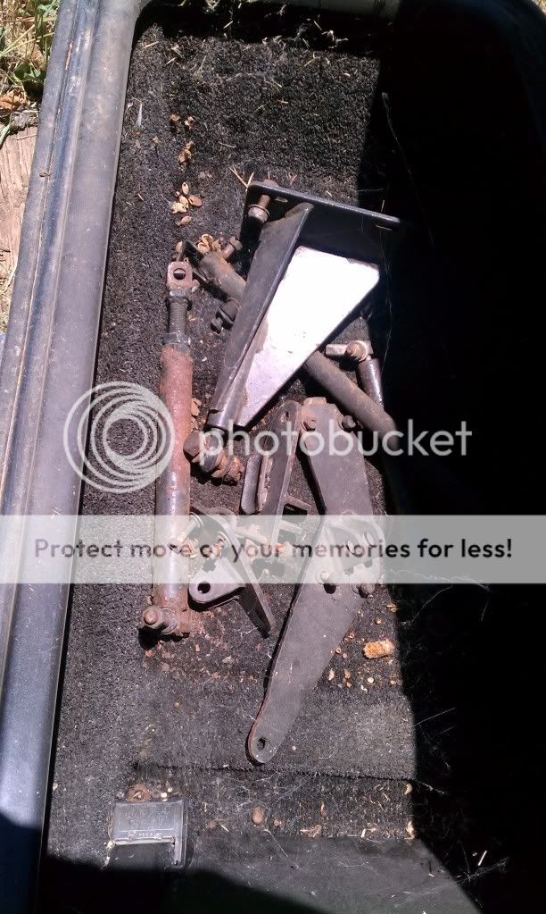

On issue with these sidecars is that they have a non adjsutable 3 point mount system. Looking at the mounts in the photo they look like either GL1000 or GL1100 Goldwing mounts. As they are not adjustable the 1980 / 81 Gold wing used different "pylons" (lower mounts) then the 1982 /83 has honda changed tire size and as such the bike sat different. In the photo of the mounts you do not have the original "trim grip" On these sidecars the single upper mount was made such that you could adjust it while riding. You have at least one home made strut shown in the photo. Most sidecars use a 4 point mount that is adjusatable. As we own all of the NOS vetter parts if you intend to mount it onto a bike that Vetter made the mounts for we may be able to help you. We sell the NOS Vetter mounts for $150. They will be missing bolts, have no instructions and look like they have been stored poorly for 30 years as they have been. We also have a kit to convert the sidecar over to standard fully adjustable 4 point mounts. The 100% bolt on kit for the sidecar side runs $750. It gives you a standard boss and clamp lower mounting system. ONce this is done it will work with all of our mounting kits and most mounting kits made by other US companies.

Isn't the trim grip shown in photos 2 and 4 still connected?

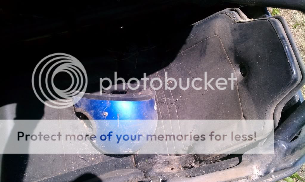

that old Bell helmet belongs in the Smithsonian!!, nice chair there, good luck,....crawf.
