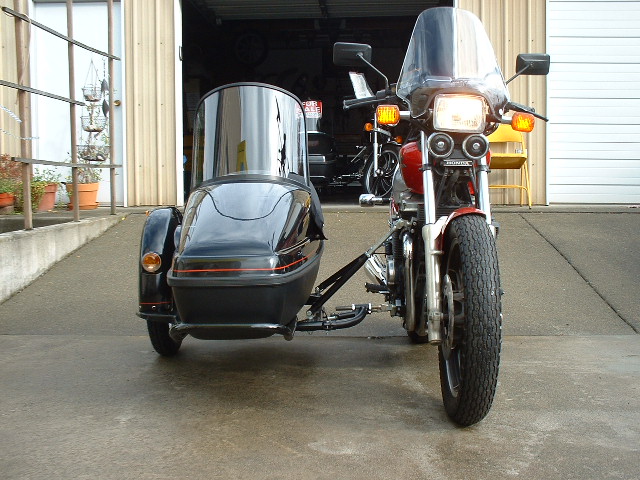

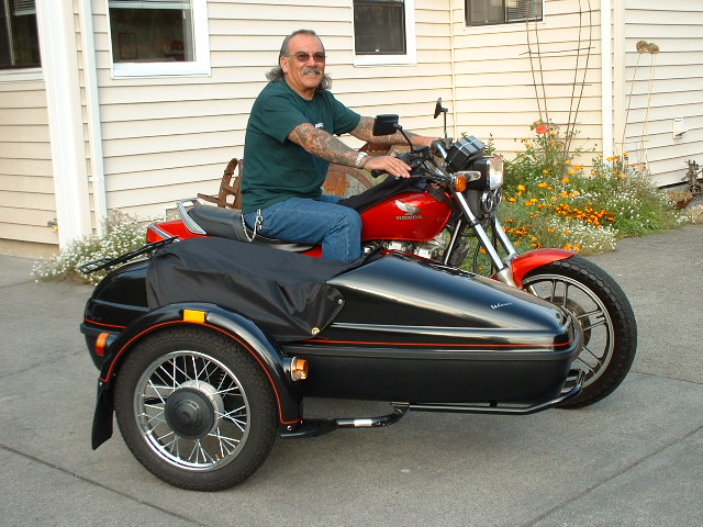

Here's an '84 CB650C with all Velorex mounts. Worked great.
If placed correctly (not as shown in the Velorex handbook) the rear sliding mount doesn't have a tendency to slip.

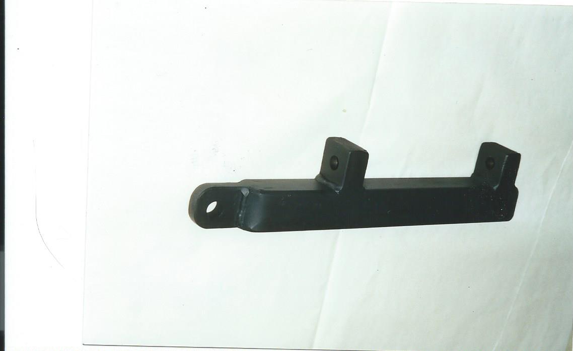

I've often used the center stand mount position (on bikes with center stands) for the rear lower mount using a design mount as pictured.

The Photo of the lower mount is the idea of our lower mount however on the Honda it will not work. The Honda uses pinch clamps around a tube to hold in the center stand. We remove the center stand and our mount is hollow like the center stand to that the stock mounting tube for the center stand will slide back in and hold it.
We will often also move the eye bolt aft when we make these kind of mounts with the bike in the shop. We do this by often also picking up the rear foot peg mount. This is what we are tooled for the Honda CB750A but only for the "A"
