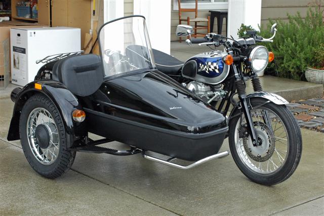

The 562C and 563T both fit well with the W650.
20" wide seat and 52" of legroom and they come with all the extras included. windshield, top, tonneau, mount set, full lighting, great fit and finish.
Here's a W650 with a 563 Tour car installed.
Posted : October 22, 2007 1:53 pm

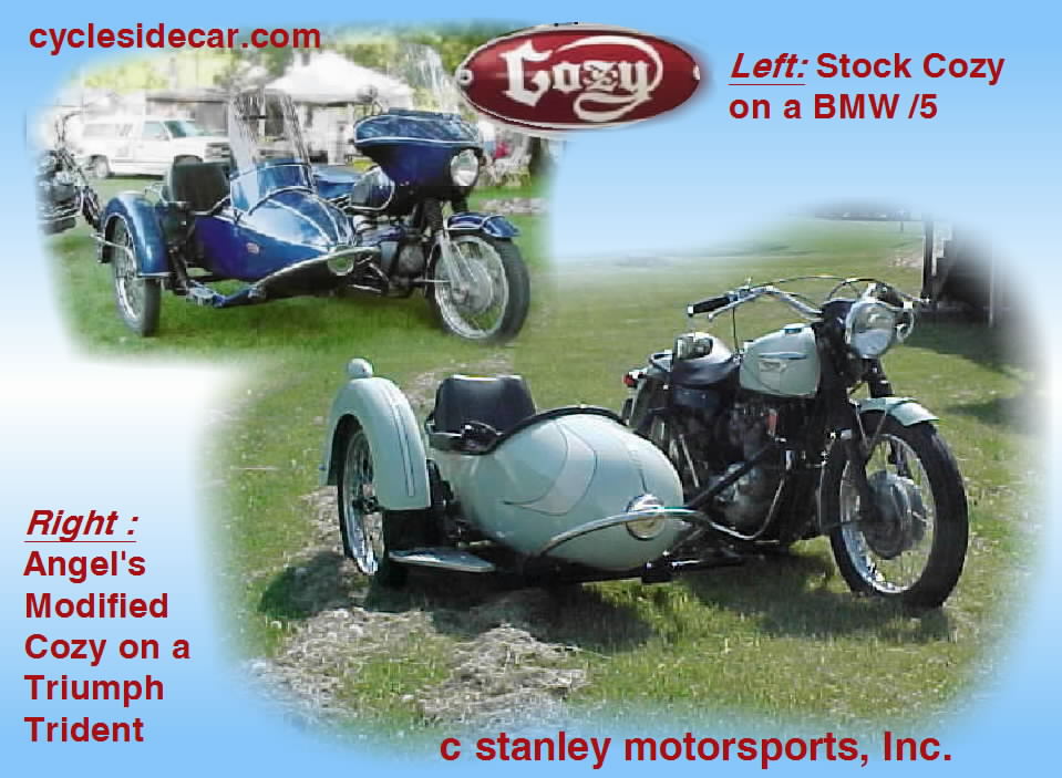

If this works a picture of a cozy we attached to a Triumph Trident will be seen in the attachment.It is owned by Angel VanNeida ( wildaswind@dejazzd.com ) and did win the peoples choice award at RON DEE VOO IV.
We lowered the sidecar as shown 5" and also set it out away from the bike for stability. The mounts were fabricated in house. Yes, we did use a subframe fabricated in house with 1 1/4 x .120 wall tubing to distribute th eloads and provide the ability to easily adjust th esidecar by having the mounts placed in proper positions.
Angel, who is in the leather business, fabricated the bike's seat from an English saddle. Her husband, John, designed the paint job. The rig also has a larger sidecar step added which was milled via CNC from billet aluminum.
It is a daily rider and is run pretty hard. It is solid and very stable.
By the way Angel does quite well with the kick start only rig.

That is really handsome, Claude. Is there a place to see more of that?
Am I wrong, then, about the Cozy being too light? It looks like an awful lot of work went into that besides a paint job.
