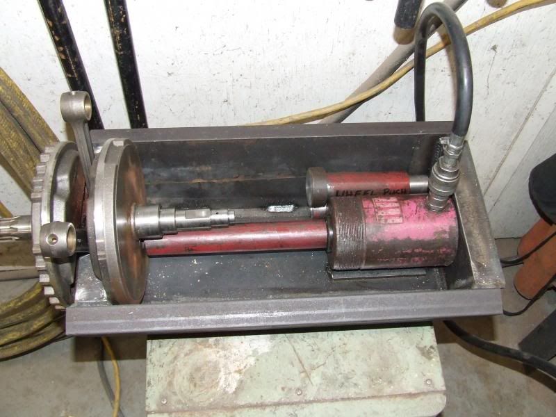

I know this is off topic but here is a little something I made for doing twin cam pressed cranks. Been doing 99 and earlier for years but just getting in to pressed cranks. This if for those that have any dough about my qualifications.
