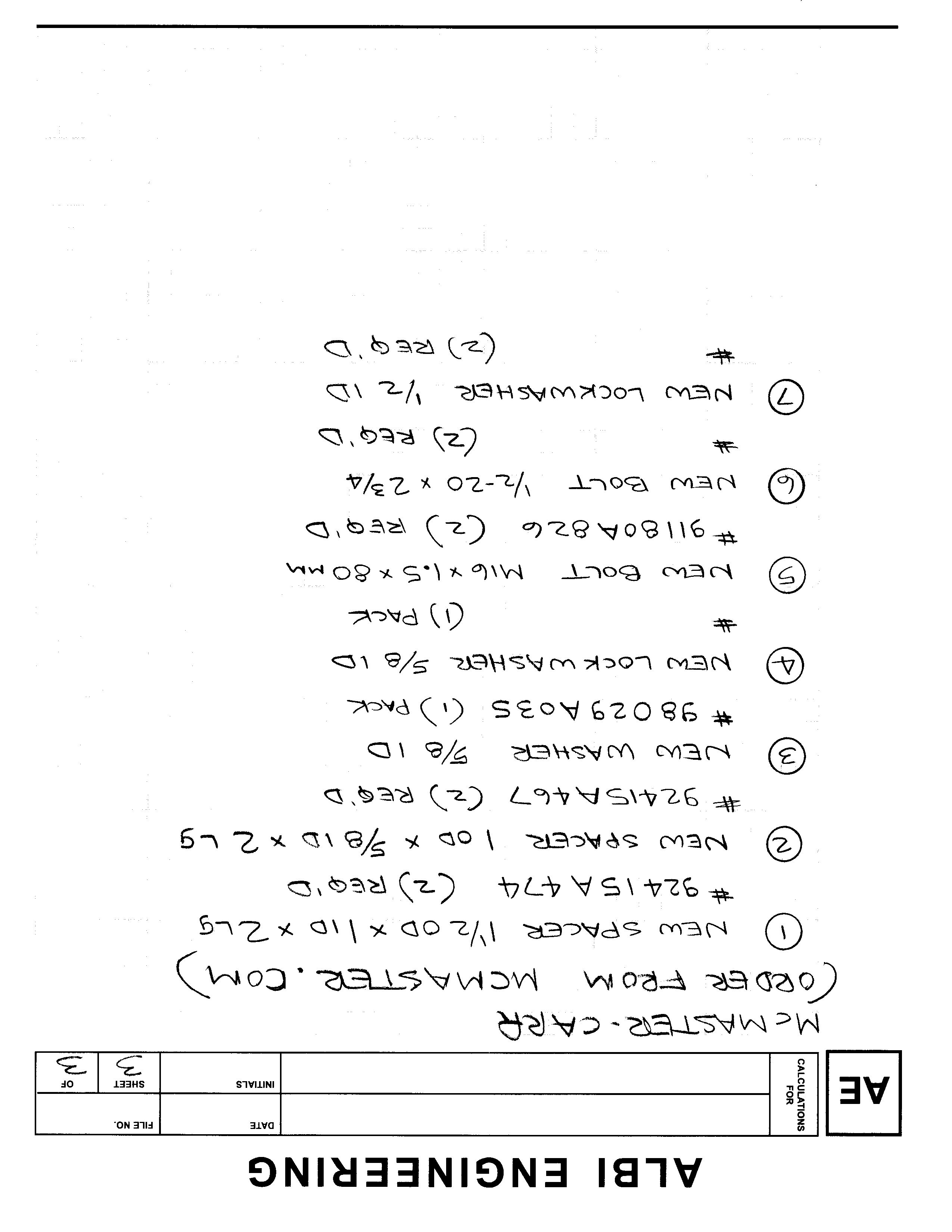

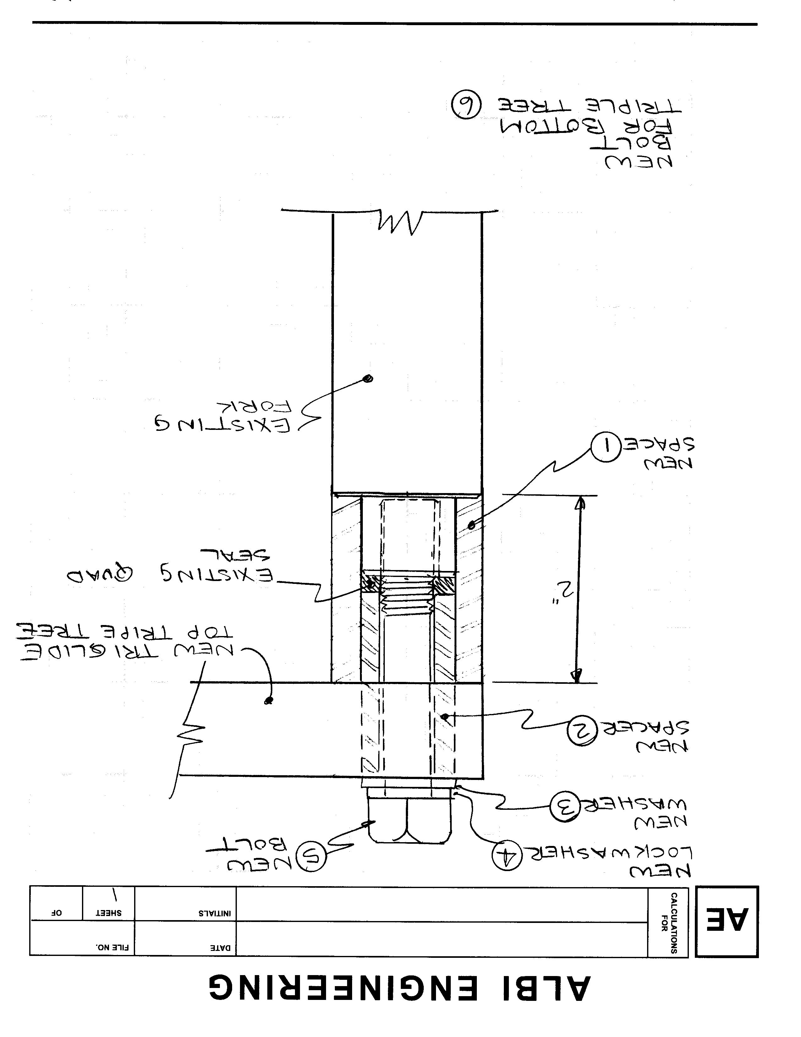

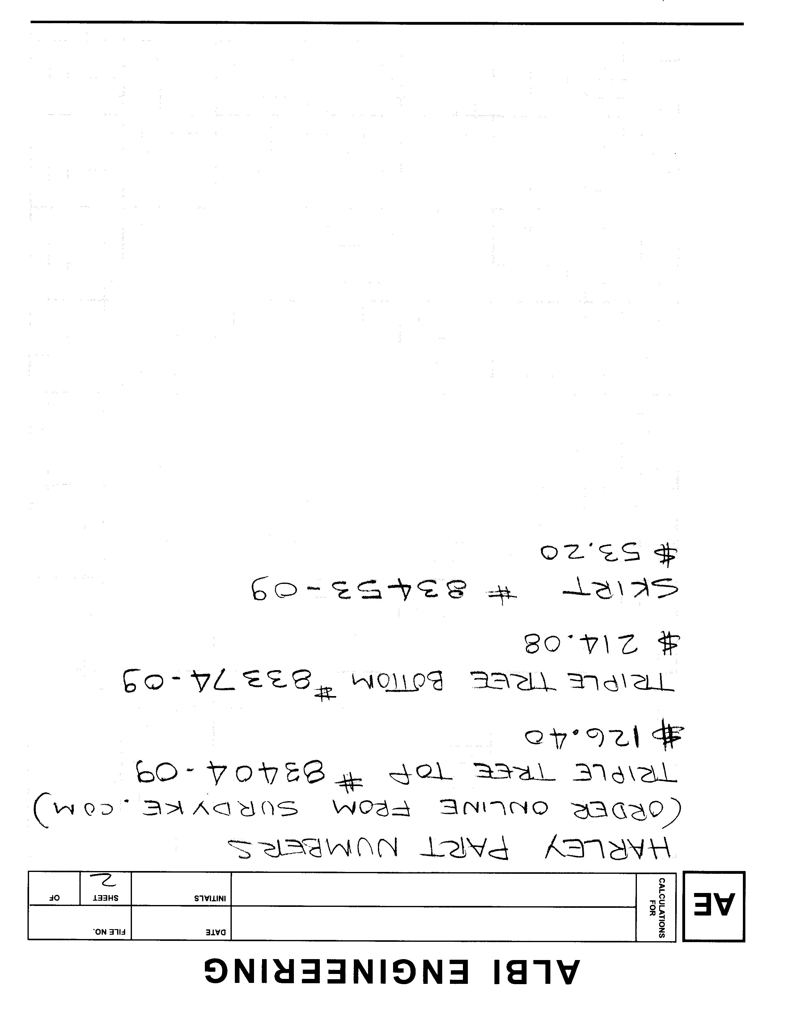

I have a 03 ElectraGlide Classic and have installed the TriGlide triple trees with a fork extension of 2" done with spacers.
It makes the handleing a lot easier.
If you have a HD shop manual and tools it"s not too hard.
See atttached part numbers and sketches.

here are the attachments

I am 61 years old and I installed a set of Tri-Glide trees. I was a mechanic when much younger and have always stayed in the industry in one way or the other, plus I still have all my tools. It wasn't fun, but I did it over the winter and spread it over a couple of weekends. I bought my parts from the dealer listed on the sheets shown above. As you can see, the price was right. I did mine without the spacers after I saw other posts by people that had done the swap the same way. That dropped the front of the bike and inch, or slightly more. To compensate, I lowered the back to match. I will say I plan now to add the spacers this winter because of the loss of ground clearance. When completed I was surprised at the change. I have read some posts saying the Tri-Glide trees don't reduce the trail enough. I find the steering now takes no effort at all.
One additional part I had to change was the front one piece brake line. I found the original would not fit the new trees. I bought a three-piece braided line set for my model where the handle bars where raised 6 inches. That allowed plenty of slack to route the line from the master cylinder to the tee attached to the lower tree.
Just an after thought. I found the factory Service manual was not a lot of help doing this because it wasn't really covered in the 05 Touring manual (I have an 2005 ElectraGlide). What I found to be of great value was my 2005 Factory Parts manual with the exploded views. The only real problem I ran into was the two large sockets required to remove the fork stem nut and the upper fork bolts. I found both at a Farm & Fleet store for less that $15 each.

I known the damper parts are different on the right and left fork. For $800 they could at least design the trees so the fork just slips into the spacer and then the spacer slips into the tree like on a stock part. Check out the drawings above.

I paid the prices shown above in the art work posted up above plus a three piece front brake line kit from J&P cycle. The line added about $150.
