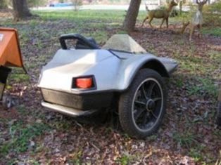

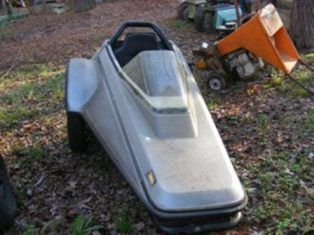

Hi I am glad to find this forum. I hope that someone will be able to tell me the brand of this sidecar. I want buy it and switch it back and forth between my Ultra Classic and my sons Sportster. Thanks
Posted : March 31, 2012 9:51 am
It is a Vetter Terraplane. it is heavy enough for your Ultra.
Posted : March 31, 2012 10:20 am

Thanks,
Is it too heavy for the sportster?
Posted : March 31, 2012 10:25 am
Many have been mounted on Sportys. Saw one today mounted on a 800cc BMW.
Posted : March 31, 2012 1:49 pm

Yes this is a vetter sidecar, we have all of the NOS vetter mounts however Vetter was long gone by the time your two bikes were made. The Vetter used an odd by todays standards 3 point mount. We can supply you with a 4 point bolt on conversion for the sidecar. We can also supply you with mounts for your two bikes however chances are as you will have to realign the sidecar every time you switch it that you will deciede to leave it on one of the two bikes. Either bike will handle the sidecar just fine. As long as the bikes are EVO generation or newer we not only have the bike specific mounts but we also should you make either bike into a full time sidecar bike we offer triple tree's to lower the steering effort and for the Ultra we offer reverse for the transmission.

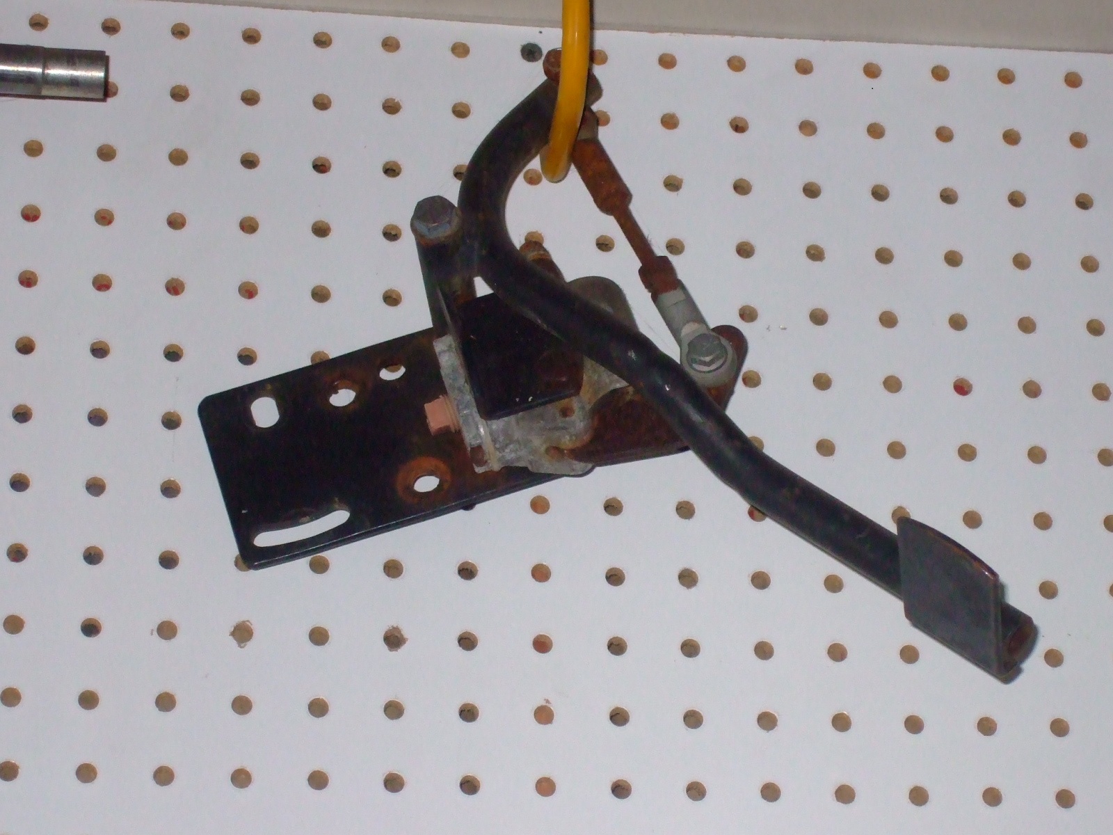

I have a new body joint edge moulding for the Terraplane. Also have a Terraplane brake assembly with bracket and pedal.
Posted : April 25, 2012 5:03 am

Lonnie, I would be interested in the edge molding. Contact me with a price and details if you are looking to part with it. There is no brake installed on the sidecar so if it is compatible that could be of interest also. I will try to see if it appears the brake assembly has been removed or what's up. Anyone know if all Terraplanes were originally equipped with brakes?
Posted : April 25, 2012 7:32 am
The brake that Vetter ran was a very poor design. It had a non floating rotor with a non floating calipar. If you want a brake you would be much better off fabricating up a different set up then running the OEM parts. We just scraped hundreds of these brake pedals. We only however had the pedal not the master. On the GL1100 we normaly tie the brake onto the front brake master.
Posted : April 25, 2012 8:09 am
The Terraplane brake was an optional accessory. They came with or without brakes. The brake was independent of the bike's brake system.
