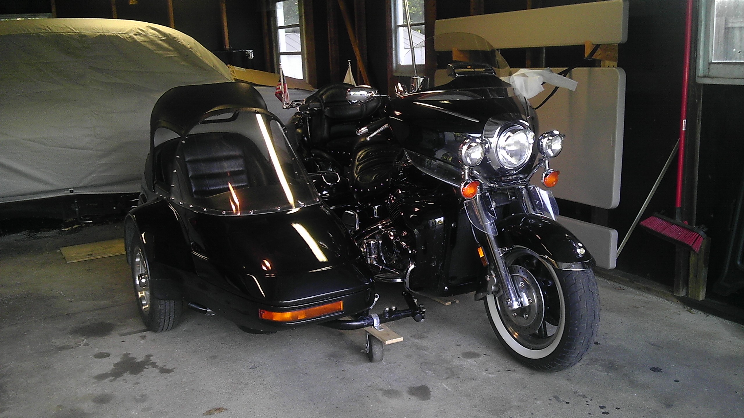

I finally got the opportunity to put the bike and sidecar next to each other. It looks like I will have about a 9” lead and 60” track width. I have seen track width measured from center MC tire to center SC tire. I have also seen it from outside MC to outside SC, and this is what I measured. I am now working on getting the brackets situated. The mounting points on the sidecar are 33” apart, the best I can do on the MC frame is 20” apart for the lower brackets. Do you guys thing this is sufficient?

just ran a tape across my two rigs and both track bike tire center, to chair tire center at 48", with aprox a 7-9 inch lead of the chair axles,..I was also suprised to find chapter 13 in my Clymers manual for the '81 Goldwing has a section on how to set up a sidecar and how to mount a car tire on the bike if required,...interesting reading,.. there is several shops on here if bolt on parts are required,..good luck, crawf.

Track is measured from centerline to centerline of the tires. Wheelbase: axle to axle.
