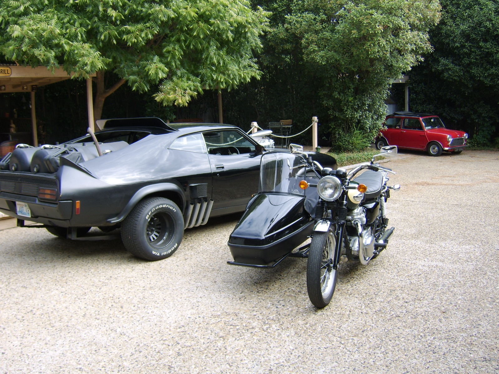

Here are two examples of W650/562 combo's. Both have full size windshields but I prefer the chopped one as in my avatar picture.
Northwest sidecars
