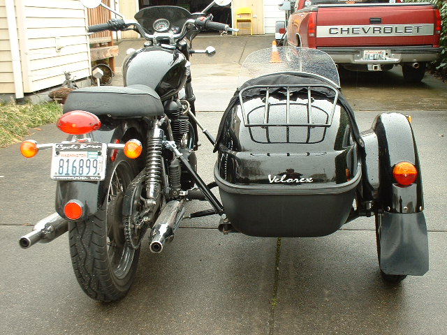

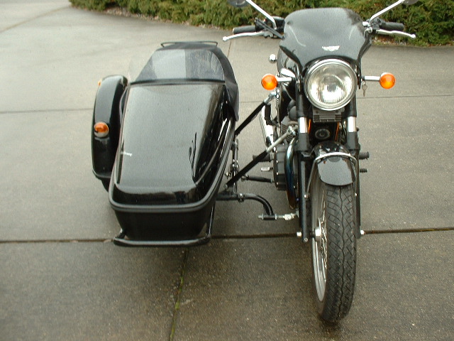

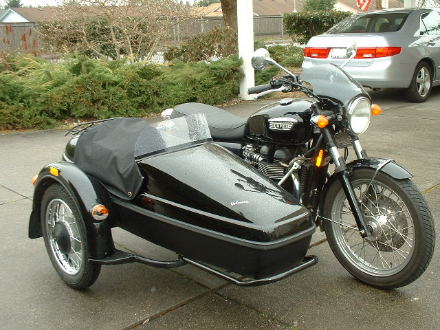

Here is an example of one of my Bonneville/Velorex 562 Cruiser combos.
No welding, no slippage,no mounting problems. The secret is how you place the mounts. Especially the rear lower mount. Keep them linear. Don't follow the Handbook method.
With a 40# steel plate welded to frame beneath the body.
It handles well at all speeds. Without a damper.
FYI: The Cozy universal mounting kit is a Velorex mounting kit.

that's a great looking rig Lonnie,...very tight package, nice work, crawf.
Posted : June 5, 2008 1:26 am
While I'm not into Black M/C's sometimes things just work and look well in Basic Black as does your rig Lonnie 😉
Jerry
