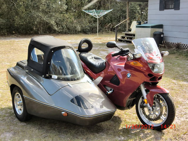

'04 K12RS with a Hannigan Conde Classic car. Found the car used about 60 miles from Hannigan's shop. Since I had to get all the brackets and mounts for this bike, I had Hannigan do the install, along with the Steerlite fork mod.
I've ordered a handlebar conversion kit from Spiegler to change to a wider tubular bar, the RS bars are very narrow.
Have about 200 miles on it so far, really like it, as does the wife! I'm returning to a sidecar after 30 years, been practicing and taking a S/TEP class the end of the month.

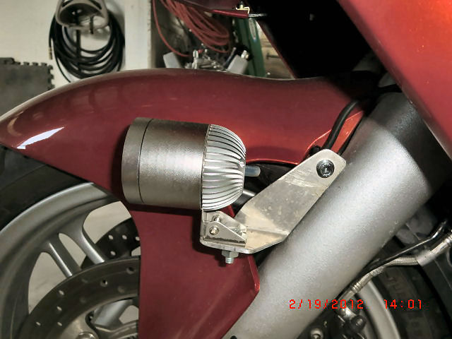

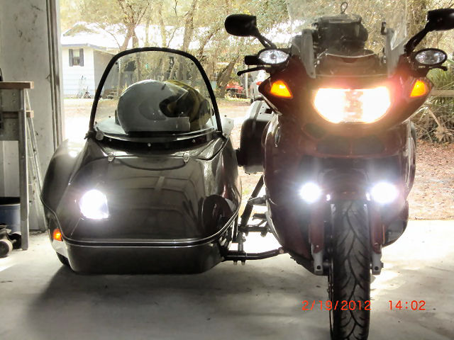

I went ahead and bought three LED's and a dimmer from ADVMonster. Mounted two on the fork legs and replaced the anemic light that was in the sidecar.
Pic1: Made these brackets for the fork legs.
Pic 2: In the garage the sidecar light is full strength, the fork lights are about 30%.
