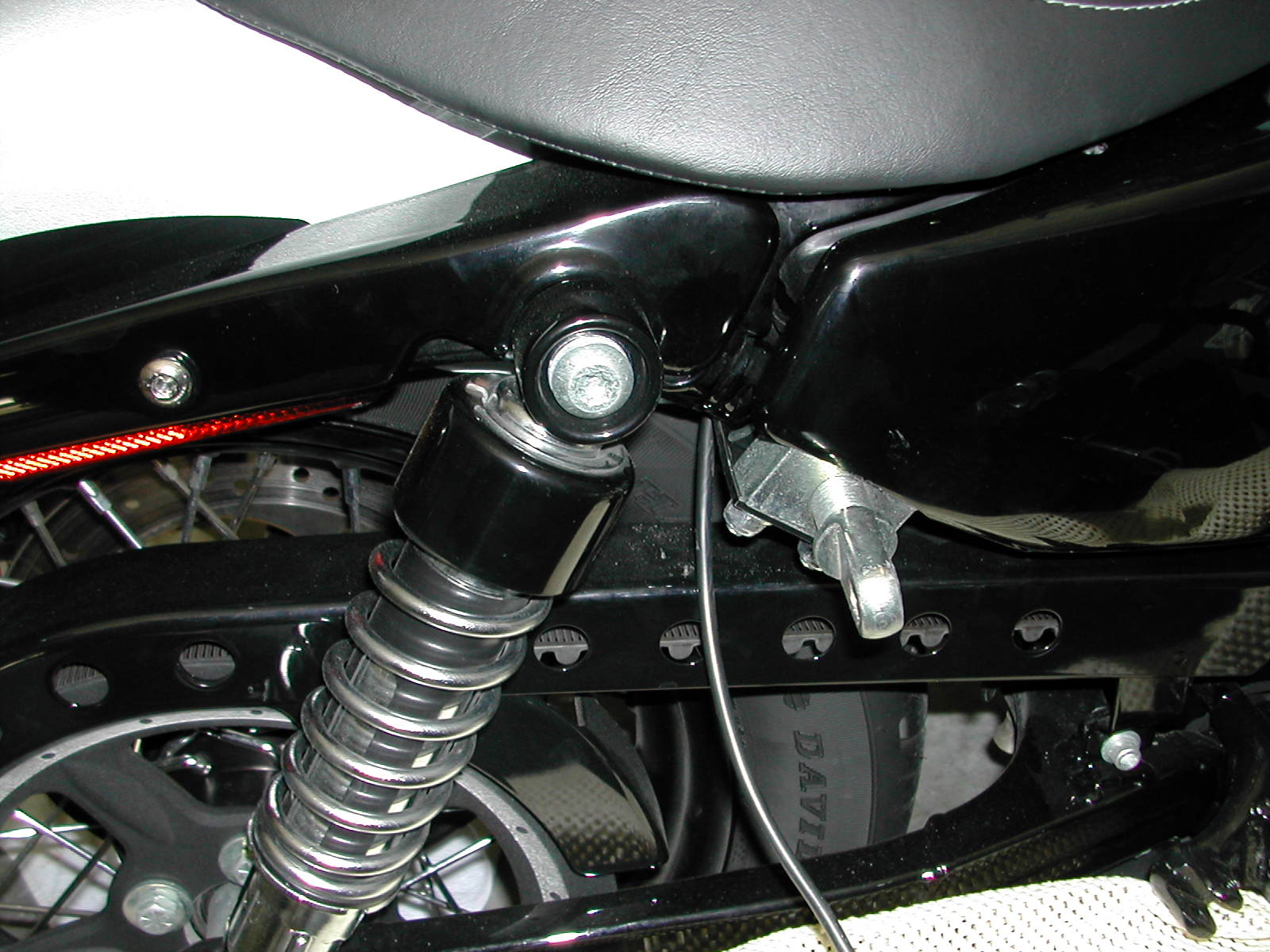

I've seen the PDF on the install but I sure would love to see actual photos of where on a Sportster it attaches. I kinda have the front figured out but I'm just not to sure about the rear mounts.

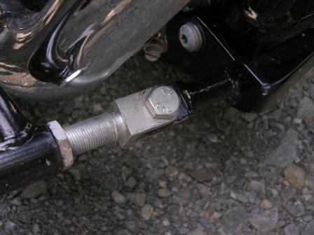

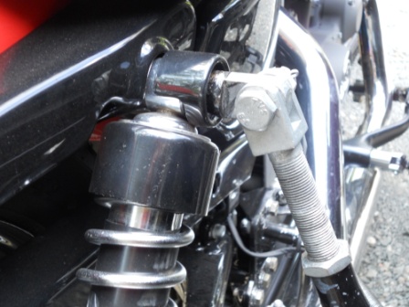

Here's where someone in Florida put it (not me).
L.
Posted : July 31, 2011 6:12 am
PERFECT!!! Thank you. That was what I was thinking. I was not sure where to put the rear mount.
Posted : July 31, 2011 10:19 am

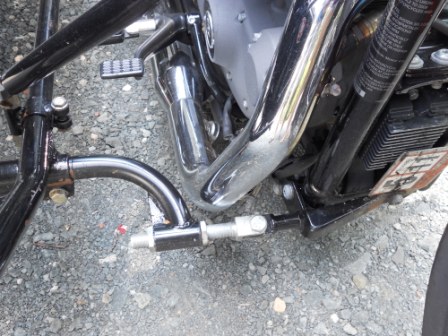

Any chance you have pics of the lower mounts?
Posted : July 31, 2011 12:41 pm
This is all I have from the same rig.

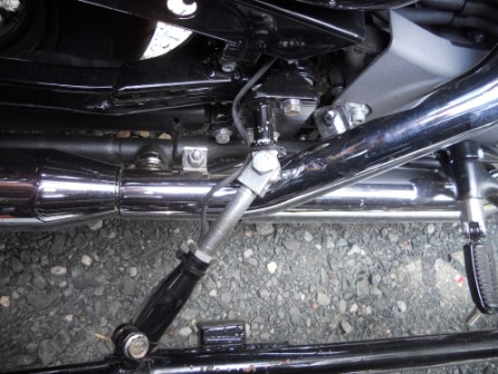

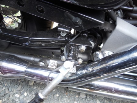

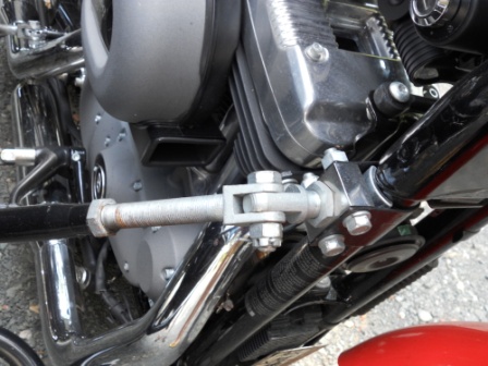

The Cozy has a 'Universal Mount' kit available and I bought that ($99 I think...). Trouble is, Universal is relative and in this context it excludes Sportsters! So I ran it up to a bike shop in Pennsylvania to have 2 out of 4 mounts custom-fabricated. It's very finicky about the toe-in, so that has been a bit of a process getting there - but it's great now. Taking it off can be straight-forward (unbolt 4 mount points) but not recommended as a regular exercise - because of the re-alignment aspect. It's not a convertible set-up to be swapped in and out. (At least for me, anyway).

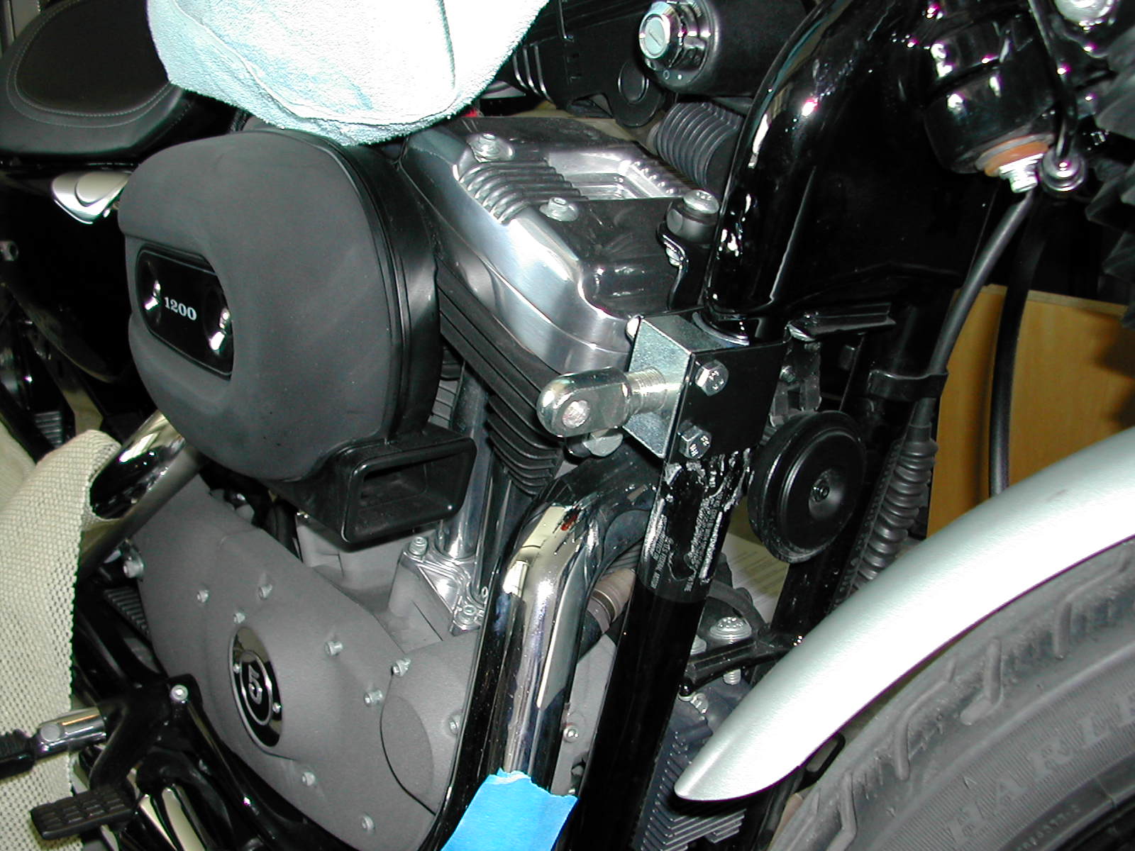

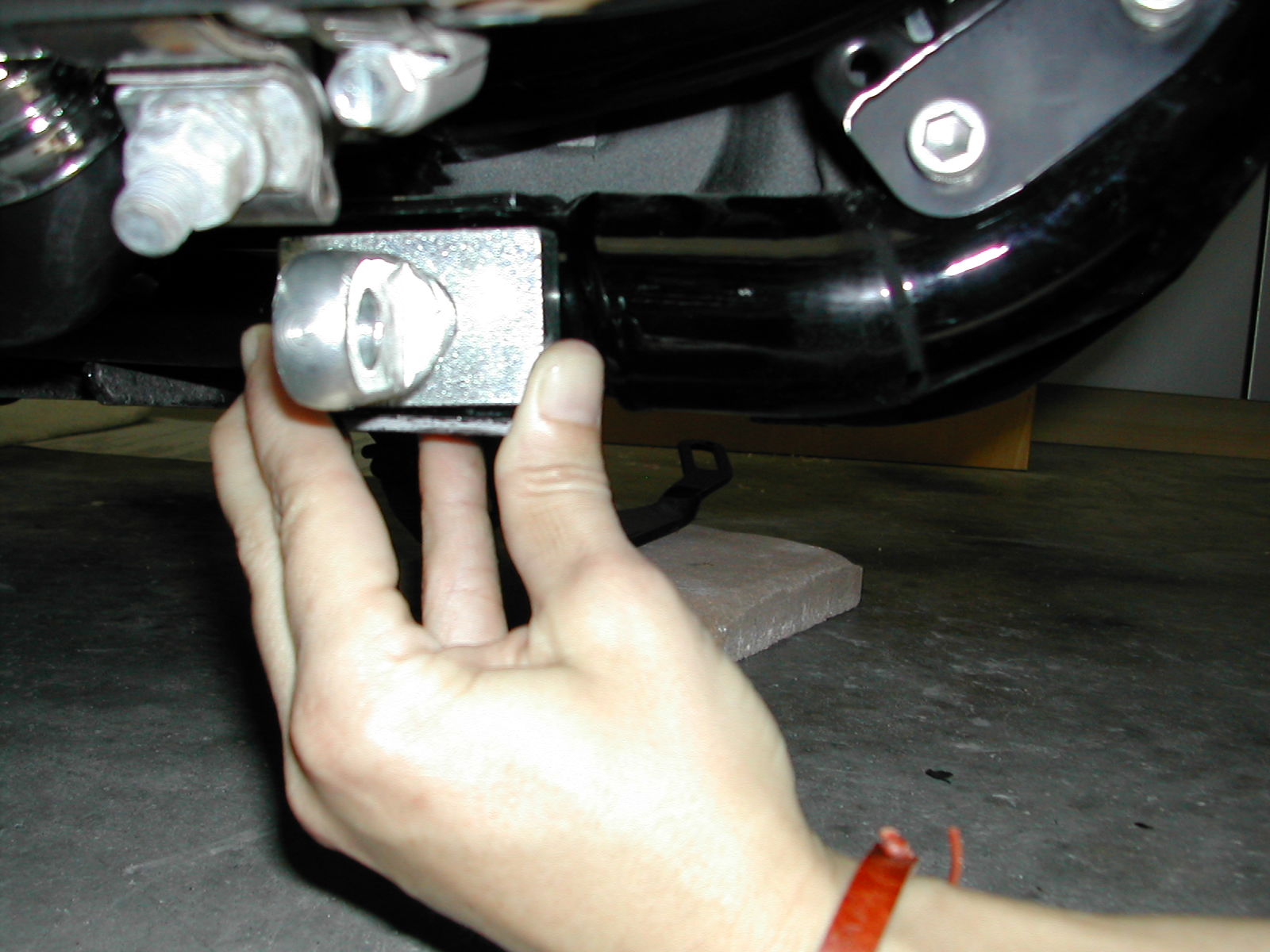

Rear Upper and two Rear Lower shots
Front Upper and two Front Lower shots
Posted : August 1, 2011 10:10 am
Nice job on the install. I like the way it was attached at the top of the shock and the passenger peg mounting are. Kinda hoping I don't have to do all the custom fabrications to make it fit. Looking at the pics I think the install kit I'm getting will work for my application. My exhaust doesn't get in the way like stock exhaust.
Posted : August 1, 2011 3:49 pm

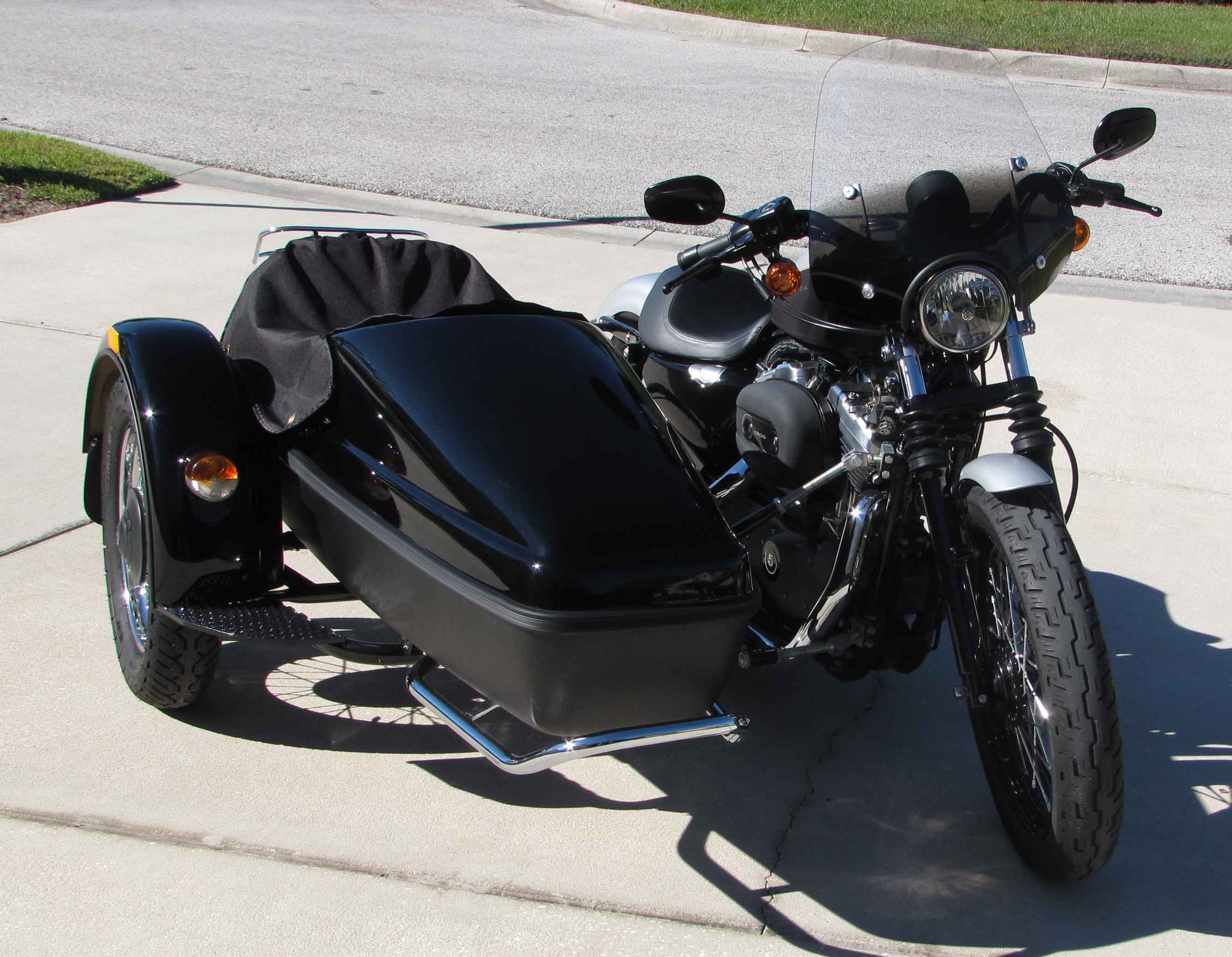

My sidecar has arrived and I have it installed. Just lacking marker lights and alignment.
