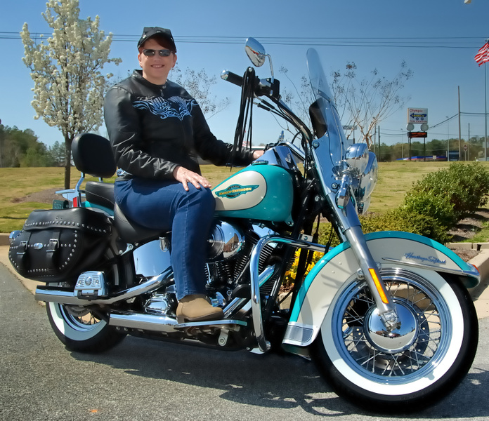

It will be black....Here is my wife's bike (which will have the sidecar). Will probably color match the sidecar sometime after we receive and install....
