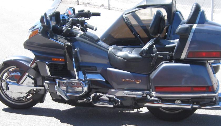

 I ve been in contact with the owner of this rig. 1988 Wing with almost 24K miles on it. It sounds like he hasn't owned it for a very long time because he doesn't know a few specifics about it (like if the car has a brake). I haven't asked why he is selling.
Anyway, it is a color matched California sidecar. Triple trees are done. Tires on good shape. Awaiting more pictures.

I have owned two 1988 GL1500 with sidecars, one was a gray one with the california freindship 3 sidecar on it, Might even have been this one. The other started off gray but as I purchased it wrecked in 1990 and rebuilt it it ended up red and I ran a Daytona sidecar on it. Put over 100K on it before I sold it. The bike it self being a 1988 is of lower value then a 1990 or newer as they had final drive issues however there are so many trikes out there now it is not all that expensive should you loose the final drive to change over to a 1990 and up final drive and rear wheel as the wheels are different. It looks like in the photo's it does have the triple tree's although it is hard to tell in photo's. The only big ticket option that the sidecar may or may not have is the electric trim. I would put current market value on this bike at about $7500 as the market is a bit soft right now and the bike is 1/4 centry old. The bike has many years of good service life left on it. If you do not have records on the Timing belts I would change them out due to thier age. The brushes in the Altenator are known to stick, If I were leaving on a long trip I would either change them out our carry a spare set and a soldering iron to replace them on the road. If the Alt does go out there are aftermarket high output ones made for it.
