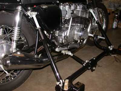

just seeing if anyone out there is running old sohc honda's with a hack. if so would like to see pics of the mounts

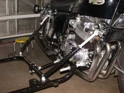

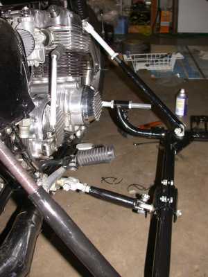

Attached are the photos of my very first rig. (CB750K5 + Velorex 562C)
Mounts are generic ones from Velorex.
I basically mounted the sidecar to a cafe bike. Thus it was very difficult to steer (short clubman bar=less leverage.)
It was like running weight lifting machine.
Per advices from this forum, I slided the front forks up in the triple tree and attached rear shocks for DOHC 750 (longer) to reduce trail.
I now realize that the PO put front forks from CB550 which is a few inches shorter. I don't know how it affected the trail though.
I could live with heavy steering but I couldn't live with slow right hand cornering speed. (I put 40 lbs of ballast but that was not heavy enough.)
I ended up building my own leaner rig with XS750E which is my current.
I use it every day to take my son to school.

skiri. I was wondering if you tied both sides of the frame together or connected to the right frame only?
I used generic Velorex mounting system which uses the right side motorcycle frame only.
