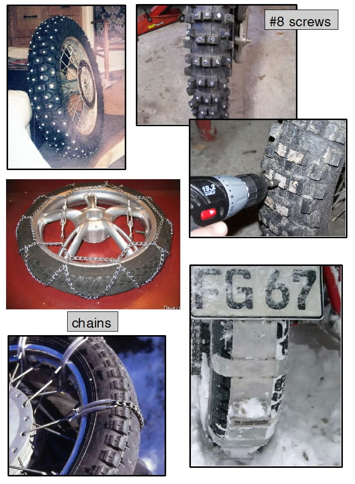

For those who can use studs or chains see attached pictures...screws are from vernon wade. Ridewarehouse does sell a stud kit for bikes.
