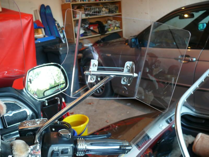

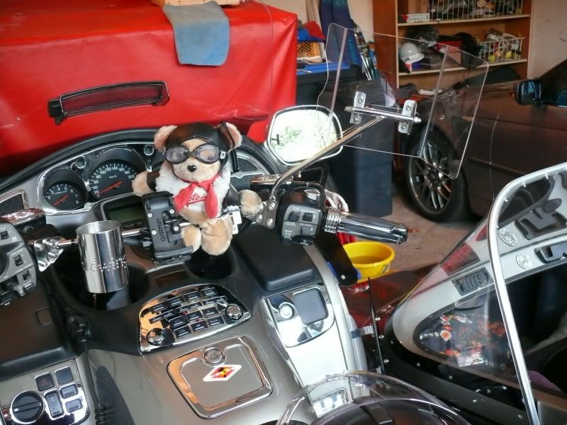

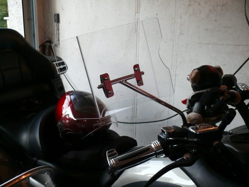

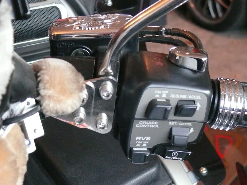

Hello George,
your problem with the "tunnel wind" is well-known and I can confirm how annoying it is.
A Goldwing comrade has constructed a stainless steel bracket mounted with an especially designed deflector made of acryl glass. Since this wind deflector is installed on my GL 1800, the annoyance has gone - it is nearly wind less like behind the big windshield. It is also applicable for a GL 1500.
Look at the attached pics.
Regards from Germany
S I G I
GL 1800
GL 1800
GL 1800
GL 1800

does your friend make these for sale and if so how much?Thanks for the pics,I know that would work because one time I put my forearm up about that level and it got quiet.

Nice pictures and I like the idea of this deflector. My rig is offset differently (bigger gap between the bike's windscreen and the sidecar windscreen) and the side wind come onto me further back, thus this might not work for a Ural Rig, but it is a good idea for other style rigs.
