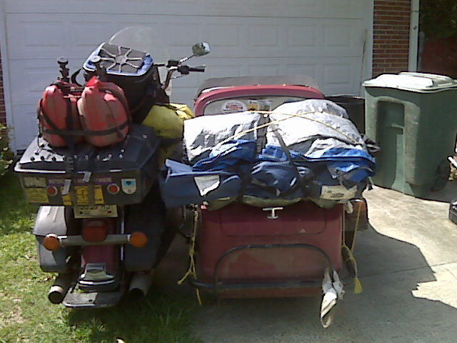

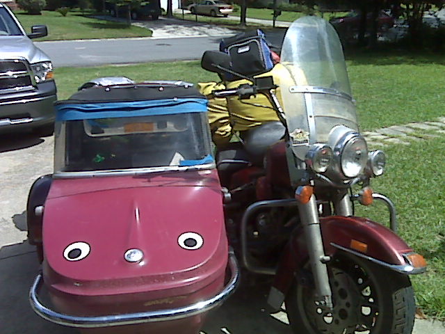

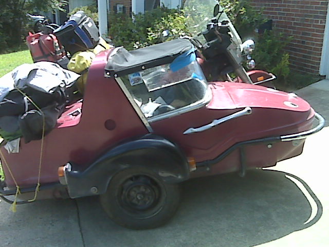

I know this is not a HD sidecar but here is a good friend of mine that drove to Alaska and back with out raked trees or a steering dampener but we did put a heck of a load on the neck bearing adjustment. It is a 1988 FLHS the for runner of the road king he bought new with over 200,000 miles when he drove it to Alaska for the second time. We had to put a motor in it at 180,000 miles which to me is not real bad pulling a rig like he has on a air cooled engine. I do all the work on the bike since new. He all so has two other rigs.
I am just making conversation and learning about sidecars.
