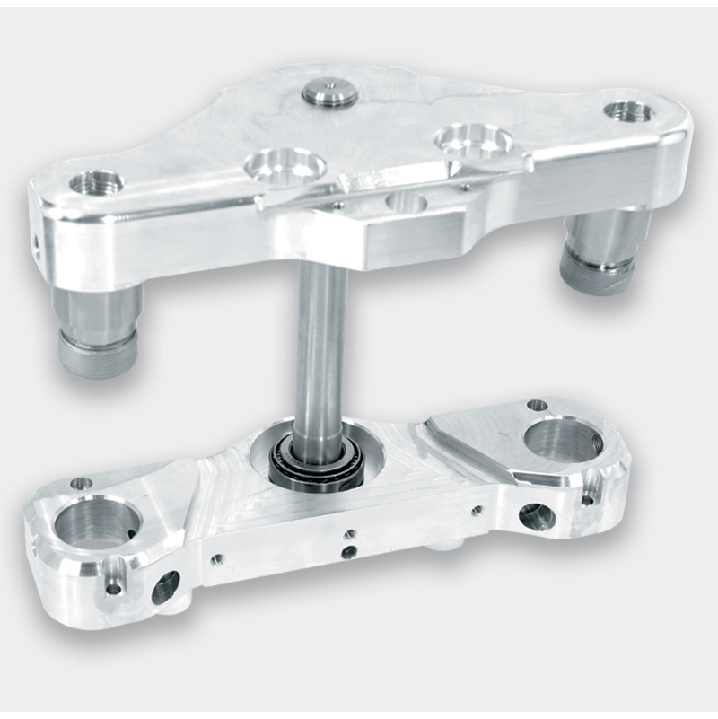

My problem now is the ride I am getting on the bike is not satisfactory to me (although my wife loves the hack) I can not feel comfortable for rides say over 150 miles. The chassis has 40,000 miles on it and I do not believe the shocks have been changed or serviced. I have the car adjusted to HD specs and it does not pull or drag. I feel too much road vibration and bumps, and living here in Wi. in the Kettle Moraine with its twisty turnys the bike is hard to steer through these roads. I have heard a 5 degree raked triple tree will make steering easier. I am also going to service the front shocks.

Stiffer springs on the front are a good idea, Keep in mind that your sidecar has no suspension on it! As such tire pressure makes a big difference in ride quality. The tree's will lower the steering effort quite a bit.

A new triple tree will reduce trail (caster) of the front wheel and will make a BIG difference in steering. It will also lower the front end a bit and you may find it necessary to re-level and perhaps realign the rig. It's not a cheap mod (~$1,000) but well worth it, in fact necessary IMHO. There are several sources for this.

Most good triple trees come with spacers that will take up for the moving forward of the wheel. I have talked to many that do not like raked tress as with them you any small input to steering makes a bid difference then with out them. Now I have to say do to my health conditions when able I am going to give them a try. I found a place that sales a very nice set for around $750 shipped.
