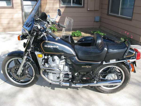

Hi All, I'm new to the site and forum. I did not research prior threads so excuse my ignorance... I have a Honda GL 500 with a Velorex sidecar. I want to get some opinions on what new tires I should go with.
Thanks, Don

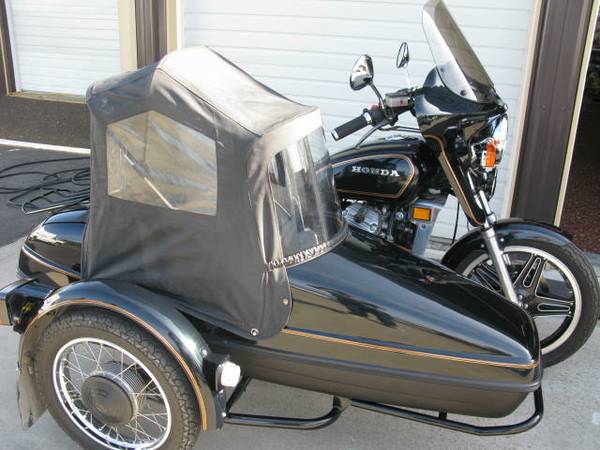

It's hard to beat the OEM 3.50x16" Mitas tire the Velorex uses for longevity. The 4 ply sidecar tire has very good resistance to side pressure that is inherent with sidecars' $120. from Velorex, USA.
