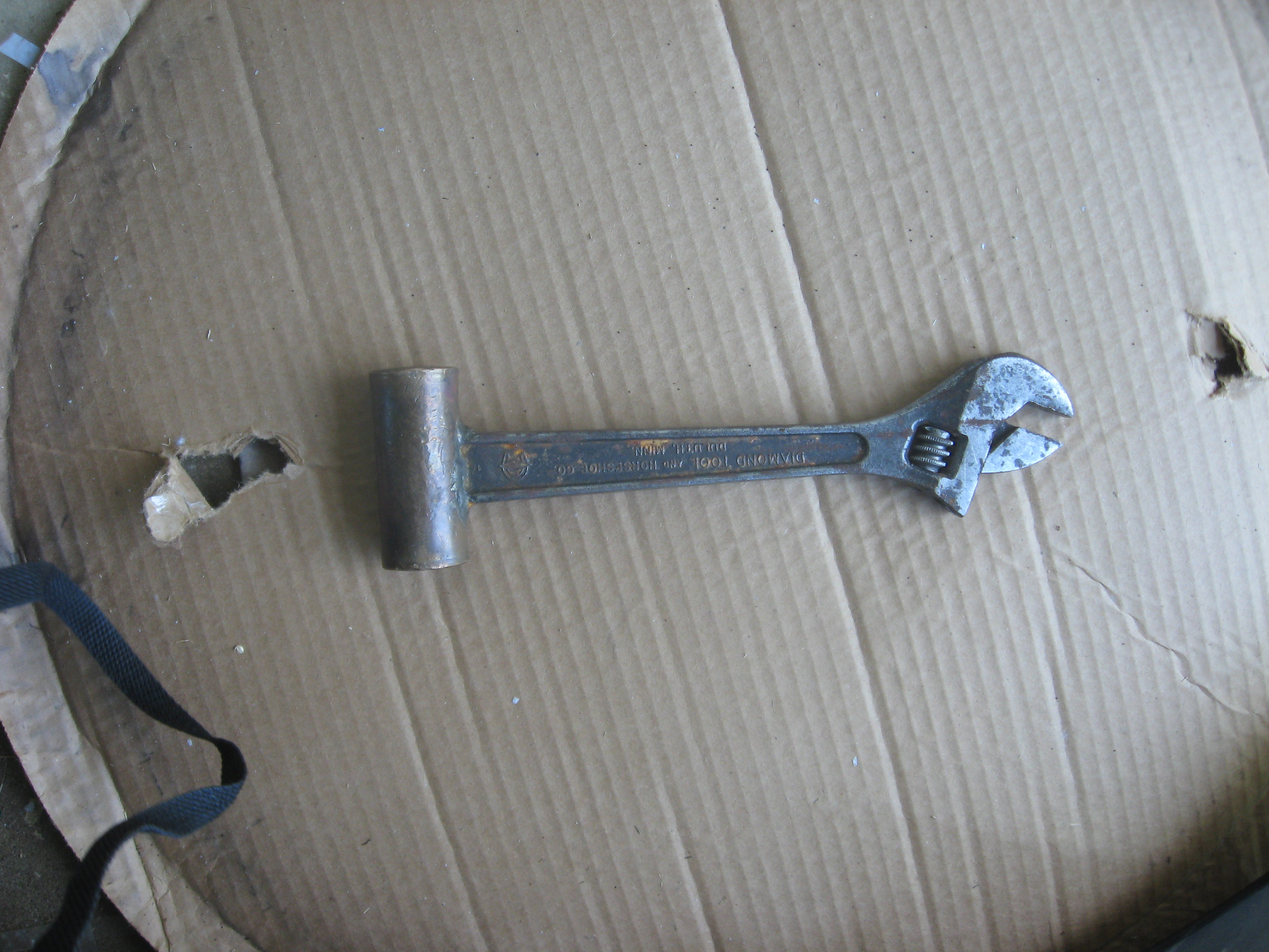

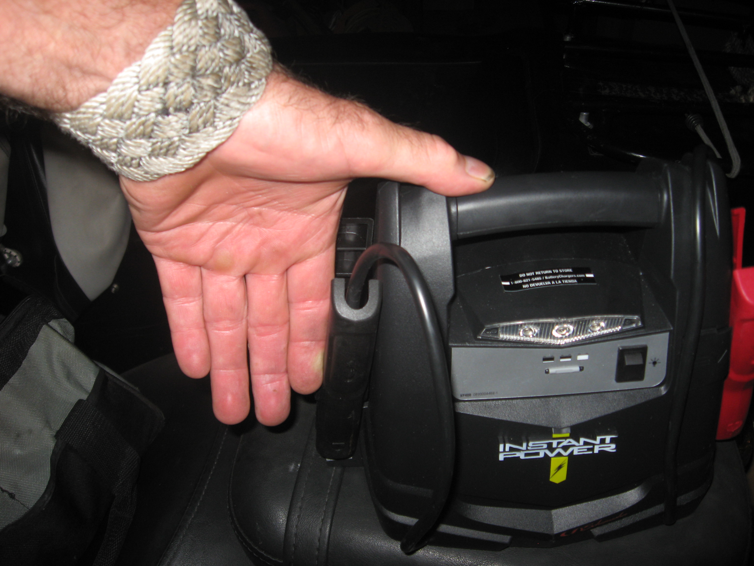

but they become welcome ballast for many rigs. Along with a multi meter and feeler gauges and things not carried by many two wheelers, I carry a crescent hammer, (of my own design), and a jump start battery. The jump starter is quite small as seen alongside my hand, but it could save you or another rider an expensive call for help out on the road.
The crescent hammer is a piece of bronze shaft with a slot milled into it then slipped onto the wrench handle and silverbrazed. Very effective with impact wrench as well as other forcefull duties.
