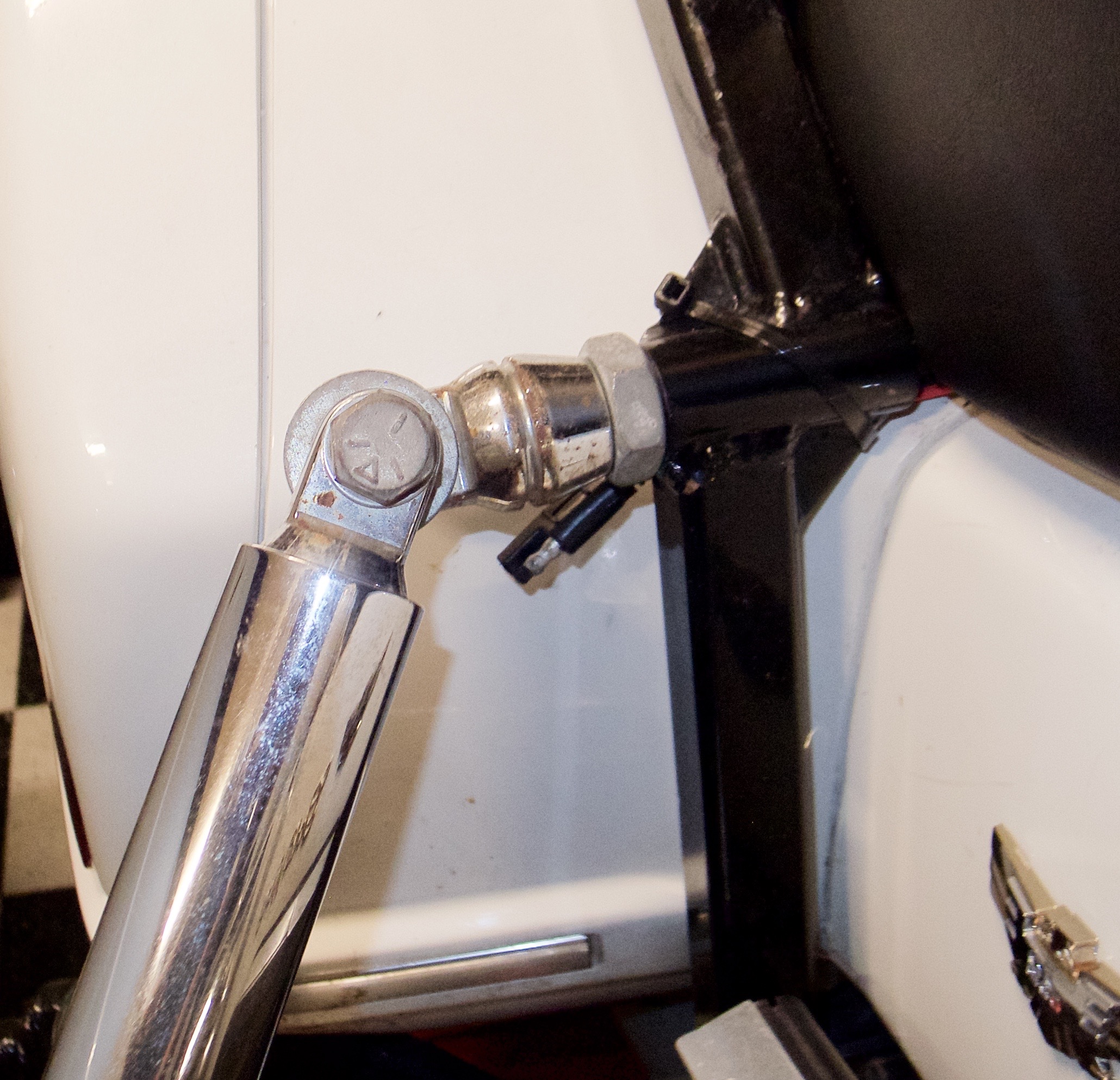

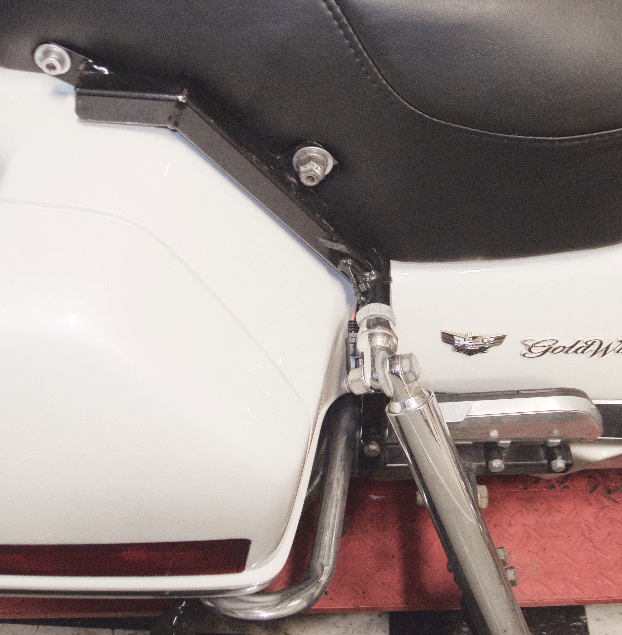

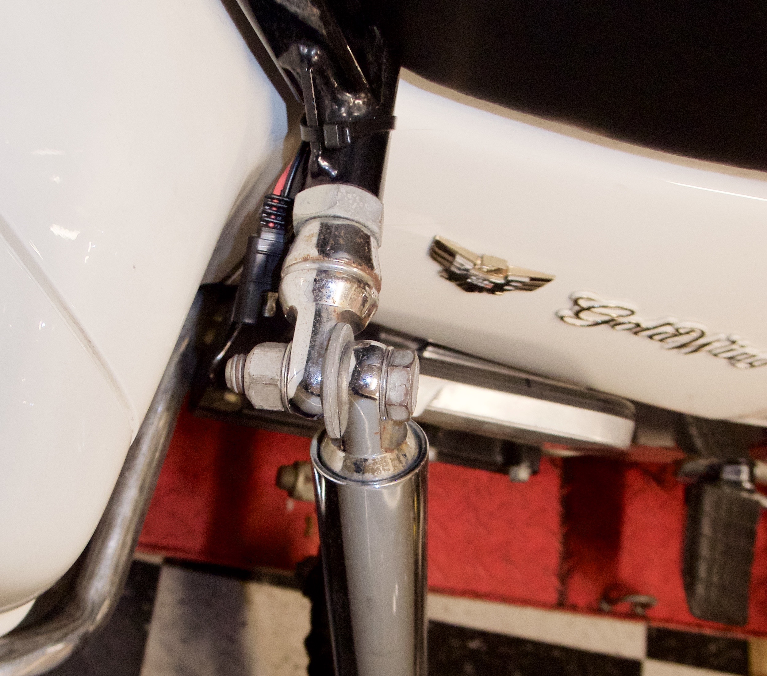

Hope these photos help: Gl1500 with Champion escort sidecar.
Posted : April 6, 2016 5:54 pm
The way we attach the upper part of the rear sub frame is to drill out the hole for the lower grab bar handle which allows for a 1/2 inch bolt to pass all the way through the frame of the bike under the seat. As it then needs a nut on it and as you would not be able to put a wrench on the nut with the seat in place we weld the nut to a plate that is then pop riveted to the frame of the bike. This is some thing that a person at home can do were as welding a nut on most people would not want to do. This set up also of course requires a spacer be made to replace the stock spacer for the grab handle. We do also of course make a full mounting kit for your bike.
