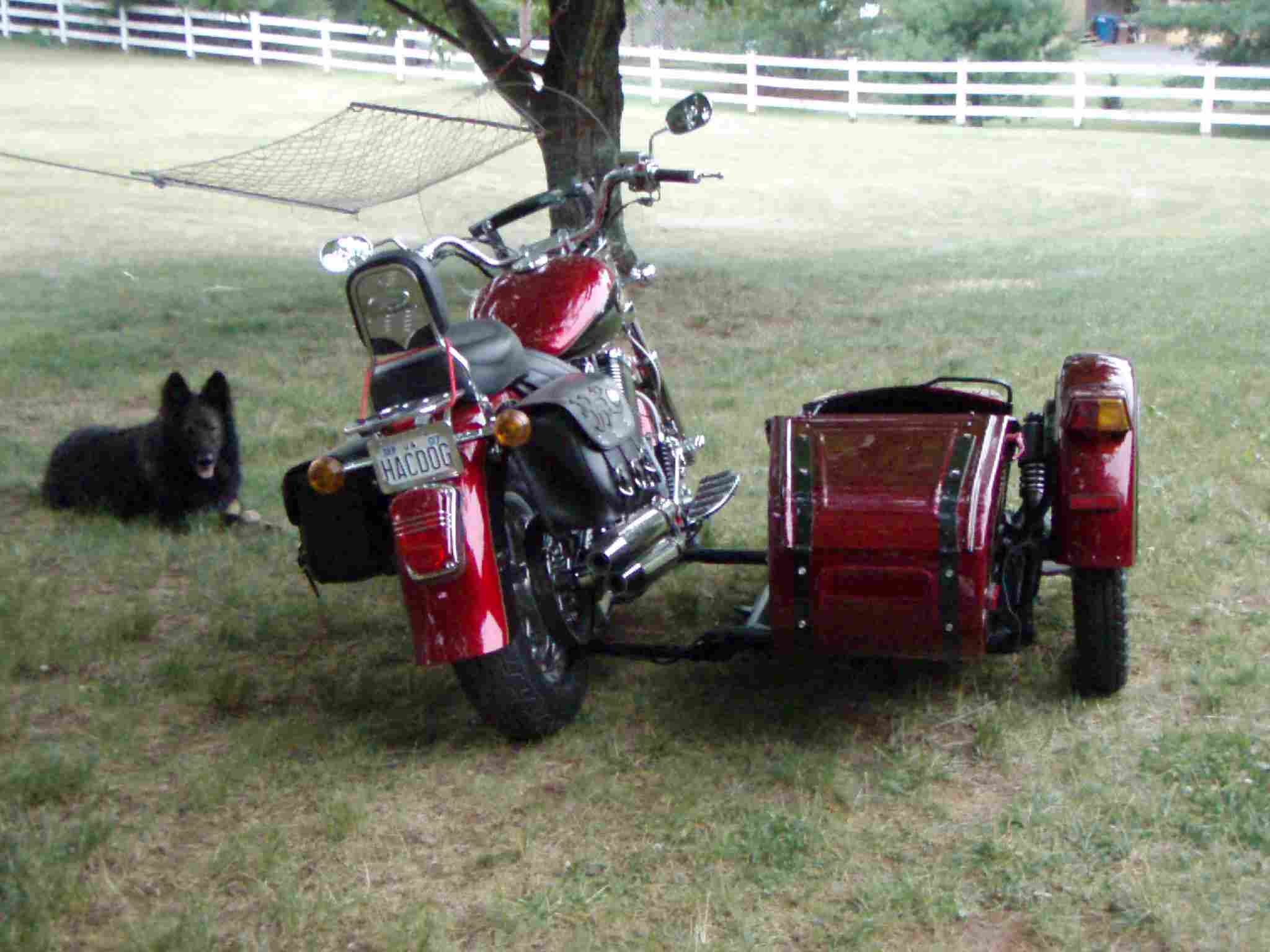

I've done both and by far I recomend the articulated design. Purchased a '97 Ural Tourist a couple of years ago so I could take my dog Taylor riding, (100 lb Shepherd). Did two 100 mile plus trips and after getting home thought they were about 90 miles too long.
Started looking into articulated sidecar design and felt I could do this myself. Modified the Ural frame by lowering it about 7 inches and attached Hiem joint type rod ends. Fabricated mounts that bolt to a '99 Victory V92C 1507cc motorcycle. Bike leans nicely through the curves now and of course the bigger bike is much more comfortable than the Ural 650cc. A 250 mile day is no problem now. And Taylor is quite the Babe Magnet which can't be bad. Also, it takes me all of about 3 minutes to to remove the sidecar and be back on two wheels again.

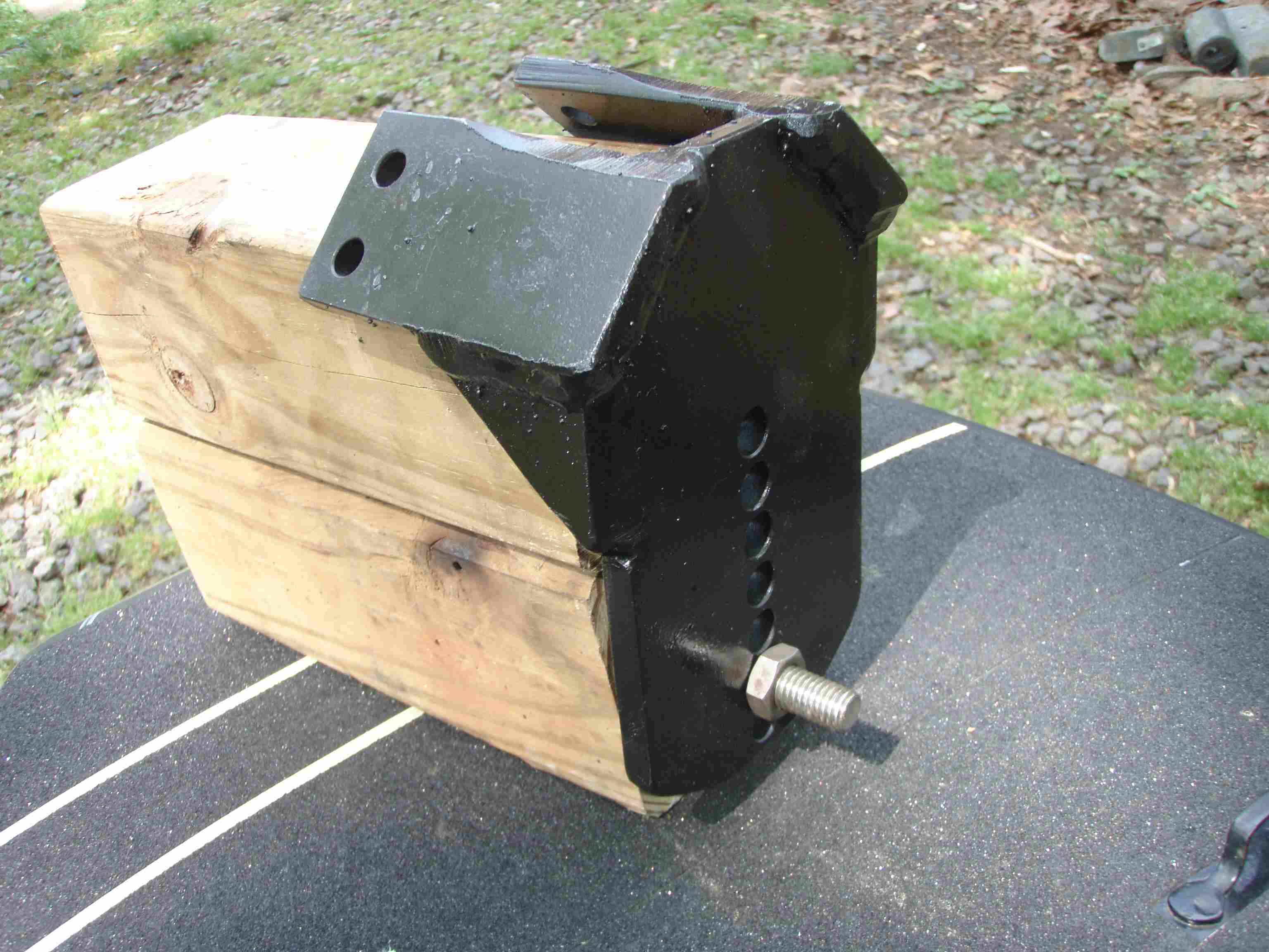

For the articulated set-up I tried to copy some of the other designs I've run across on the net. Had a lot of nay-sayer when I first started considering this system. Seems they were all against it yet had no personal experience. Just thought it through and then started fabricating. The Ural frame sits much higher than the Victory frame so I cut the swingarm pivot mounts off the underside of the frame. Welded two spacers to the top side of frame and then rewelded pivot mounts to the spacers. Then cut the shock/fender mounts from the frame and added similar spacers to them. This dropped the frame by about 7 inches, about the same as the Vic's.
I cut the tub's mounts and moved them as far outboard as possible so tub is just clearing the shock absorber. This essentially allows the wheel to be closer in to the bike yet allow the sidecar clearance from the swinging bike. I wanted to keep the moment arm as close to the bike as possible.
The front frame mounting socket was cut off and replaced with a Rod End.
The rear frame mounting socket was modified to accept a similar Rod End.
The original rear frame mounting socket is offset and rotates which will allow you some adjustment to the distance between the two mounting Rod Ends.

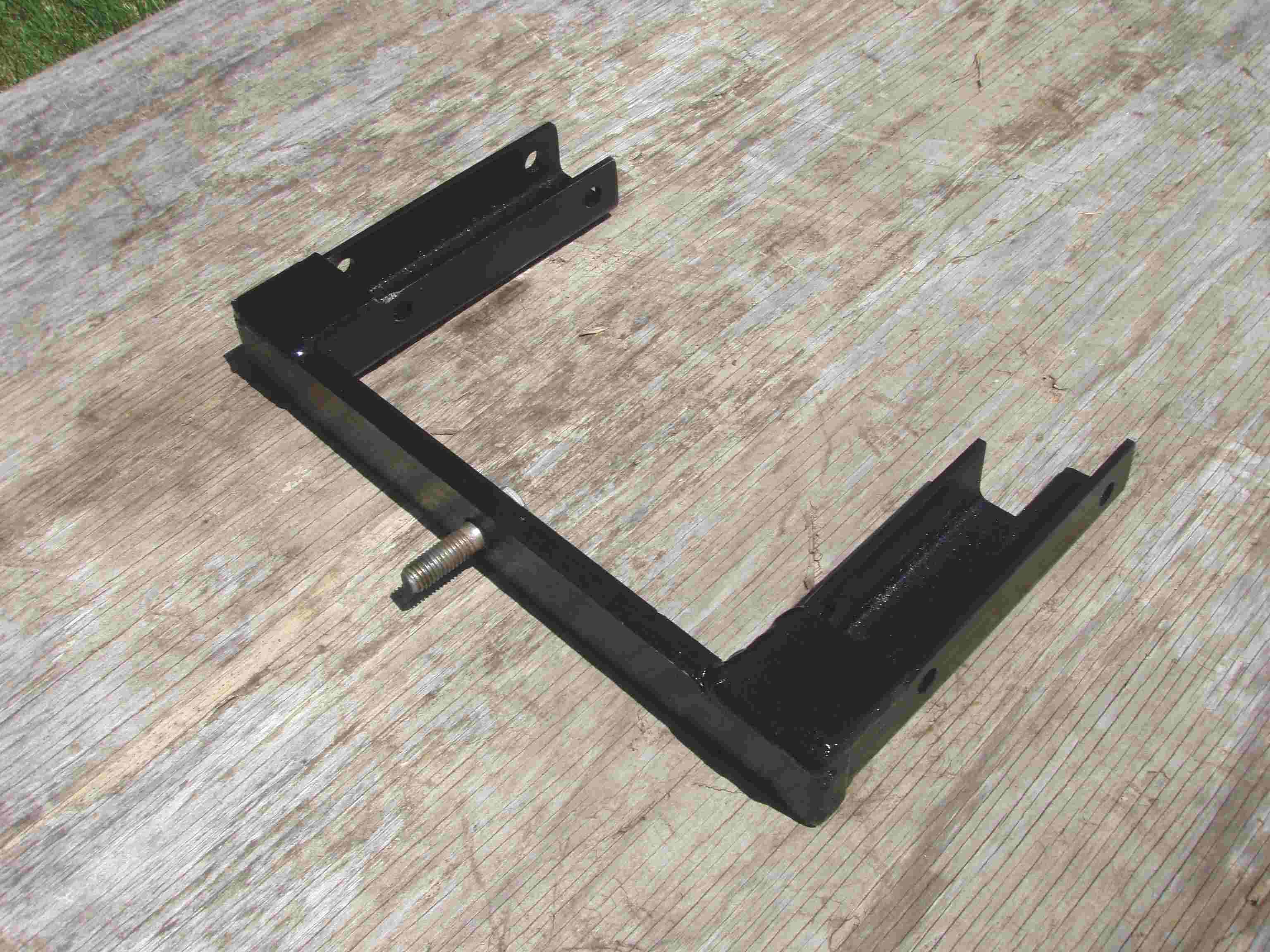

At this stage two mounting points are needed on the bikes frame. I used the front floorboard mounting bolt holes to attach a cross frame just ahead of the engine. A hole in the center of this cross frame provides the front Rod End a bolt hole.

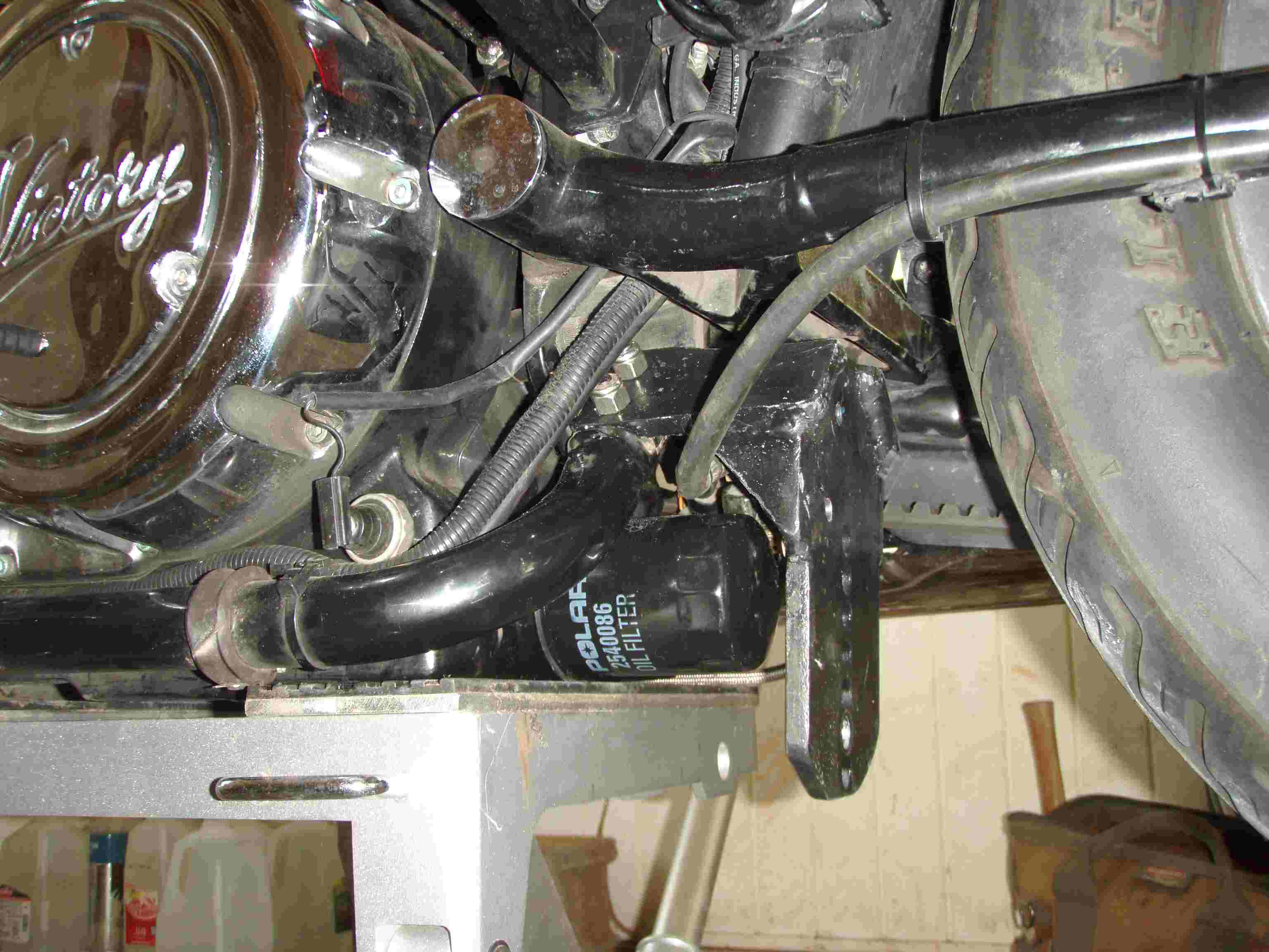

For the rear I fabricated a mount that bolts to the frame and engine "wishbone" that sits just head of the rear wheel. This mount consists of heavy flatstock hanging down between the rear tire and back side of transmission. A hole near the bottom of this vertical hanging flatstock provides the bolt hole for the rear Rod End.
Had to do some "adjusting" to the exhaust system to provide frame clearance on tight right hand turns. Also had to move the oil cooler a couple of inches higher for right hand clearance. Granted I can not get too aggressive on a righthand turn before running out of lean angle as exhaust system contacts attachment arms. But with a bit of body "English" normal speed limit curves are not a problem.
