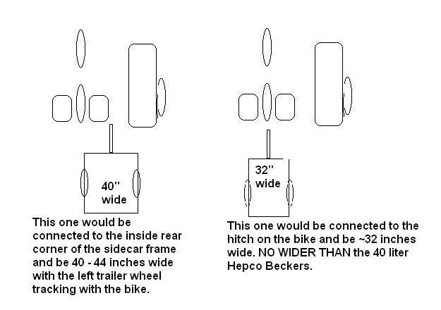

Here is a diagram of the two hitching positions I am considering.
The one on the left is MOST COMMON and I am aware of the additional 'right pull' or 'torque steer' forces having the trailer connected here will impart to the outfit.
The one on the right is the one I would most like to do.
The connection being centered on the driven element means there will be no additional 'right pull' or 'torque steer' forces imparted to the outfit and therefore should be less disruptive to its performance.
Photobucket
Posted : May 6, 2008 6:28 am
On the Goldwing I found I had less drag with the left trailer tire directly behind the motorcycle tire, but again, the only time I had a problem was soft gravel, like road construction, or snow on the road.
I think the best will be to try it and see how it works.
Posted : May 6, 2008 6:54 am
Some good information here. It looks like I will need to experiment with the ocation of the hitch so as it tows correctly. I will start with it being centered with the whole bike/car and go from there. Thanks for the info.
