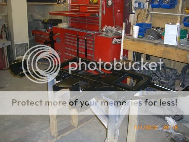

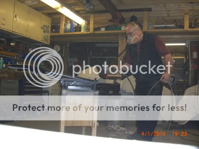

well tonight i painted the frame the paint stuck .the paint flowwed out good.
all parts painted and ready to mount to the bike

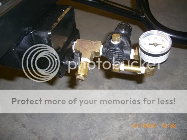

This is for you i fond it in my junk draw . its a 75 psi blow off valve. That should be enough pressure.
i dont need to blow anyone up.

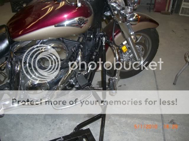

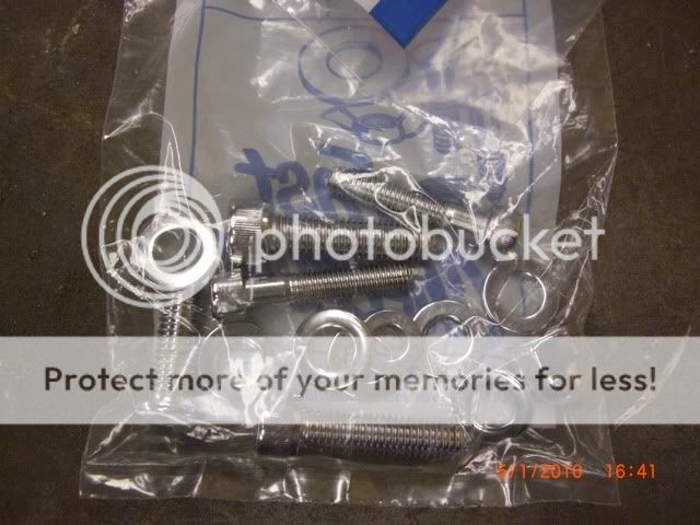

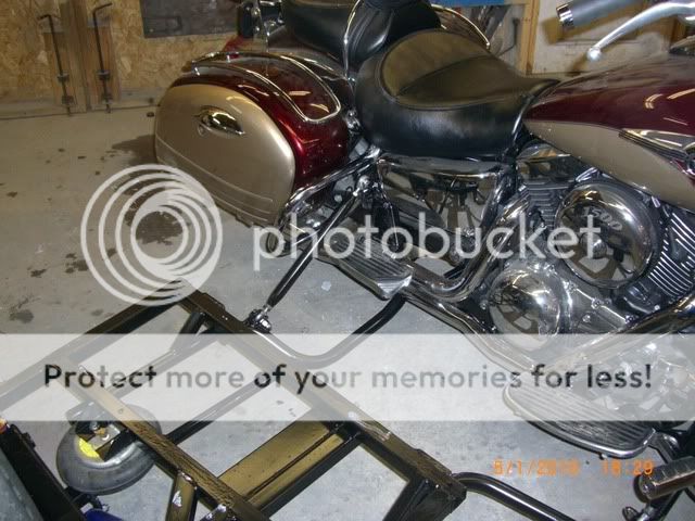

I was able to put the car on to night. I had to pick up some more bolts on my way home. This has always been the worsted part of restoring or building something nice. This bag was $30. I think I spent about $60 altogether.
The car mounted
I checked the toe I had ¾ over 8 feet. I set the lean to half a bubble very technical.
Question. When setting toe what is the right length to use. I used two 8 foot lengths of pipe one on the bike and one on the car.
next thing will be the air lines im thinking steel.
