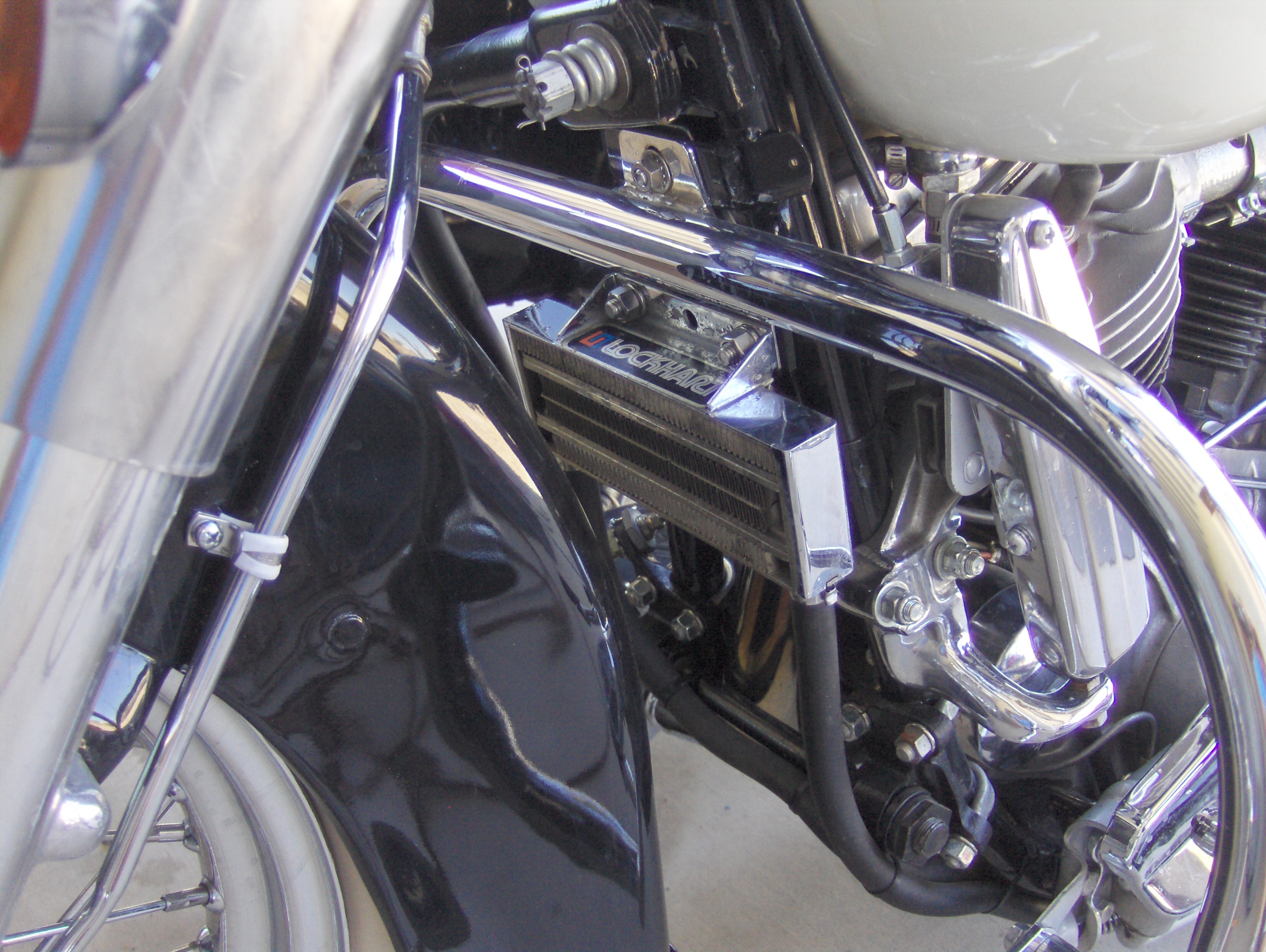

I'm trying to close some of the threads I started. I ended up putting a chrome Lockhart 500 on the panhead and it seems to be working fine. As someone suggested, I mounted it high by turning the "V" bracket upsidedown and attached it to the center crash bar bolt. The local run I was planning for ended today with air temps in mid-90's. It was a hot mamba-jamba. I went without the bypass valve but do have a cooler cover. I doubt I'll use it much here in SoAz. - AZP
