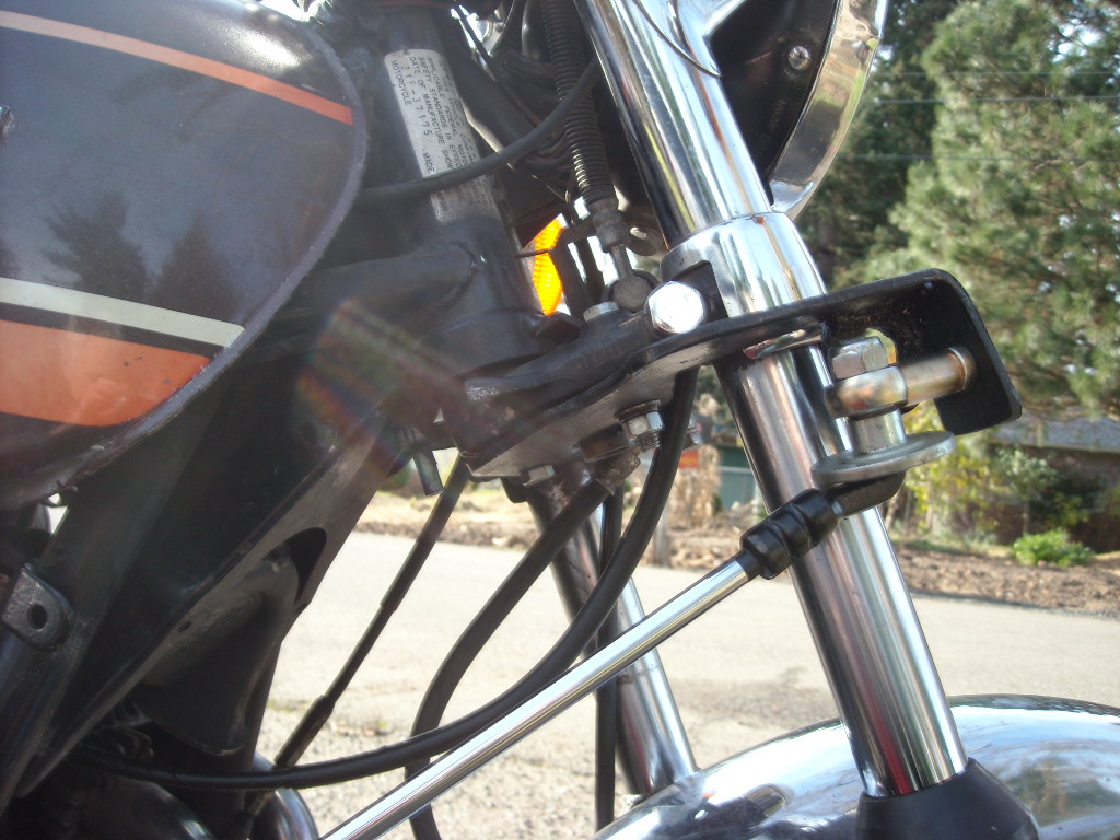

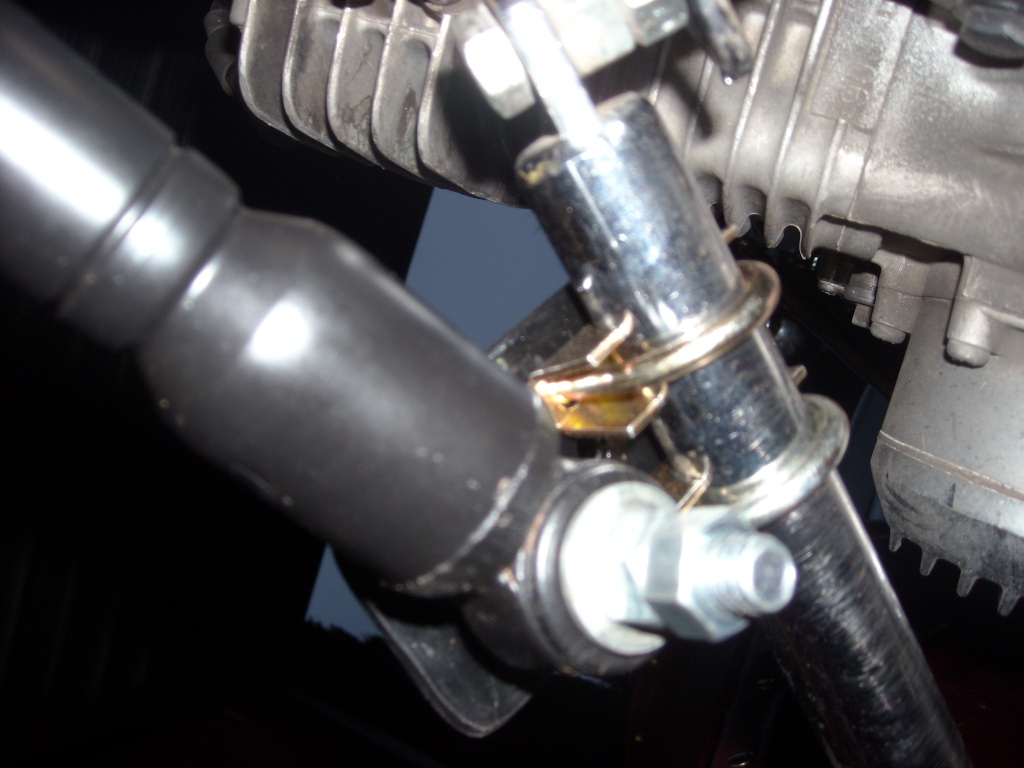

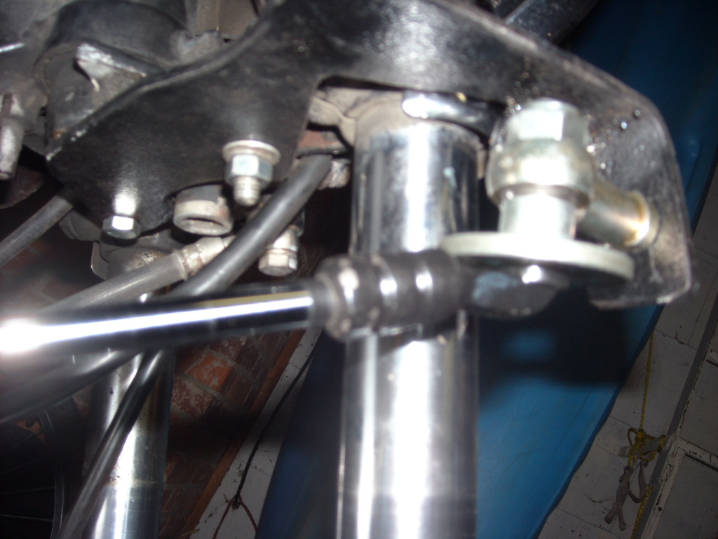

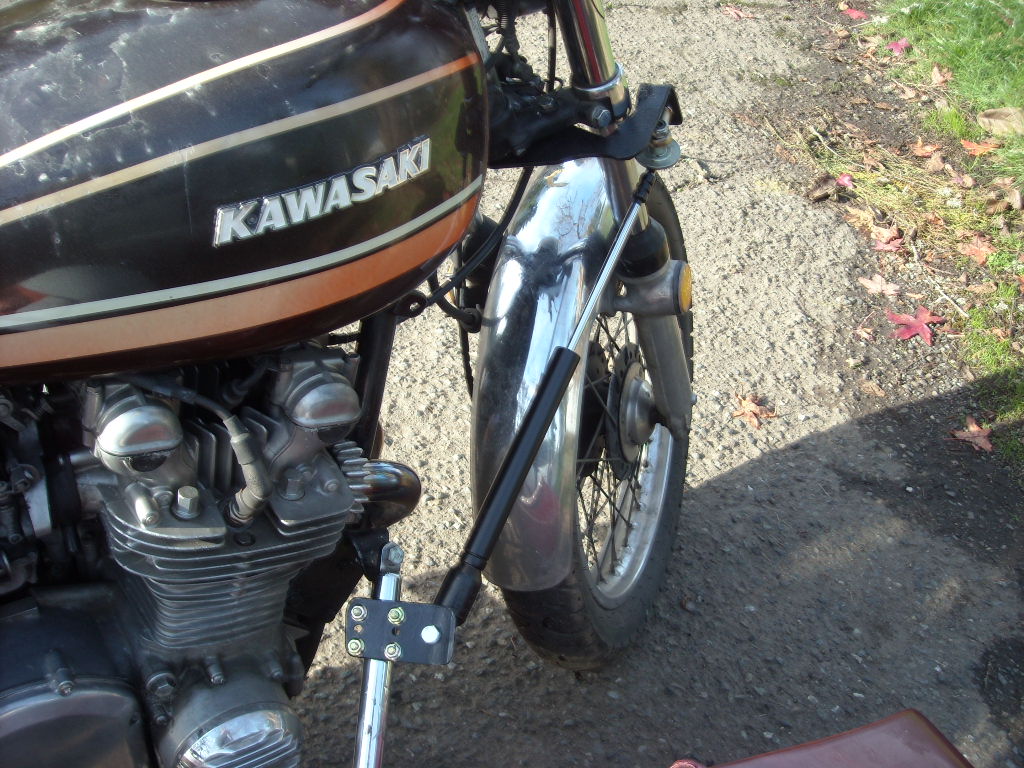

see if my pics of vw boge napa dampner will go part no 113425021 at a napa auto parts store the u clamps are napa 1 inch smog tube clamps + $30 total for parts the swivel is napa 732-1129 you have to use a dremel stone to make the hole from 3/8 to 1mm very small amount

Good looking set up. How does it work? Price of dampner only is showing over $40 here in Arkansas. Any chance of getting some more pix and part numbers for the whole set-up? Did you make the part that attaches to the forks? Thanks for your time.

I added it all on original post had 2 bolt holes already on bottom of fork housing and made plate we have account at napa and get discount. look at http://.sidestrider.com/steering.htm that is where I got basic info from or go to sidestrider,com and click on steering dampner it works super could drink a soda while driving like driving a car
