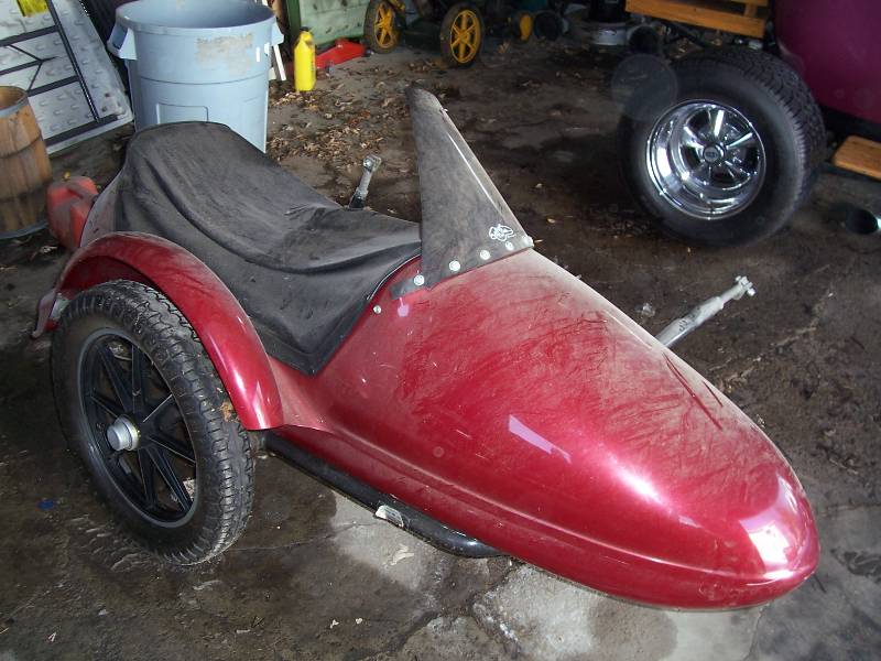

I bought this California S/C today. All attachment gear included and new windshield. I think I got a steal on it for $600.00

Garry,
Several mfg'rs. used this body mold through the years under different names.
California Sidecar, Spirit Eagle, Spirit of America to name a few.
The wheel, hubcap, frame and fender of your sidecar were unique to the early California Sidecar Companion or it's predecessor. The lineage is there. Perhaps they adopted it from the original maker of another name.
See sidecar #9 on page 9 of the USCA Sidecar Catalog, same sidecar a Companion.
I still think it's the same sidecar. The other clones used wire spoked wheels and the frame tubing was much smaller.
Got a pic of the other side and the taillight? What size axle?

Garry,
Your authority from the present CSC Co. may not have even been born before 1988. lol
The windshield decal also looks like the early CSC logo.
It is a good idea to upgrade the mounts on these pre 1989 CSC's since they had nice upper struts and mounts but tiny ball and collet lowers that whave been known to fail and release the sidecar.
1989 and later models went to 5/8" heim joint (rod end) lower mounts which are still used today. They also upgraded to coil over shock swing-arm suspension that year.

If it has the heim joints and a coil over shock suspension it's 1989 or later. If torsional suspension it's probably a changeover model '88/'89.
The heim jiont style bosses we're an available upgrade for years that slipped right in to replace the original collet type bosses and clevis style frame clamps replaced the older ball mounts.

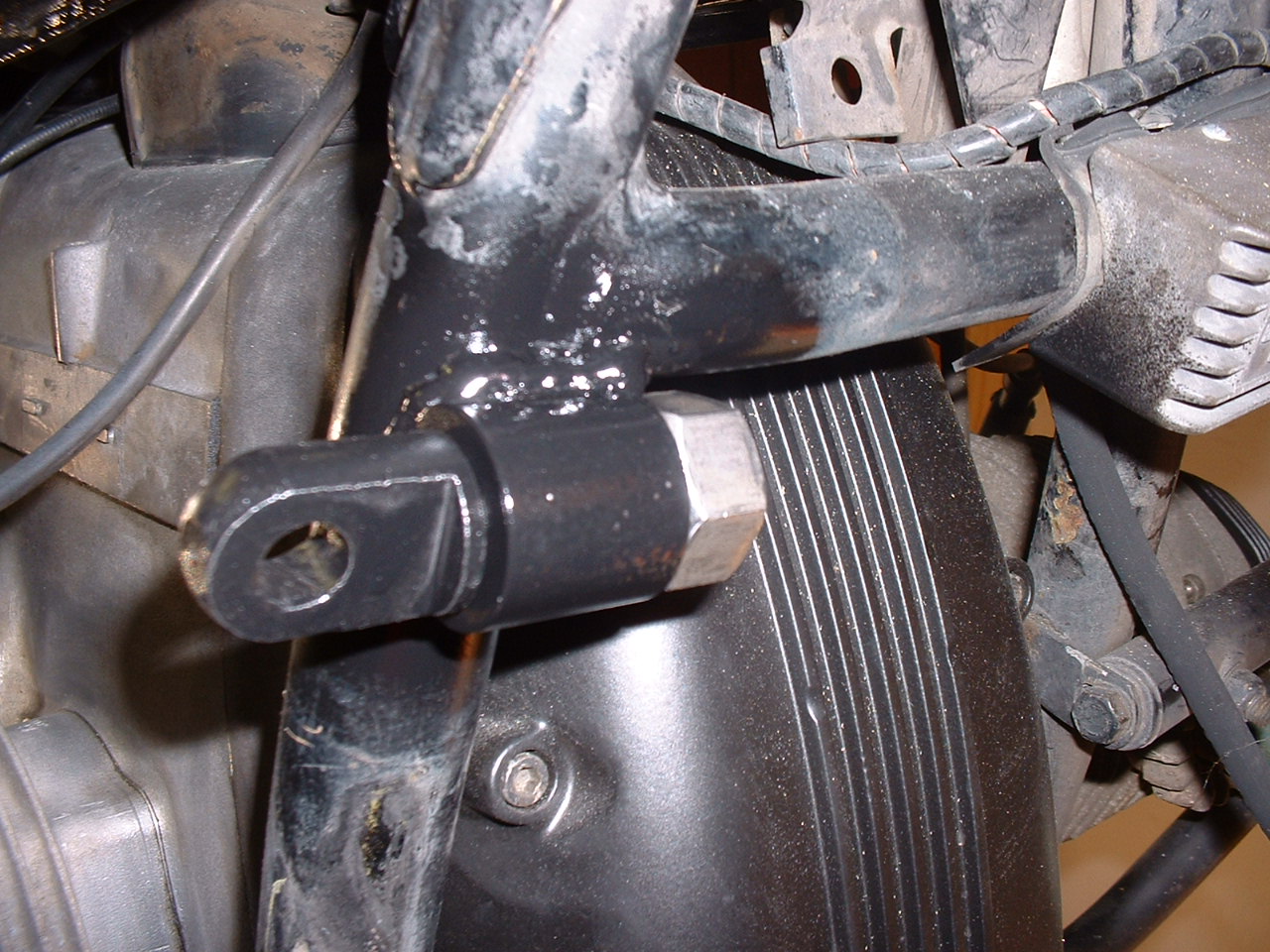

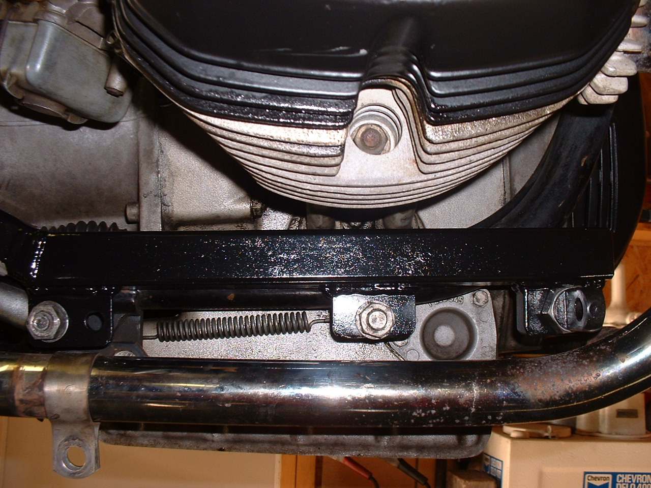

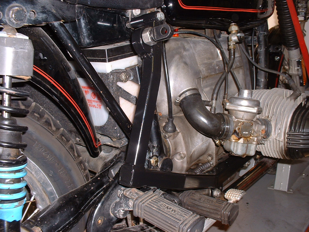

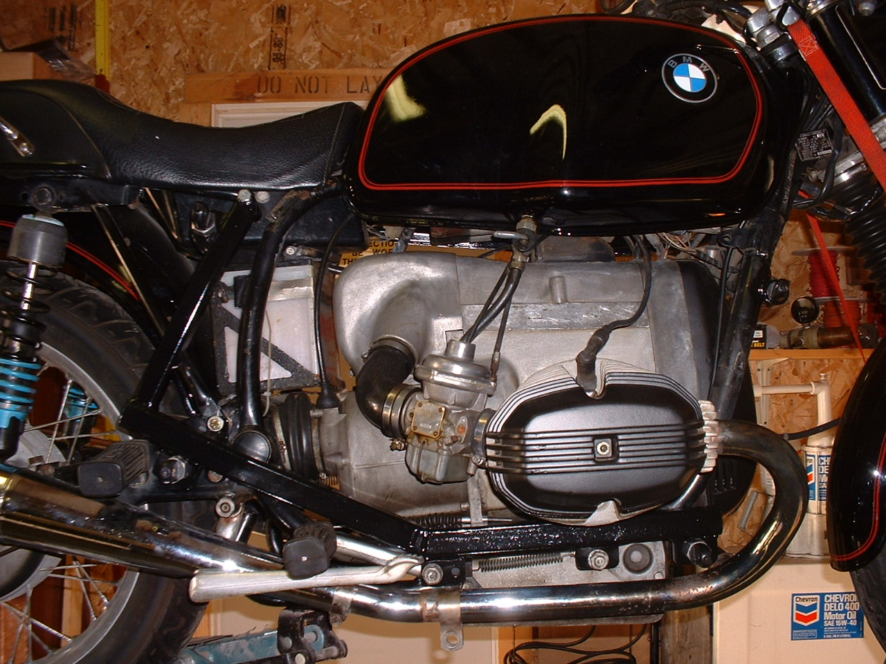

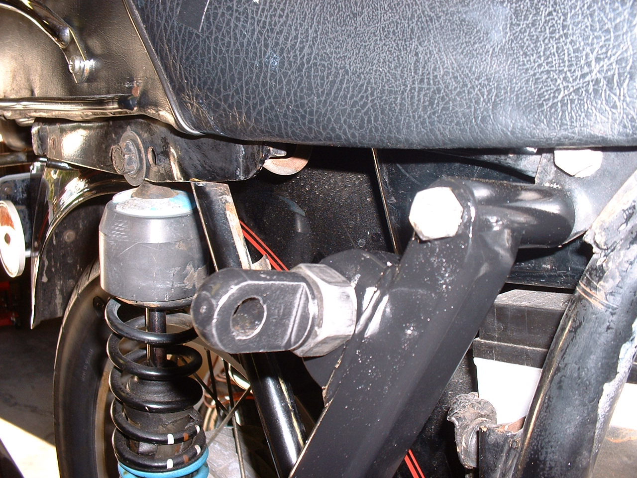

Your Beemer will need a sub-frame for solid mounting of the car. These are available through vendors listed on this site or you can make your own for the bike.
Here is a simple but solid sub-frame for a /7 fabricated from .120" wall square tubing.
