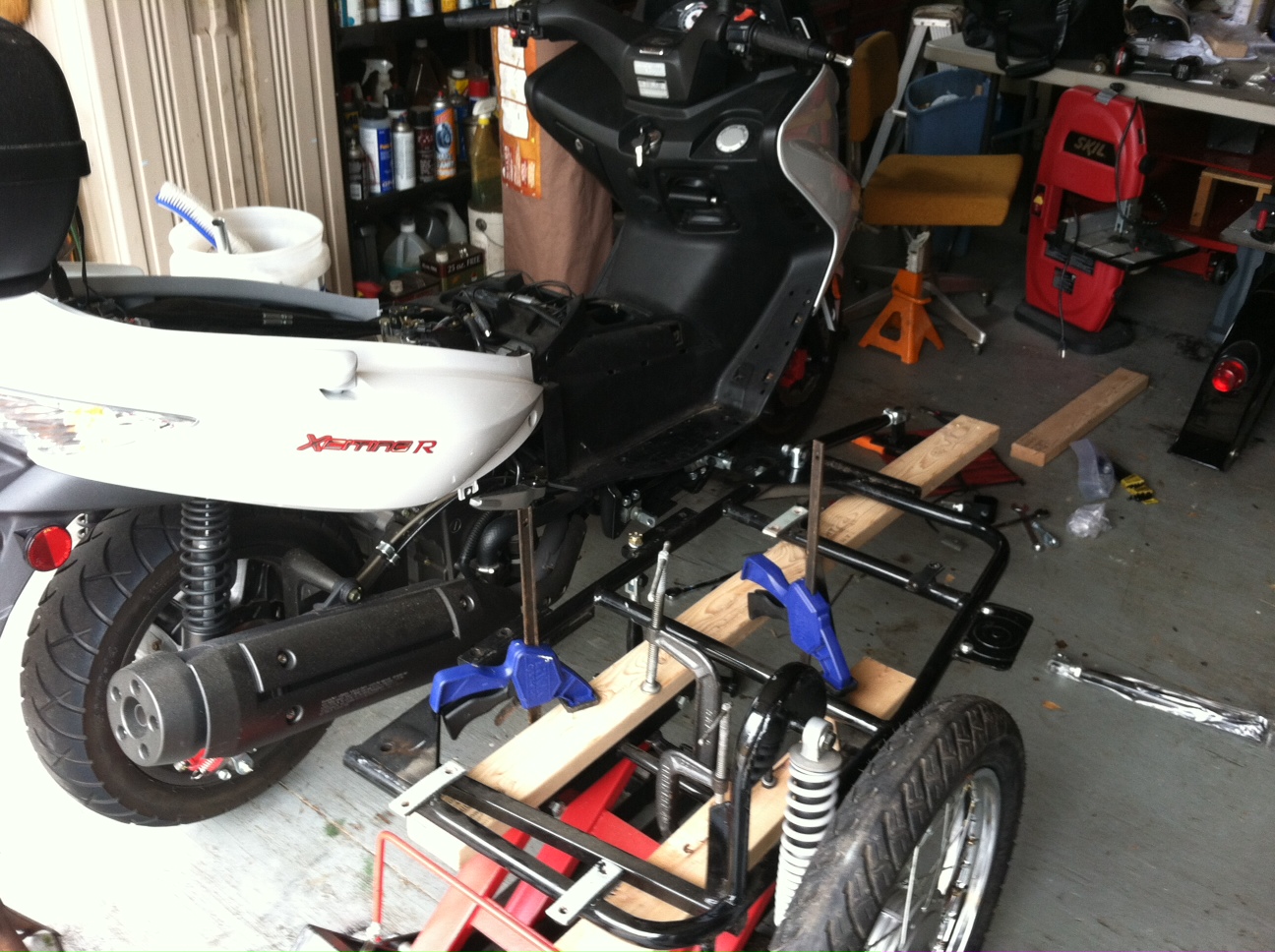

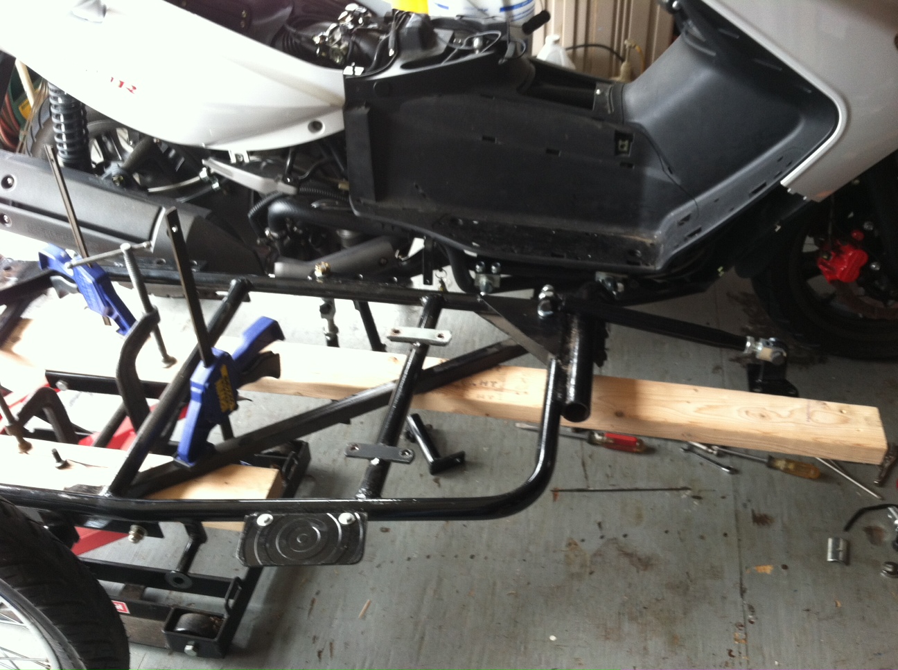

Jay, Thanks for the great advice. I have stripped the plastic off my scooter and put in a wheel chock in my shop floor. I have placed the sidecar frame beside the scooter and begun trying to fit it to the scooter with the universal mounting kit. The mounting kit that was supplied by saferwholesale.com is for a motorcycle and the front (main) attach point fitting will not adjust low enough for my sidecar to be level. They are supposed to be sending me a universal scooter mounting kit. Hopefully it will hang lower from the sidecar frame like I need. Steve from Trike Zone, in Ontario, Canada, sent me some great photos of the mounting brackets and attach points on a Kymco 500ri and Cozy sidecar rig they have in their inventory. I like the way they did the lower attach points but not too crazy about the upper mount which attaches to the grab handle on the rear seat. The pics did give me a clear idea on how to do the lower mounts. Hopefully the mounting kit saferwholsale.com is sending me will have similar hardware in it. I have learned that dealing with someone that sells thousands of items and does not specialize in a particular item is not the best place to buy. Cheapest price is not always the best way to go.

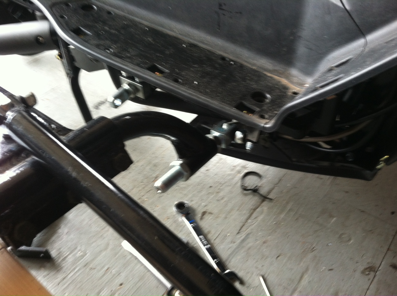

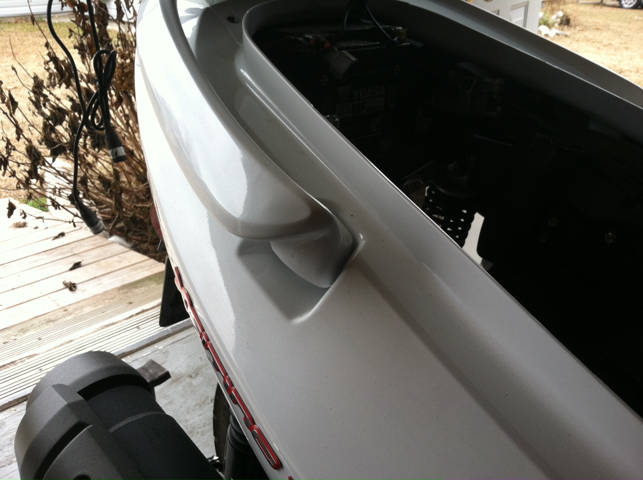

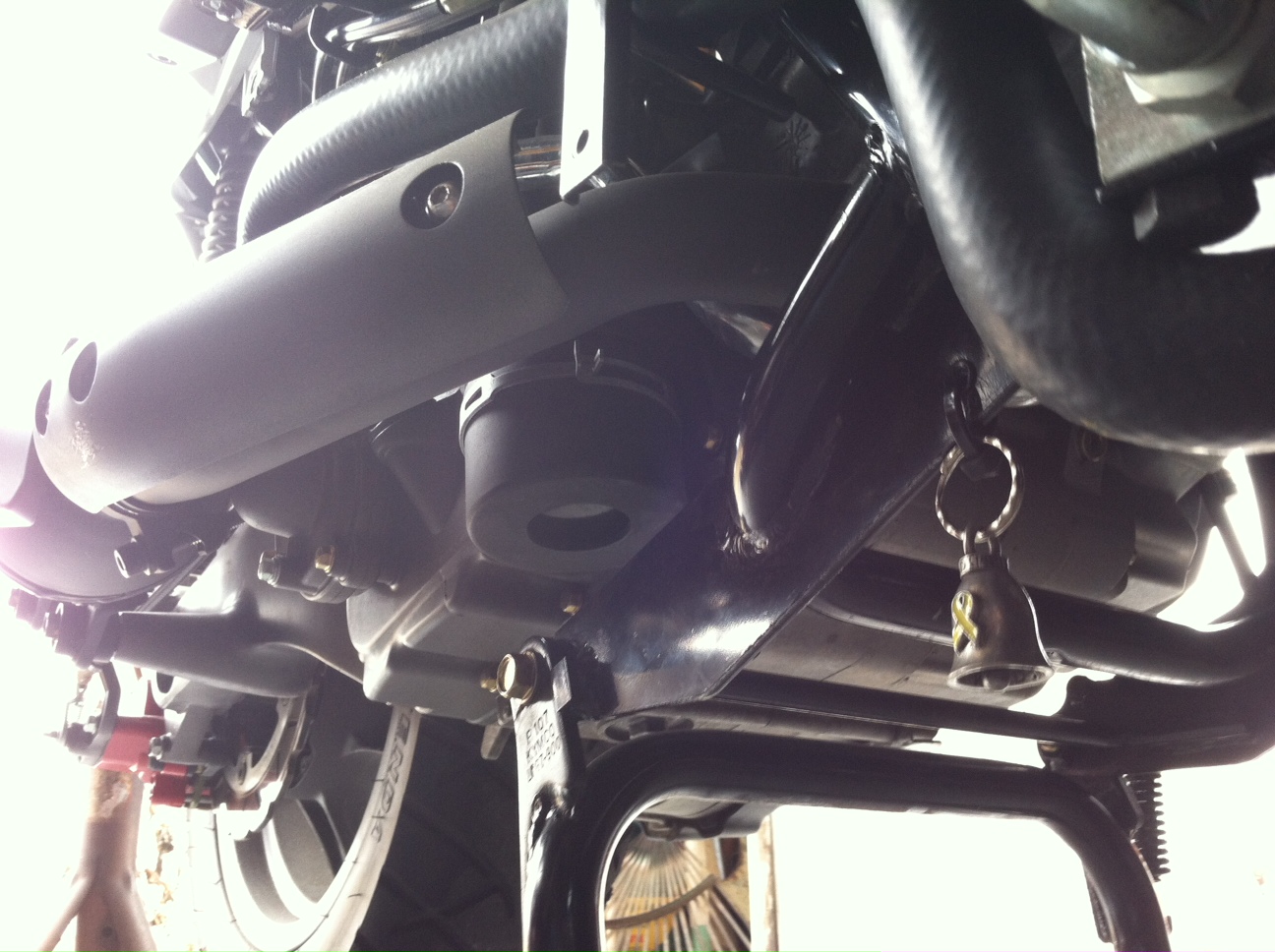

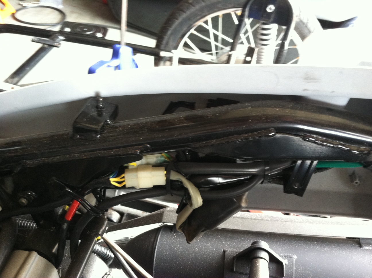

I am attaching some pics of the scooter sans plastic and of my first attempt at locating attachment points. These pics with the fittings from the motorcycle mounting kit. Jay, please feel free to make more suggestions as you see fit, especially concerning the upper attach points.

Posts: 1774
Hard to tell a lot in the photo's however the lower mounts as shown are way to close together. In general "universal" clamps are not a great way to go. I would for the lower rear mount make a proper mount that replaces the center stand. This would move the lower rear mount aft and as such would give you getter triangulation and being a proper mount would not tend to slip and rotate. Not sure if it would work on this scooter but we have been known to on the upper rear in order to get a good strong mount cut out the bottom of the trunk and tie the mount to the left side of the bike.

Posts: 2029

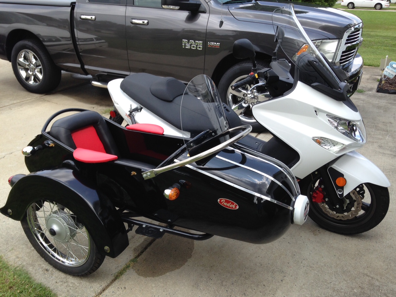

Just a first impression from the last photo:
I feel like the sidecar tire is a bit too far back.
That reminds me to my MZ sidecar which tended strongly to dip the ground.
That effect was so tough that I was urged to mount a PE sliding patch in the right front corner for not to get caught by the typical cobblestones used where I grew up.
Too far to the front and you cannot turn the rig. It would be good to measure out the dimensions and post them here. Claude, Lonnie, Jay or one of the other installers will be able to give you the right spot where the sidecar tire should stand in relation to the bike's tires.
Have fun with the project, but stay on the safe side, as that are YOUR bones that will be risked.

Posts: 8
Sven, The literature I have read say the sidecar wheel should be 8 to 10 inches ahead of the rear wheel on the scooter. Right now it is just over 8 inches ahead. As soon as I get mounts that will allow proper adjustment I am going to try moving it a little farther forward. I am now looking at drilling a hole in the steel web that goes from the lower side frame rail and the center stand (just behind the guardian bell in the picture) to locate the rear lower mount. I have got to get away from the frame mounts that can slip or turn on the frame. Probably will cut a hole in the plastic near the grab rail on the seat and put a top mount directly off the upper frame tube there.
This is definitely not what Saferwholesale.com told me when I placed my order. They told me it was simply a bolt on installation.

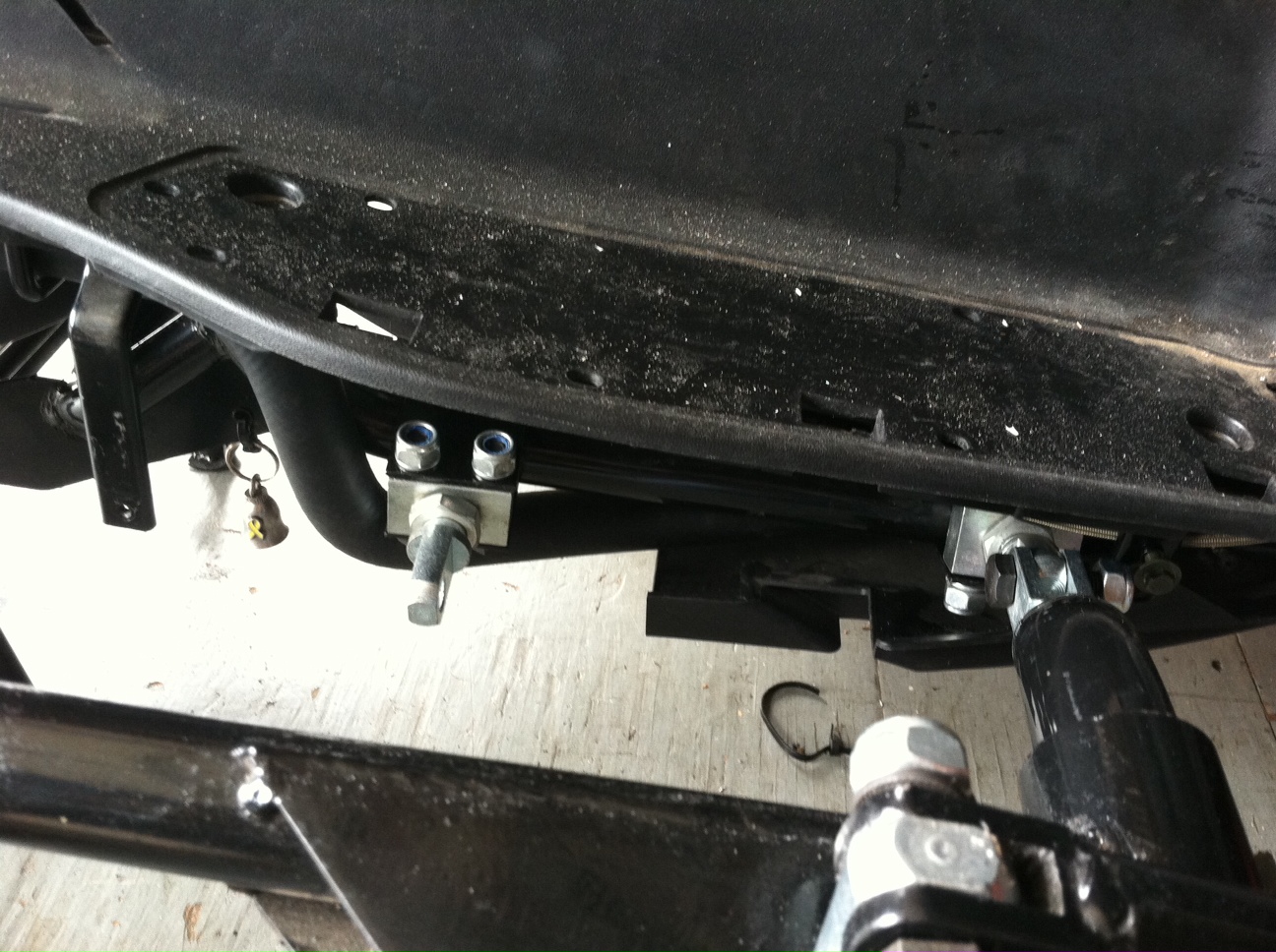

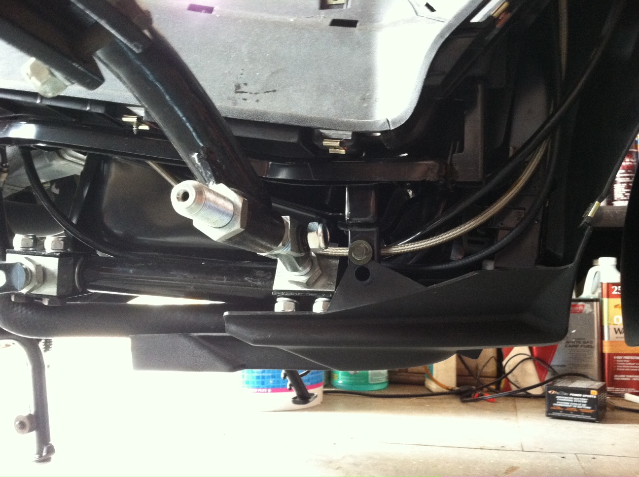

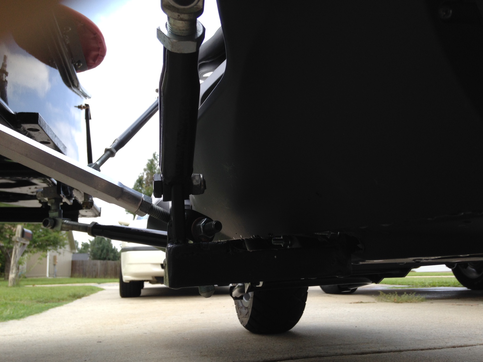

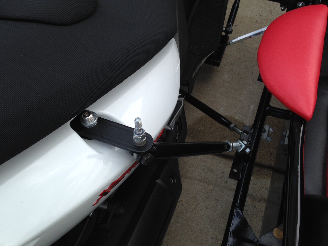

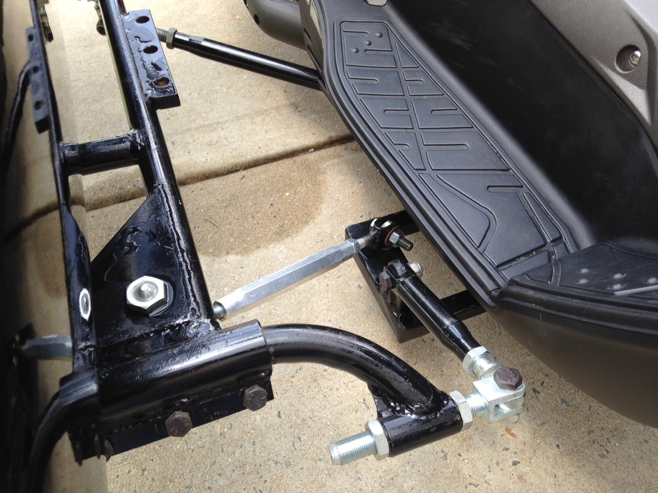

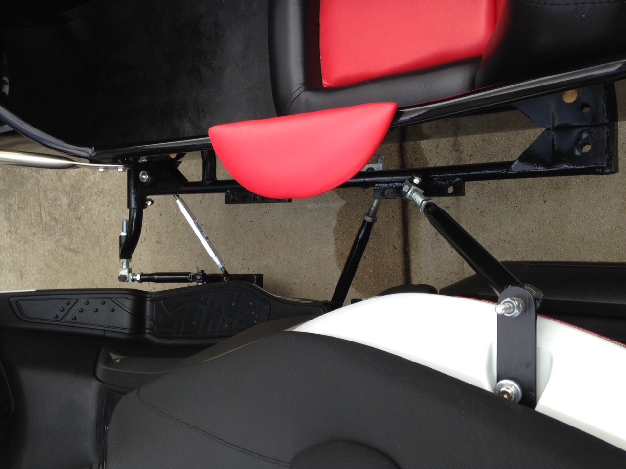

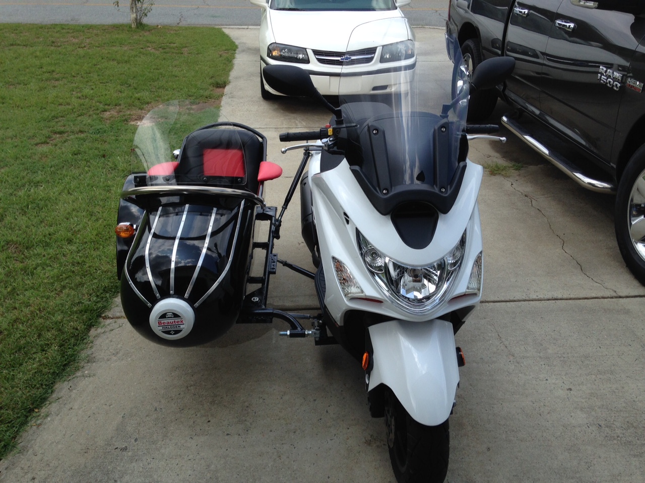

Well folks, after many months I am close to having a useable sidecar rig. I had to fabricate a complete sub frame to attach the side car to. I have three lower mounts but only one upper mount. I have still got to figure out where to mount the forward upper mount. I have ridden the rig around town and it does ok except for a little head shake and a little too much flex between the scooter and the side car. I rode a friends sidecar rig today for a comparison (an early model R100RT with a ural side car) and really mine rides better than his in some respects. Here are some pics I took today. Any suggestions are greatly appreciated. Jay at DMC has already told me I need the front upper mount and need to move my back upper mount to a more straight up position.

More pics

Posts: 2029
Hello Steve,
Congratulations to the advance in your project.
The position of the sidecar wheel looks good now viewing it from other angles.
BUT THE MOUNTING CONSTRUCTION HAS ME PUZZLED...Did You hire Harvey the 2m tall "puka" to hold your sidecar in position?
I would not even have made a round on the farm with it.
Sorry, but we cannot disobey physical laws. If so we pay VERY EXPENSIVE...
I know 2 machine operators with crippled hands for much less uhhh---/negligence factor. (in fact for a simple 12$ check valve their maintenance engineer did not want to install / when I came back from hospital myself I took those 12$ out of my personall wallet and made the machine safer)
First steps first...please, before you ride out again get that front strut working.
Good luck.
Posted : August 11, 2015 4:30 pm

Posts: 8
I think I have figured out how to get another upper mount without blocking the floor board. I'll work on it as soon as the weather around middle Georgia gets a little cooler. Welding and grinding in 95 degree weather with high humidity is not fun.
