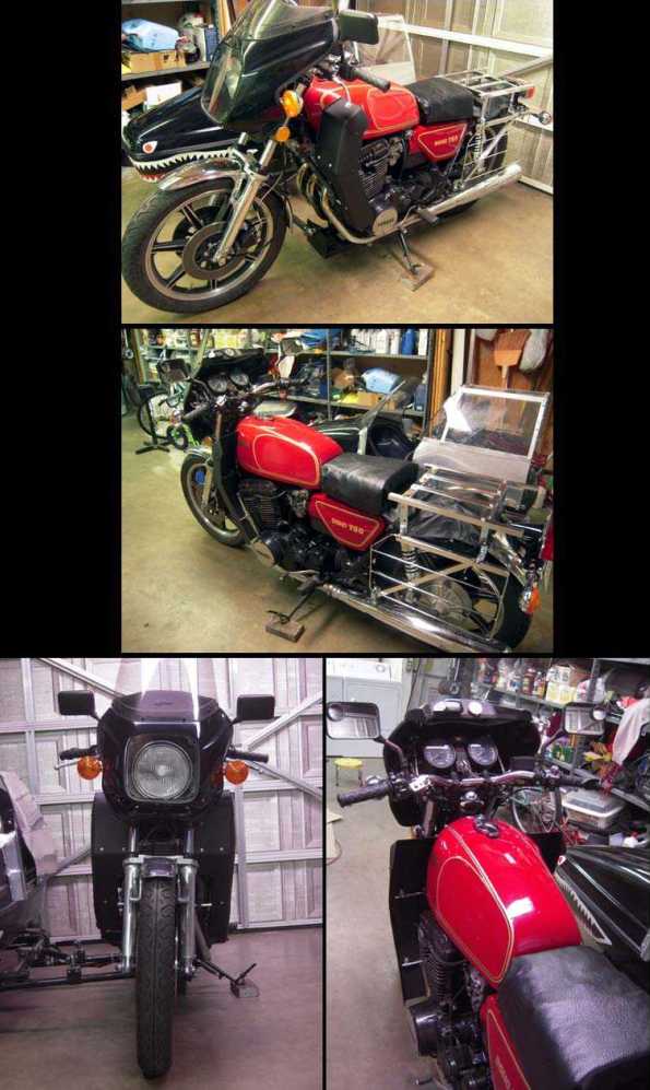

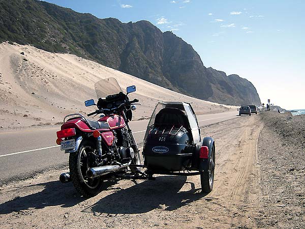

I have been riding my leaner rig for more than a year now (including some freeway travels @ around 70~80 MPH). No horror stories. It's just like a solo motorcycle. I got to slow down more on right turns because the motorcycle hits the sidecar and I cannot lean as much as left turns but much faster than regular (non-leaner) rig in similar configuration (track width and ballast-wise).
Oh, and maybe you should contact John Goff in Flexit forum. He is an Oregonian and currently owns Flexit rig and owned Equalean (another full leaner) rigs for a long time.
Posted : December 31, 2008 12:55 pm
Ahhhh,,,,,what did you have mounted on the front fender,,,did it fall off?
https://www.sidecar.com/megabbs/get-attachment.asp?attachmentid=2658
Posted : December 31, 2008 1:20 pm

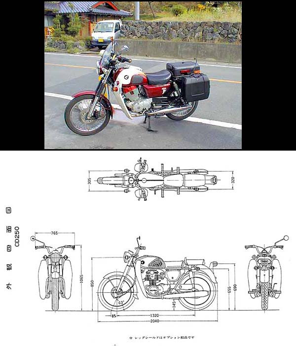

Are you talking about black stuff below the gas tank?
If so, it's a home-made leg sheild (like the ones on scooter).
I am into this "business motorcycle" theme. It's a category only exists in Japan. Prime example is Honda CD250. People like bank clerks, insurance salesmen, police box assigned policemen (not traffic cops) ride it for business.

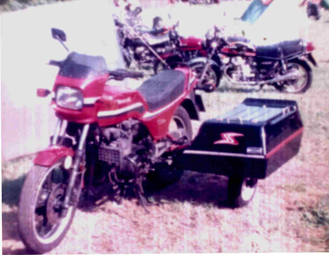

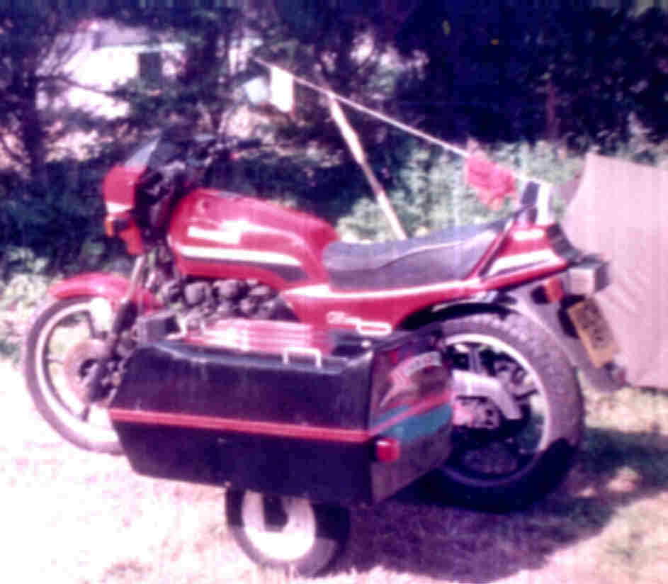

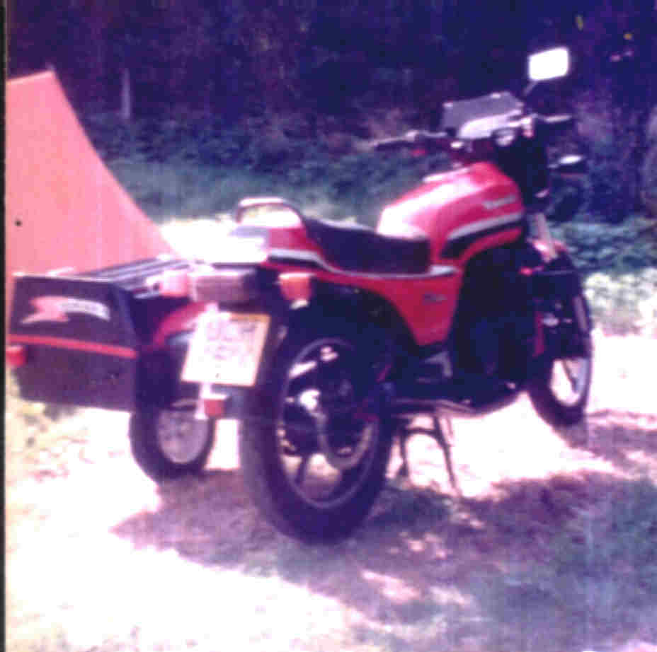

Here are some pics of the GPz500/Sidewinder outfit that my wife & I had in the early 80s. It consisted of 2 lightweight unsuspended parallelogram links, with a lockable luggage carrying body, which would carry our camping & fishing gear. On arrival we would dismount it& chain it to a fence.
On this outfit we did the "Boots & Saddles" rally at the 1984 IoM TT races & a camping trip to Newquay (from Derbyshire).
Fortunately I had already fitted the bike with a hydraulic steering damper kit, which was absolutely necessary
