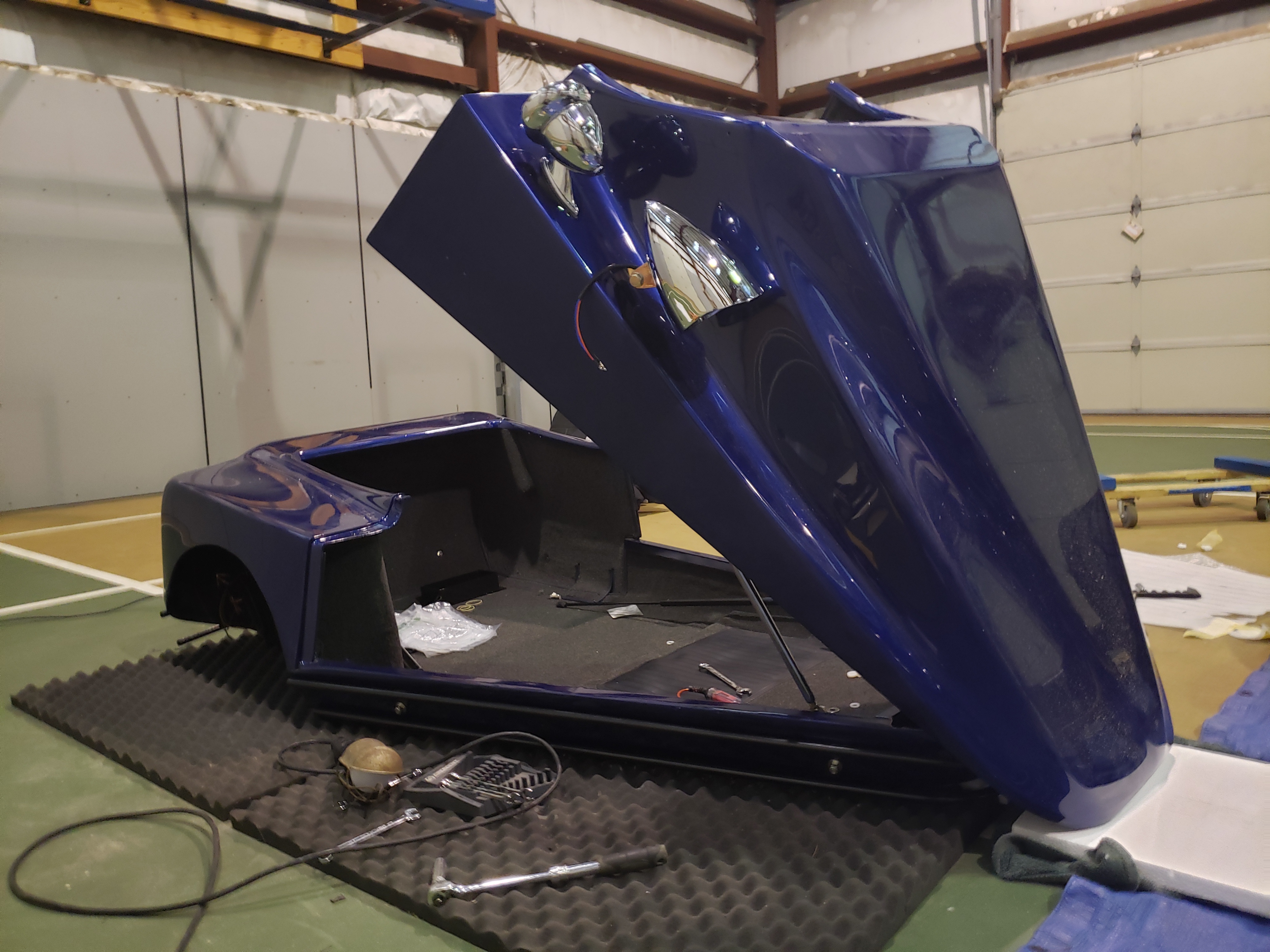

Hello i have a 82 gl1100 aspencade with only 18k miles and a motorvation formula 2 sidecar i am also looking for pictures of where to mount the clamps on the bike. If you find any pics would you share your pics. I just completely repainted the bike and sidecar and all new upholstery trying to get it ready for spring. Planning on spending a few months on the road exploring the ghost towns of the west. I wish you luck on your project. And many miles of smiles and happiness.. Robert
