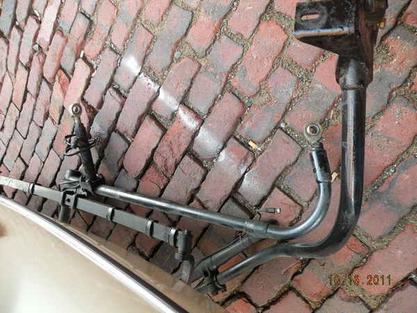

Its actually an RLE sidecar I'm thinking about getting, I don't know the year yet. I think the only thing I would need to change on the sidecar itself is the front upper mount tube (also called a brace on parts diagrams I've looked at). It is the front bent tube that is bolted with two u-clamps to the front tube of the sidecar frame. I think that is the only difference between the RLE and TLE sidecar itself.

IIRC, the RLE was for the four-speed Shovelhead and earlier. The earlier frames had threaded mounts rather than the Heim Joints. The RLE is a different frame. If it's not a TLE sidecar (1982 rubber-mounted Shovelhead five speed FLT and later) I would keep looking. Just my opinion.[/

The RLE sidecar I'm looking at is on craigslist and ebay. It does have heim joints on the sidecar frame. I think the tube that has the steering damper bracket attached is the only thing I would have to change (plus all the bike side mounts).

there is a vin number on top of the tube of the main frame. that sure looks like a tle frame - the brace has the bracket for the steering dampner. before jumping in with both feet and the wallet get the vin off that sidecar and verify what it really is.
now that hd does not make them any more you are stuck with old stuff - from personal experience that verified that i lacked judgement i did a year to year swap and the price was over 1500 by the time i found all the bits and pieces.
if its a early tle frame it will be a cinch to mount it to a 2000 bike.
but the kit still costs over a grand new IF you can even get it - probably have to piece it together via ebay.
also, its important - does it have a drum brake or disk? that helps define its year.

That's not an RLE frame. It's a TLE. That frame is fitted with multi-leaf springs so it's earlier and probably has a drum brake. Too bad there aren't more pictures. Timo's suggestion about the VIN number would be important.

Correct. The steering damper came out in 1983 with the Evos. The single springs were brought out in 1994. This isidecar has multi-leaf springs and a steering damper pad. Therefore it is between 1983 and 1993 and will have a drum brake.
