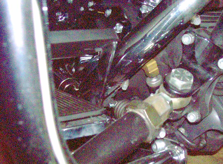

Hi, that sounds correct, it does slant generally forward. I had an issue getting my lower front mount in place but I finally resolved it by removing the oil filter and adapter. By the way, if you remove the oil filter adapter to install the lower front mount, be extremely careful. The bolts appear to be very tight and could possibly break.....
As pointed out by Timo482, the rear brake lever, master cylinder reservoir and master cylinder must be changed in order to clear the lower front mount.
See the attached picture for a general view....sorry about the quality...the picture was rather dark initially.
