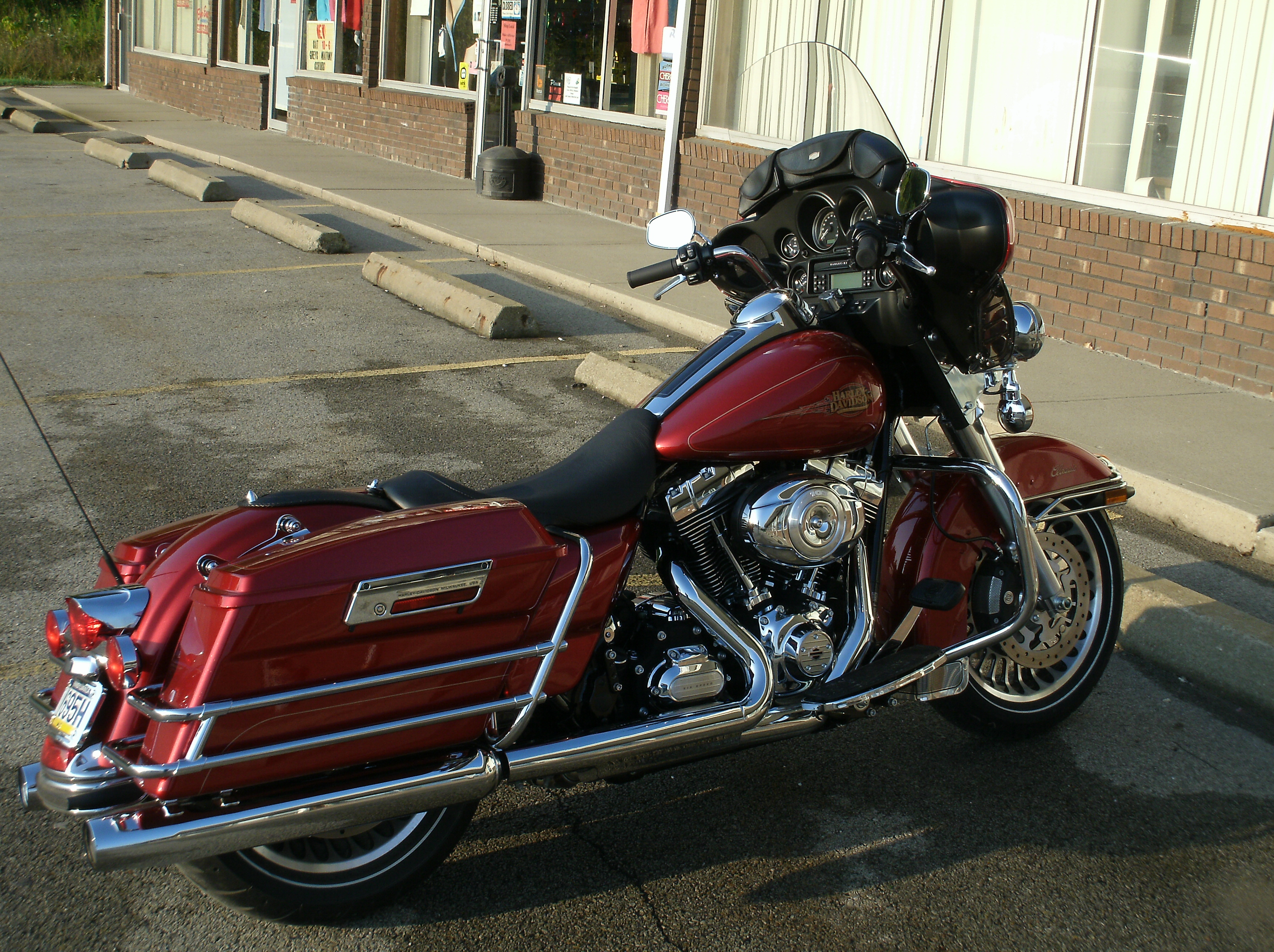

The Y pipe on mine cracked several times in it's 100,000 miles. Both welded and replaced but I guess never reinforced properly. At just over the 100K mark, I had the factory rebuild done and switched to Vance & Hines true dual exhaust. Didn't stick with the V&H slip ons very long though. And if I had it to do over again, I'd go a different route instead of the rebuild as well. But that's 20-20 hindsight and a whole different story.... Still have some old cracked Y pipes on the shelf.

That could be one possibility. The other possibility, as mentioned above, is that the crack is closed when the bike iis cold. When you are underway, depending upon the state of your mufflers (OEM or aftermarket), you won't hear it. The cracks seldom open up very much and typically, they are found when removing the exhaust system for other work, like changing a clutch cable, etc.
The problem mainly shows up on FL's because the muffiers are bolted to mounts behind and below the saddlebags and when the motor vibrates on the mounts (yes, they do vibrate), there is leverage on the "Y" pipe joint so that the metal eventually fatigues. The heat also helps to weaken the metal since the exhaust flame is very hot.
I've also seen the crossover pipe break off where it comes off of the rear cylinder to feed the left-hand muffler. Those can also be welded. The pipes are expensive so any welding is less expensive than a new pipe.
